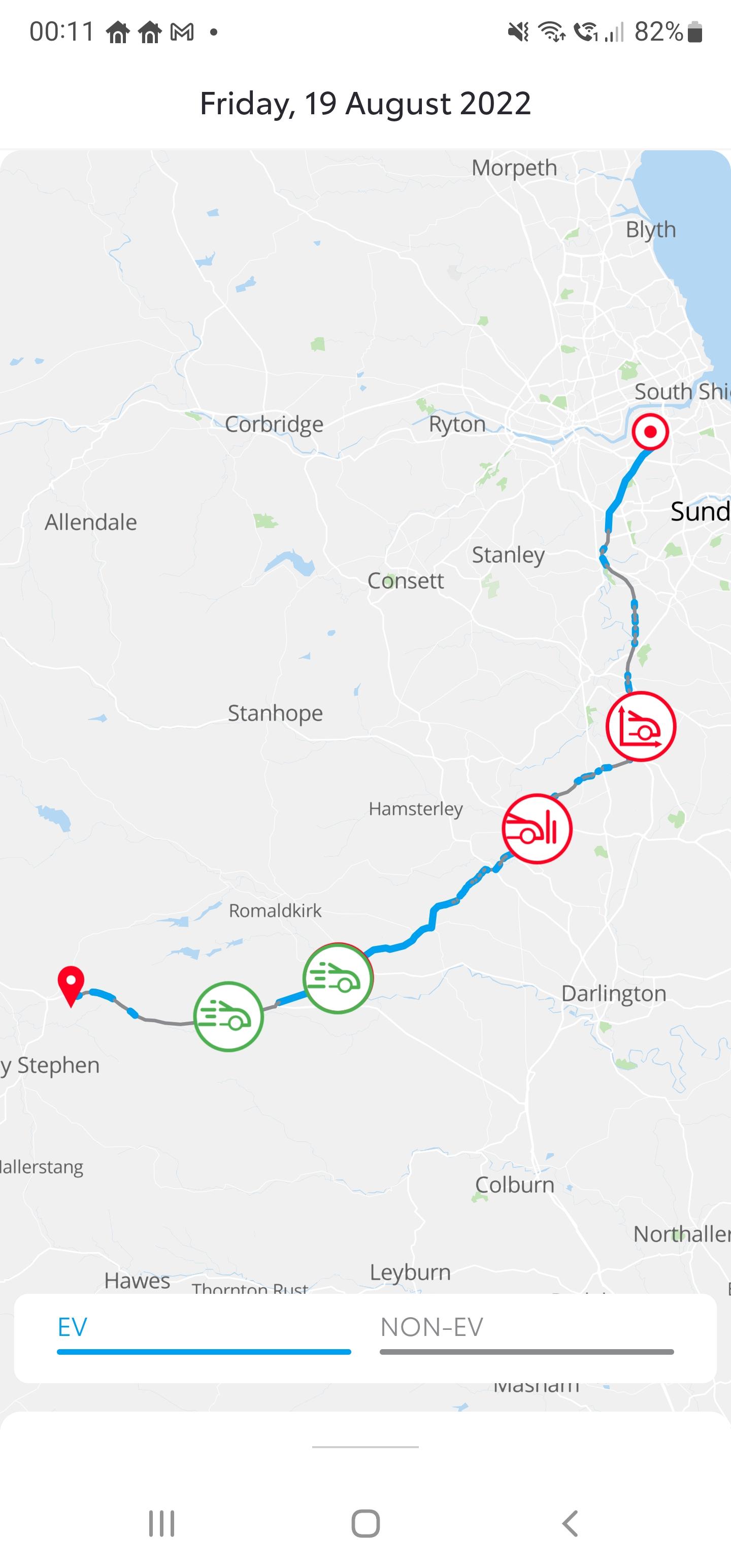

Yep, recurring problem. Given up on using it for business mileage to claim my fuel costs back. Drove from Newcastle back to the North West today and it only recorded as far as Kirkby Stephen. Another 70 miles beyond that weren't recorded.
