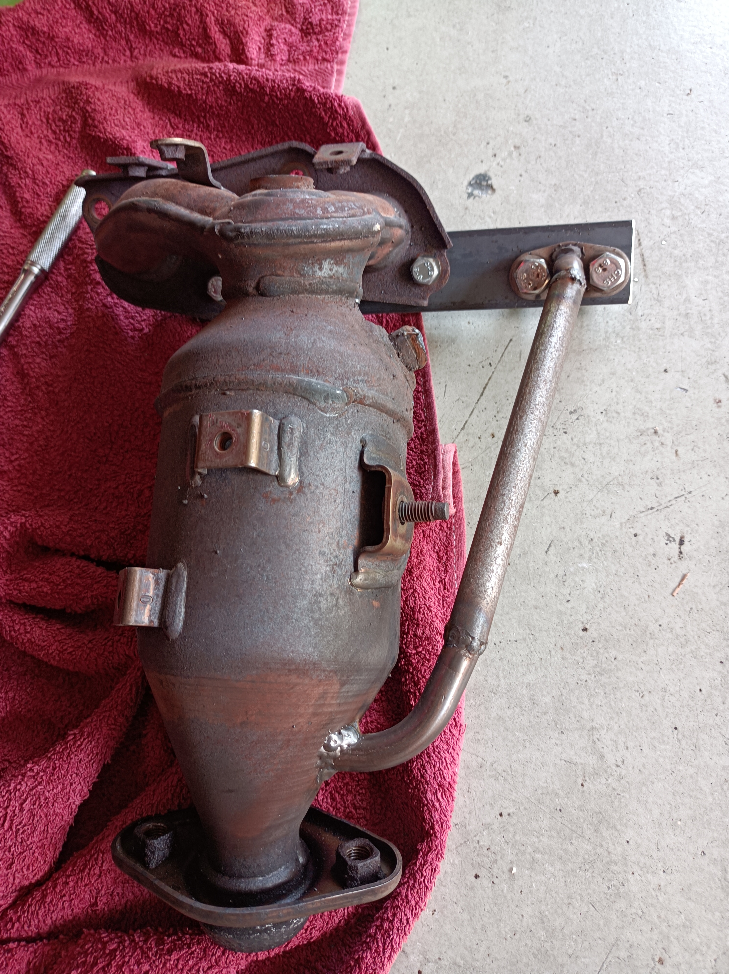

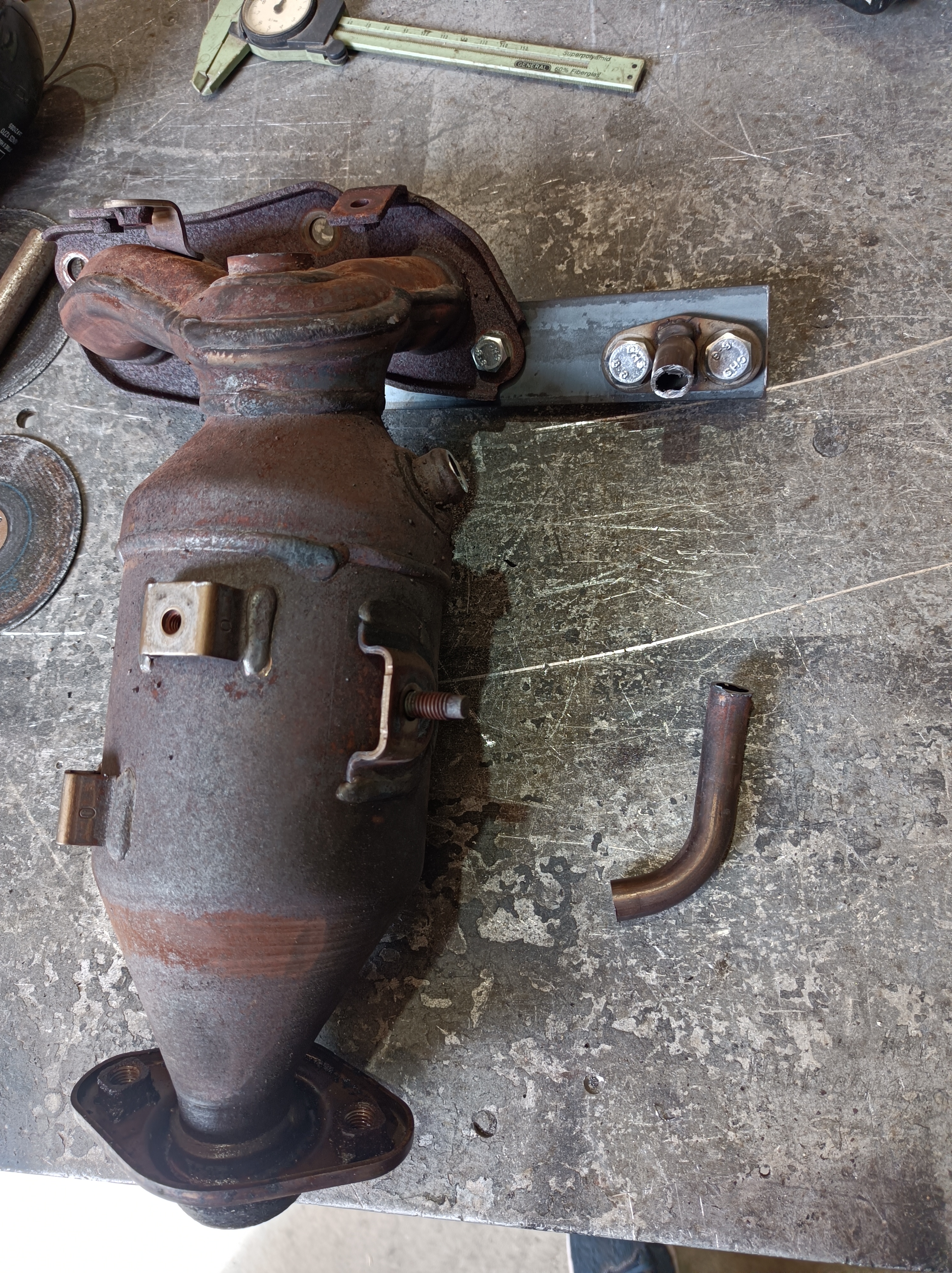

So after a few years of owning my iq and having the dreaded no power issue at low speeds, I have finally got round to modifying the early version pre recall cat converter.
With egr gas now coming from the bottom of the converter instead of the top the car now drives perfectly. That annoying dangerous hesitation is now gone.

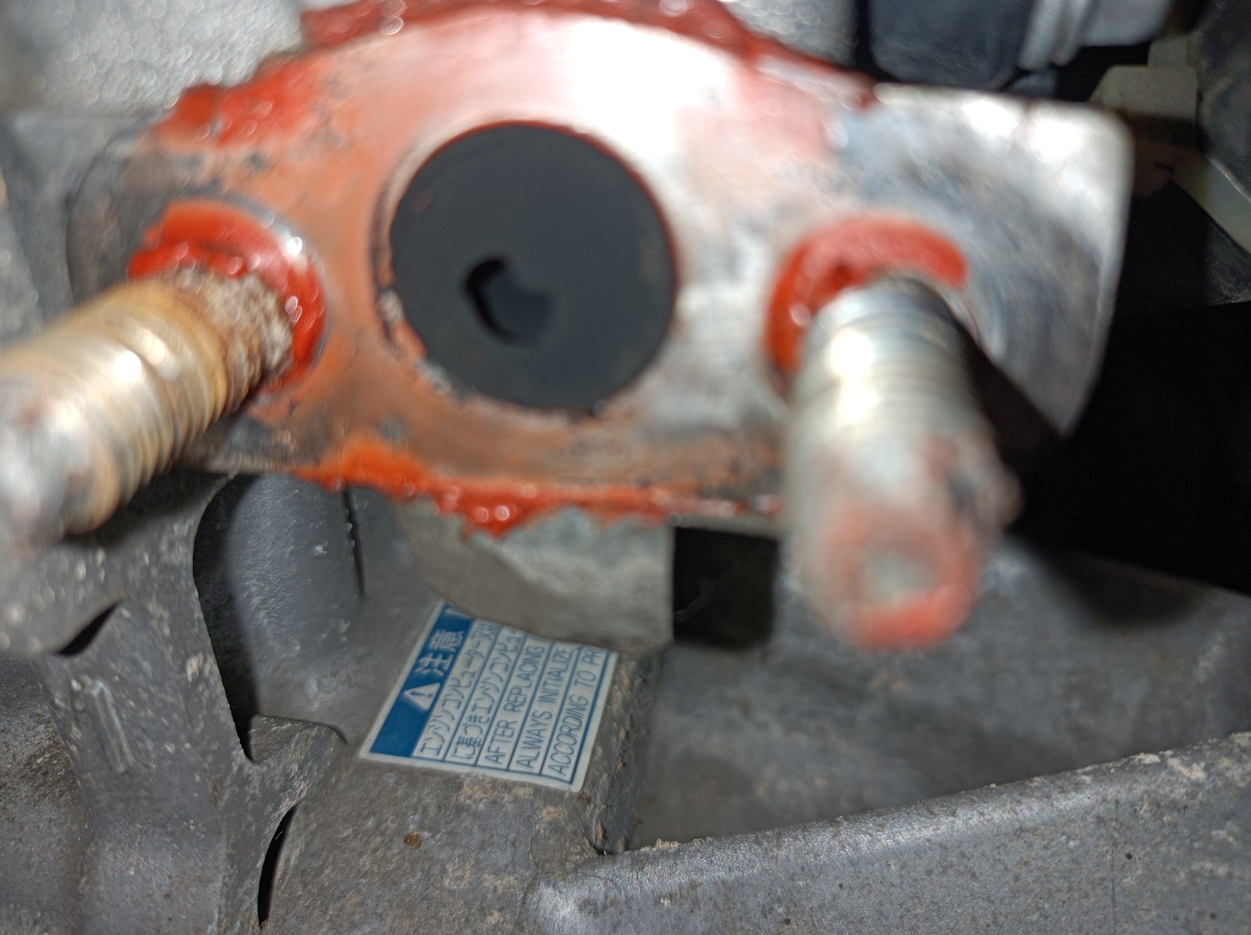

All egr passages and valve were cleaned maybe 12 months ago and upon rechecking are still clear. I also discovered someone had attempted to fix the problem before me, had made there own gasket for the egr pipe and only left a 3mm hole for the gas to pass through.
I would definitely recommend this simple mod for early iq owners.
I also installed a new upstream O2 sensor as on research it is meant to have the same symptoms. But I'm pretty sure the cat was the problem.

Incredibly my litres per 100 kilometres has now dropped from 7ltr to 5.8ltr.
A much happier car
