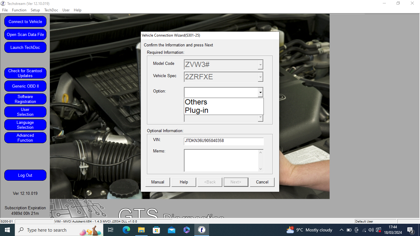

However, I'm wondering if the initial problem is the option when connecting, all versions come up with this initial choice, and I really want one that refers to keyles entry, all I ever get is "other" or "radar cruise"

Are you matching the Model Code and Vehicle Type to match what is on your V5C?
I'll double check, ZVW3 hash is correct, the V5C says ZVW30(H)
The vehicle spec on Texhstream is 2ZRFXE, I dont see that on the V5C, the  version is ZVW30R-AHXEBW(3A) I'll see if I can input that
it is picking up the vin number ok. Thanks for the sugestion

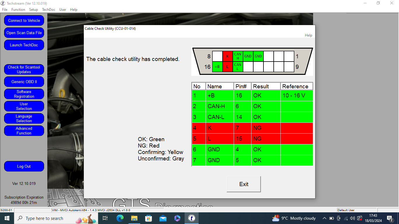

Click on - Help - DLC3 cable check - post the results here

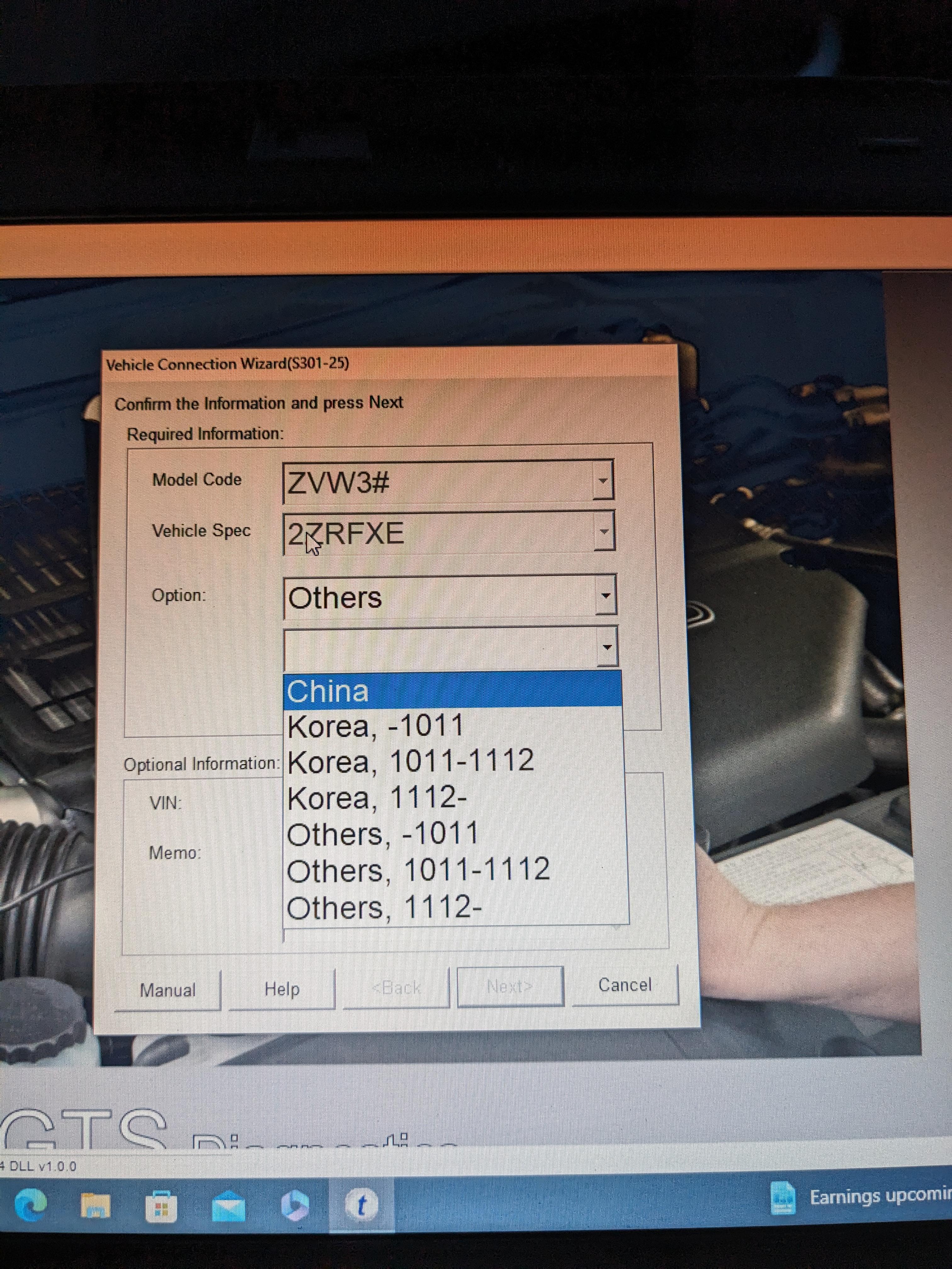

Is it a UK car or a JDM import you need to set the correct region
Click on - Setup - Techstream configuration - select the region, UK - Europe, JDM - Japan

Thank you all who have responded, life got in the way for a while there, but now back on track, and possibly making some progress. My gen3 is definately a UK model, I have run the DLC3 test.
MyVIN starts JTD which Bob says makes it bullt in Czech Republic, I did not know that.

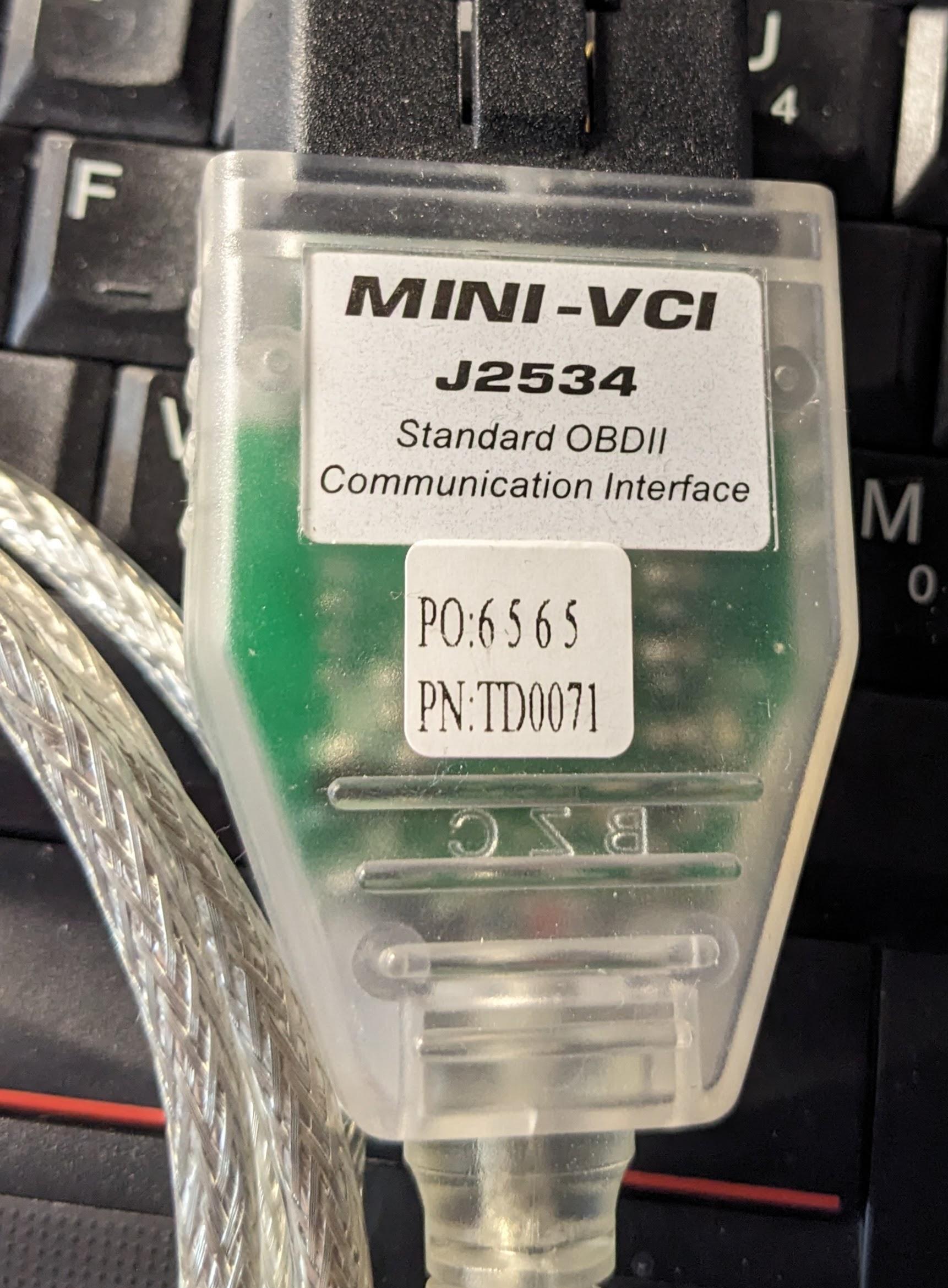

Here's the DLC3 result, again Bob to thank, do I have a problem ? its a fairly old cable
Also pics of the auto and manual conection options, which surely aren't right, but can't change.
