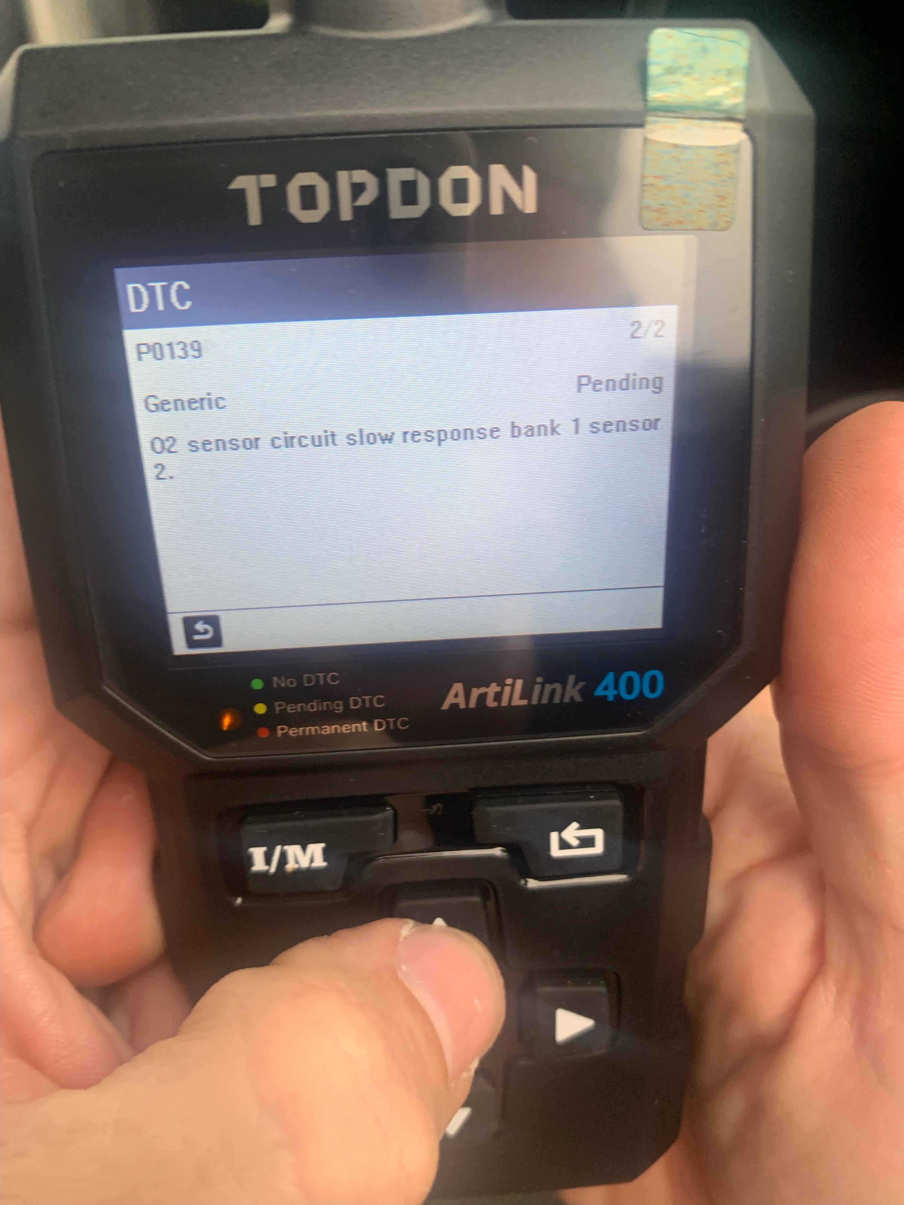

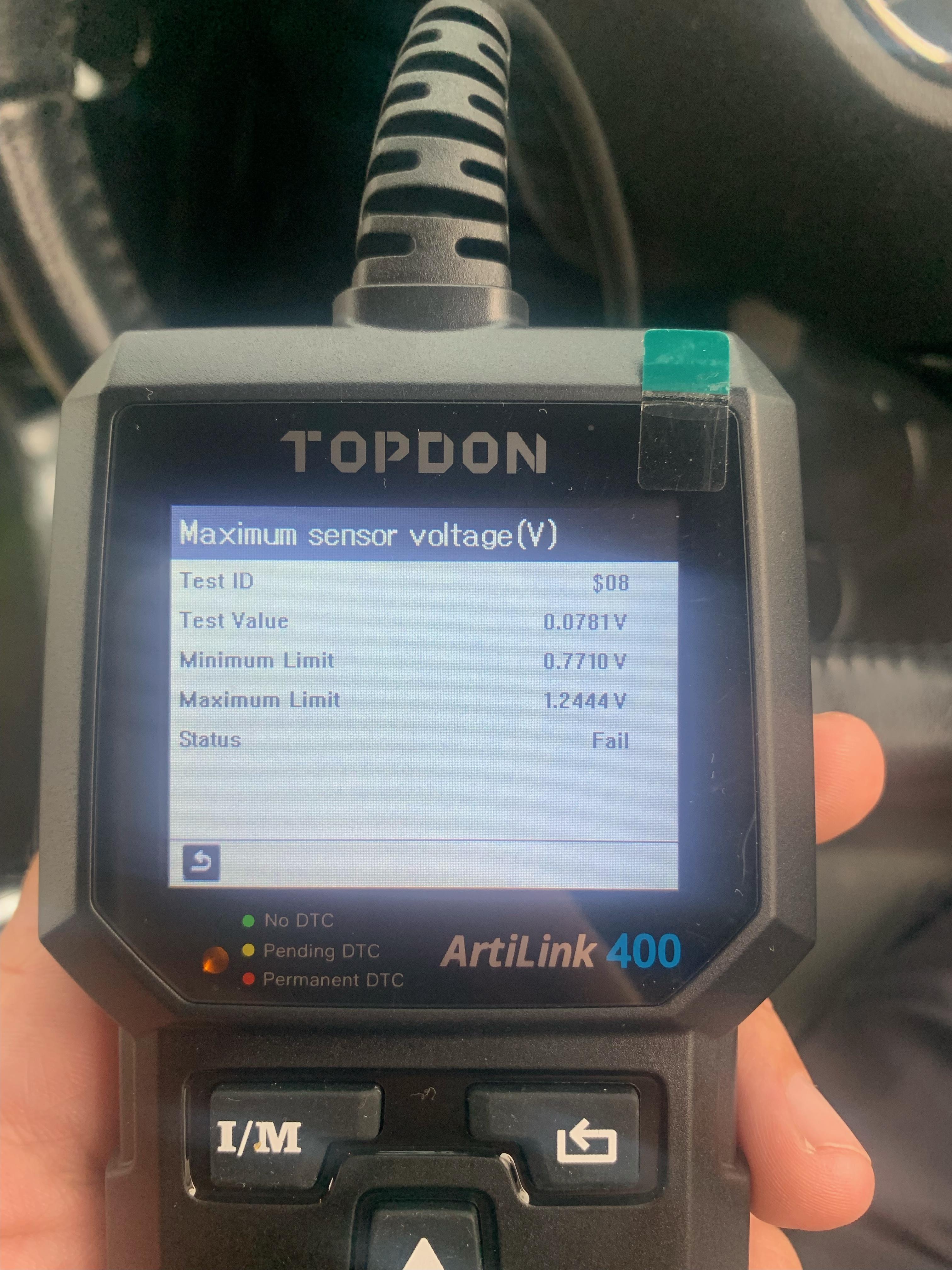

Hi all, my daughters 2018 aygo came up with the engine warning light, traction control and tyre pressure warning lights, after reading it seems it's quite common and that its more than likely an o2 sensor. I have put a diagnostic on it and it has come up with the p0139 o2 sensor slow response bank 1 sensor 2 (post cat). ive read that even buying a good sensor like bosh can still throw up an error. My question is does anybody know what the OEM sensor is as toyota want £165 to supply it if i can find it cheaper all the better

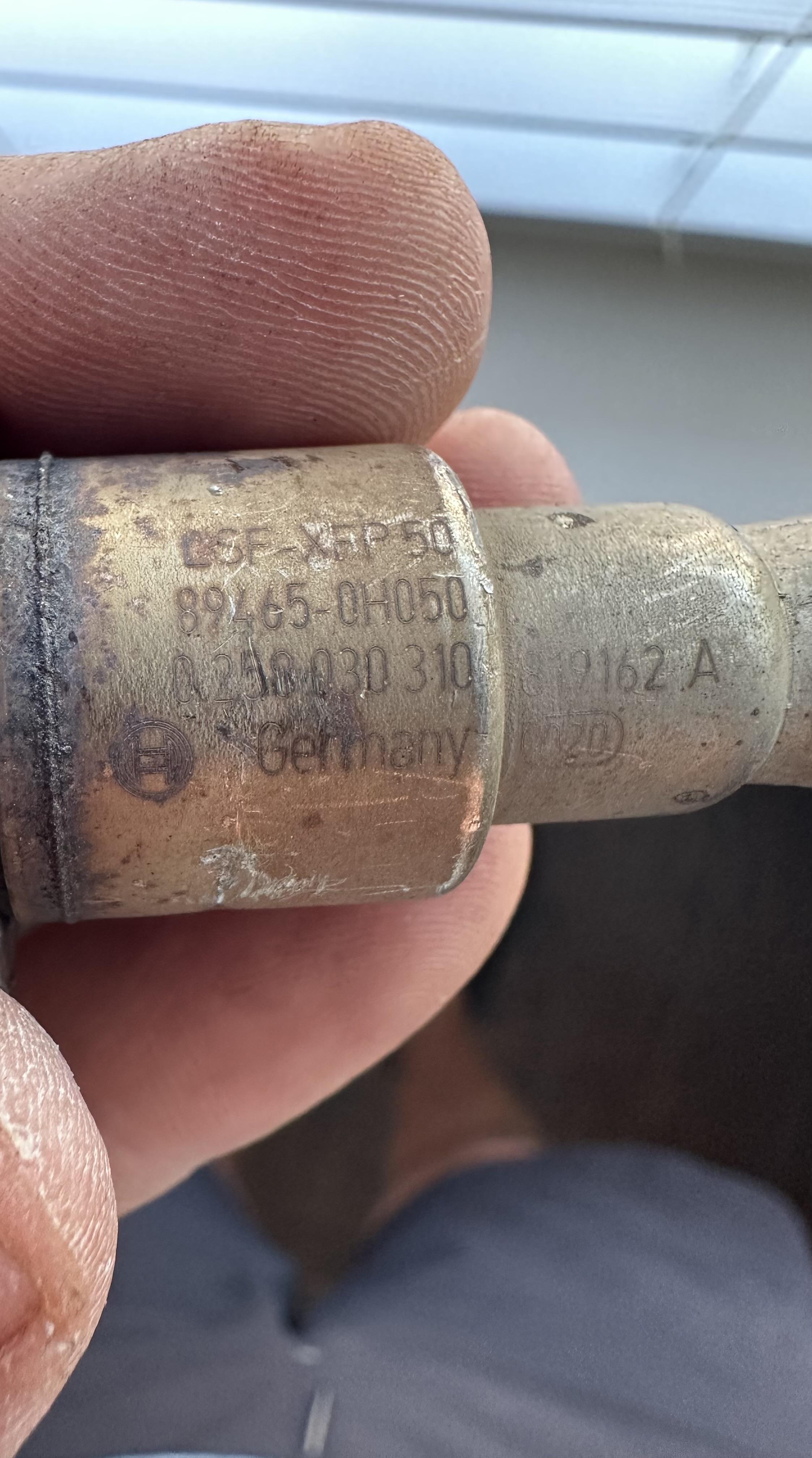

I finally managed to get the thing off, it was stuck. Anyway the number it has in it is 0258 030 310 I wonder if it’s been changed before 🤔
Second line of numbers as i listed above 89465-0H050 that looks to be the original part
Both 0 258 030 310 and 0 258 030 446 cross-reference to Toyota 89465-0H050
0 258 030 310 looks to be the older Bosch part number replaced by 0 258 030 446

My obd wasn't 100% clear, so I'm going pre cat at the moment with fingers crossed. It was a 139 code, I thought that was pre cat?
Mine code was 139 bank 1 sensor 2 (post CAT)
Damn, that'll learn me. Just re-run the obd and that's what mine says. Totally different sensor? Or is it the same? Going to have to find that one now I suppose!!
