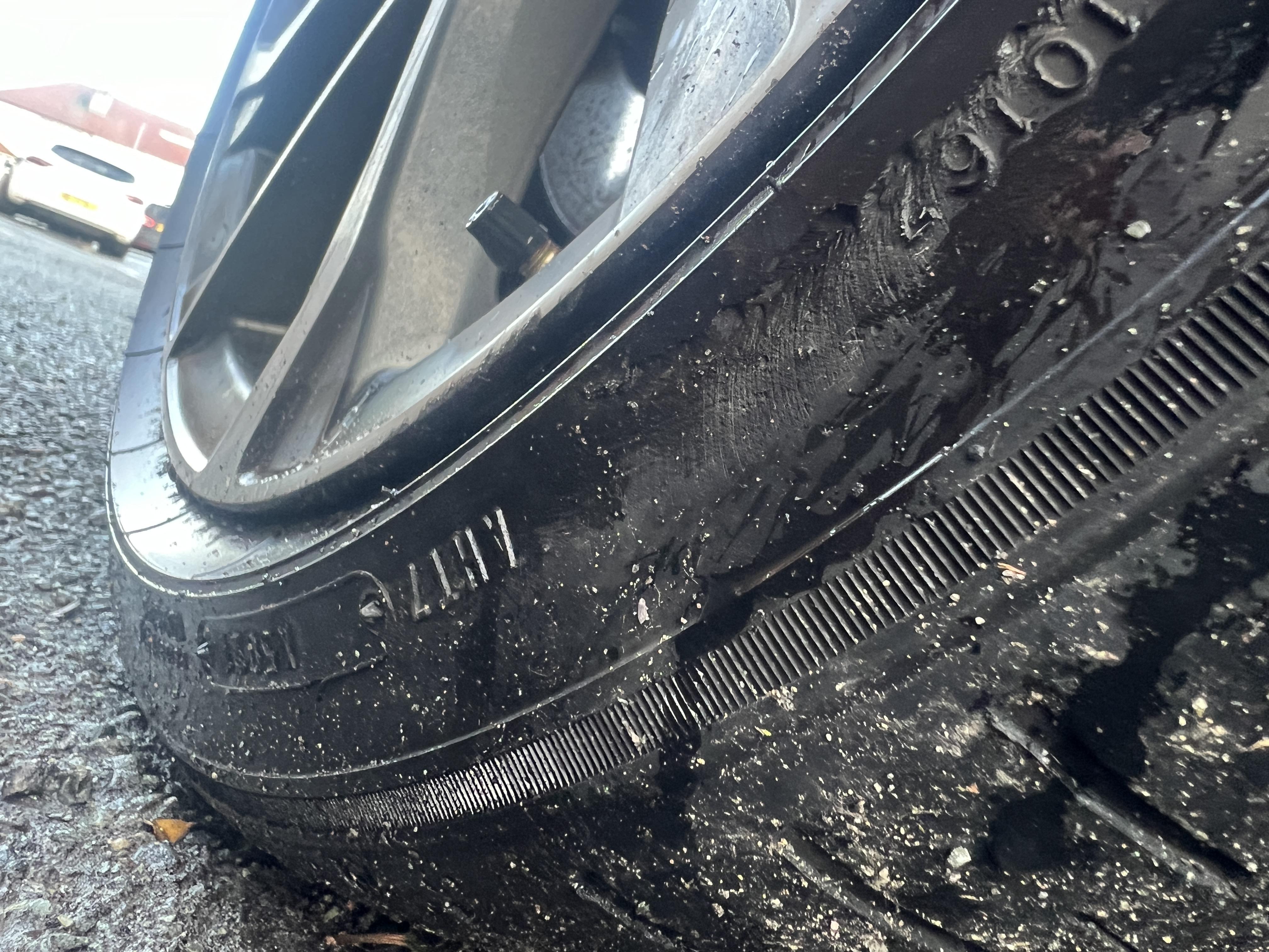

Hi,
I noticed some damage to the side of my tyre. I have kerbed the wheel when more or less got the car, but this damage is further away from the damage in the alloy so likely another occurrence.
I know sidewall damage is a no no and immediate replacement, I’m a little unsure with how much damage is needed. Please see attached photos to assess whether I should replace.
many thanks
If there's gouges or chunks taken out it'll need replacing, but if it's just rubbed/scratched you're probably okay, but keep an eye on it to see if it develops any weird bulges - That would indicate internal structure damage and also require replacement.

Thanks both, there is a chunk out of the ‘rim protector’ bit that pokes out as seen in the image, I’m not sure how much rubber is gone from there to be honest.
have a long journey coming up next week, longer than my 30 min motorway run to work each day, so trying to figure out whether it’s better safe than sorry
