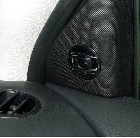

We replace the fronts with some same sized Pioneer Speakers along with separate tweeters mounted  where the wing mirror covers are,  the tweeter wiring was already there in the doors.     Also put some sound deadening pads on the door panel behind the speakers.  When done, it  was quiet a dramatic improvement and never given replacing the rears a second thought after that.

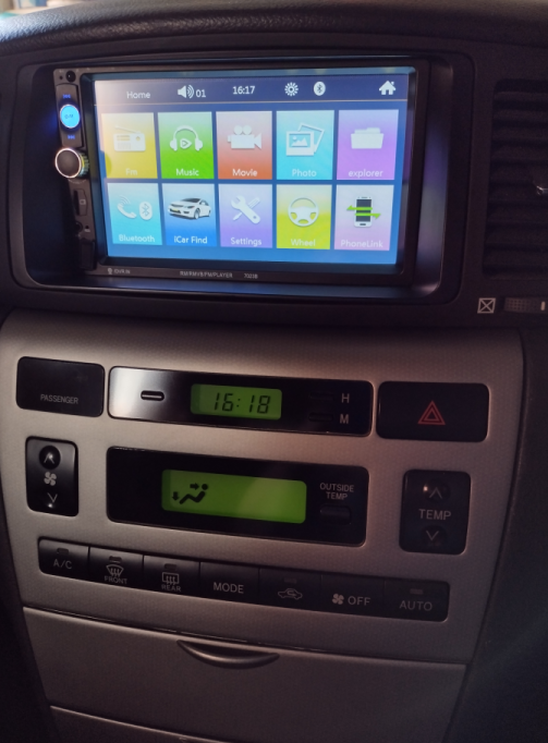

Many say replacing the head unit give a much better sound, but have recently fitted a cheap double din touch screen head unit and  though a slightly different sound it was not an amazing improvement sound wise, still it only cost £25 new  with reversing camera !
000895.thumb.jpg.0a00b3d0bc7fb7bc69cdcb53487c1842.jpgradio.thumb.png.5f365bd87590f72b6dd2bf9898f06db0.png
