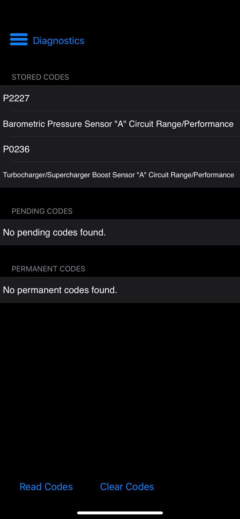

Hy everyone. I have a problem with my Toyota Auris 1,4 D from 2008. I have a check engine light on in the dashboard, with two error codes: P2227 - Barometric Pressure Sensor "A" Circuit Range/Performance and P0236 - Turbocharger/Supercharger Boost Sensor "A" Circuit Range/Performance. I have changed the external sensor but the problem wasn't solved. I took the car to a Toyota Service where they said that I have to change the ECU. Off course I didn't changed it there because of the high prices but I managed to change it but the problem still exists. So I changed also the sensor and also the ECU and the car is still not running well. I checked all the fuses, nothing wrong. Any idea what I can check or do more to solve this problem? Thank you very much!

you will get these 2 codes together if the MAP is not reading correctly as the ecu also reads the MAP sensor to calculate the fuel
