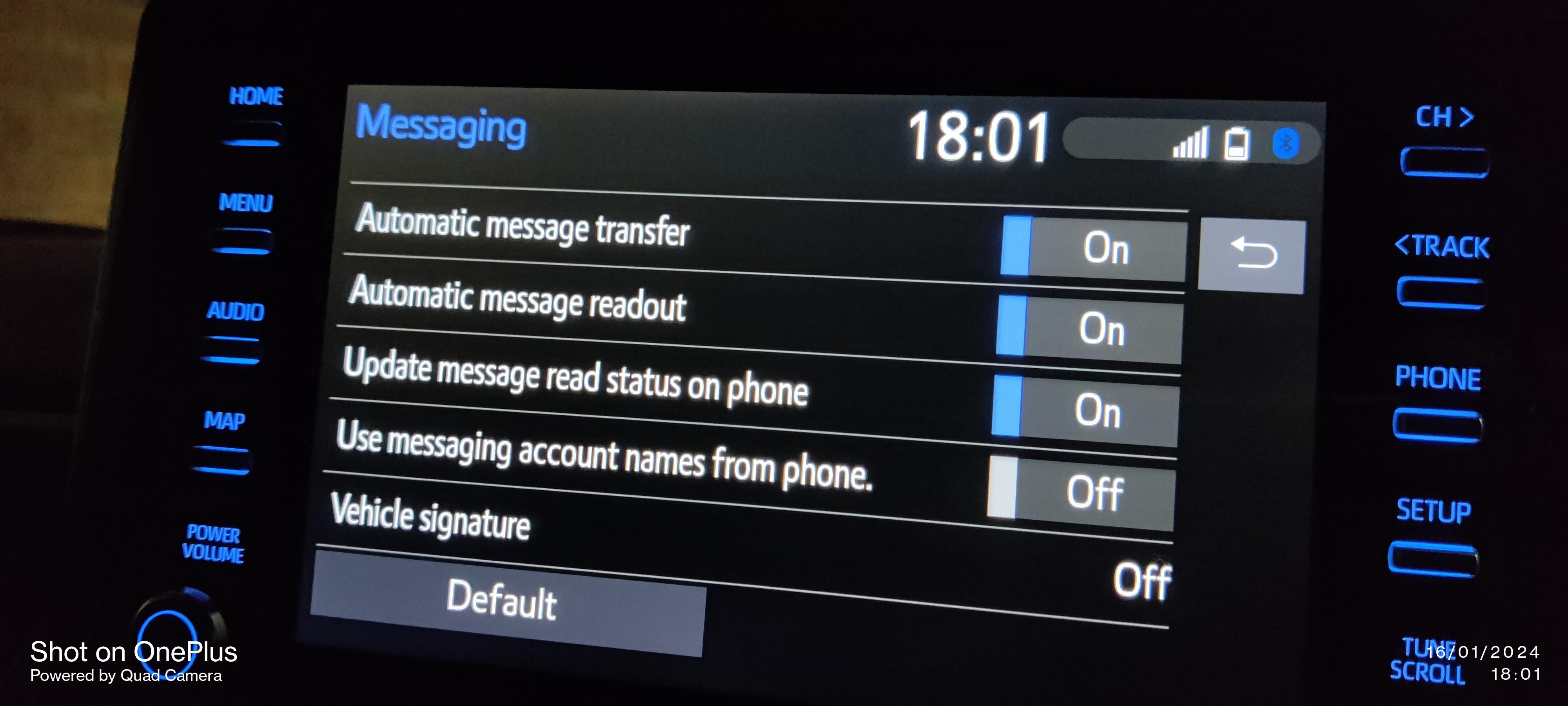

Hi all , just looking through the messaging settings in my car and I'm a bit confused, can I ask ....
Automatic message transfer , is this so when my phone gets a message it's transfered to the Toyota screen ???
Use message account names from phone , should this be turned on ??? Does this let the show a person's name ???
Thanks

To answer both questions I believe yes reading the manual.
