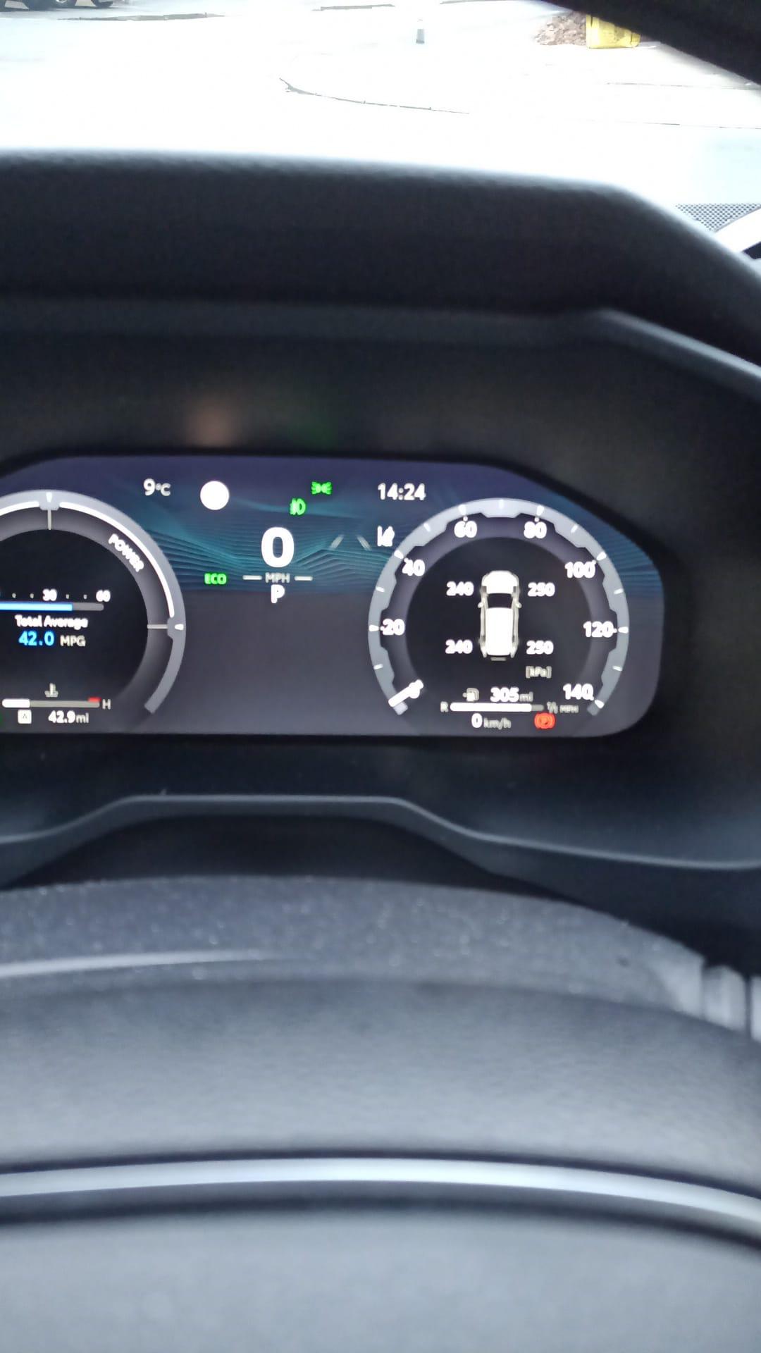

To finally update this thread...I've done it! So odd that after fitting the part that tyre pressure appears as something you can select as a meter and of course it displays it. Very happy with the result, just a shame this isnt something the car actually came with!
Thanks for all the help in giving me the confidence that it works and where to source the part from 🙂
Good effort...  saves all those cold morning checks and makes life just that little bit easier....
I assume that the reasons behind the lack of this as standard is the UK spec cars come from Japan and as such KPA would just create customer complaints...... maybe something totally different.....
