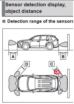

I have read what the user manual says about this.
Maybe I wasn't clear enough (my English is far from good 😉). In this picture is a concrete pillow marked with red. In my case, I can drive extremely close without getting any warning. Especially if there is a turning when driving backward. That was much better on Mazda CX-5. The rear corner sensor should be positioned more to the corner.
Some users have mentioned that the sensor placement could be improved, creating blind spots especially during tight maneuvers when turning while reversing. You can always ask your local dealer if any adjustments are possible to that corner sensor.:smile:
