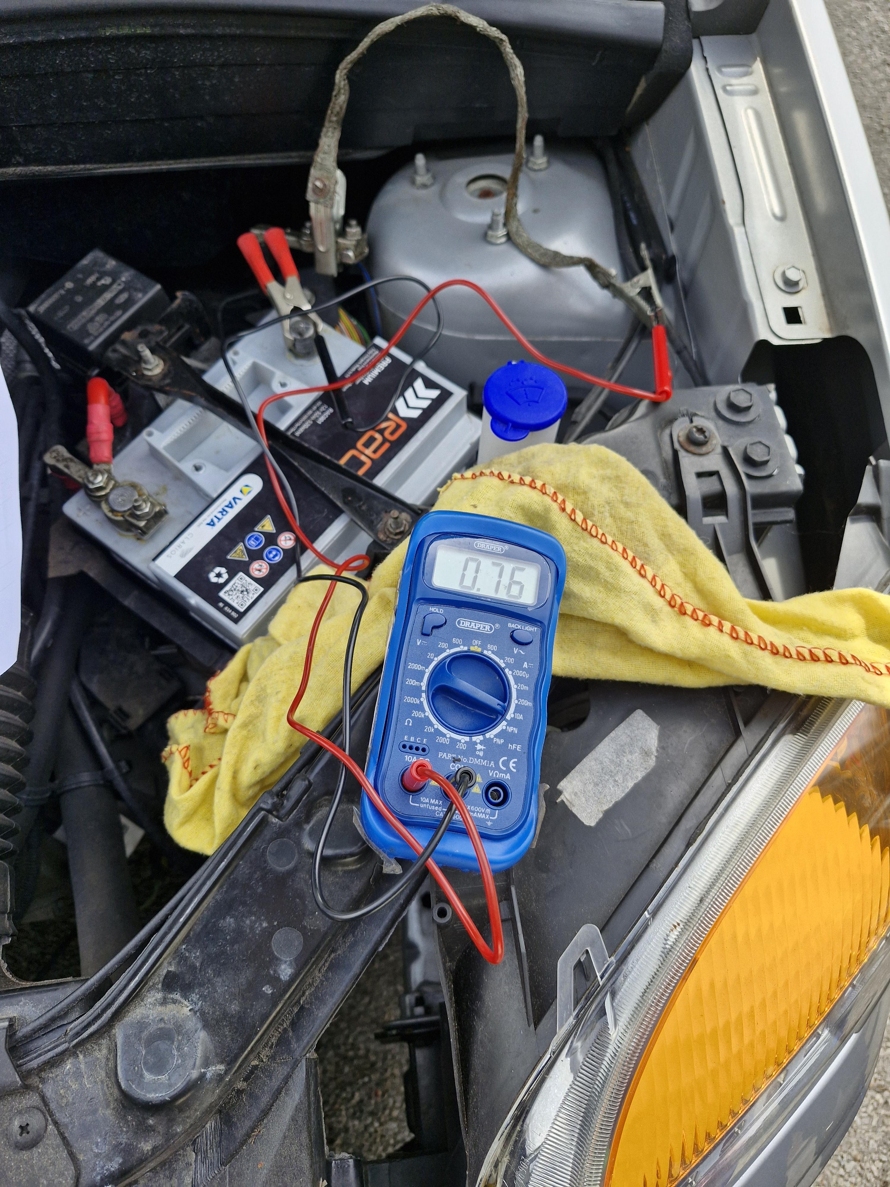

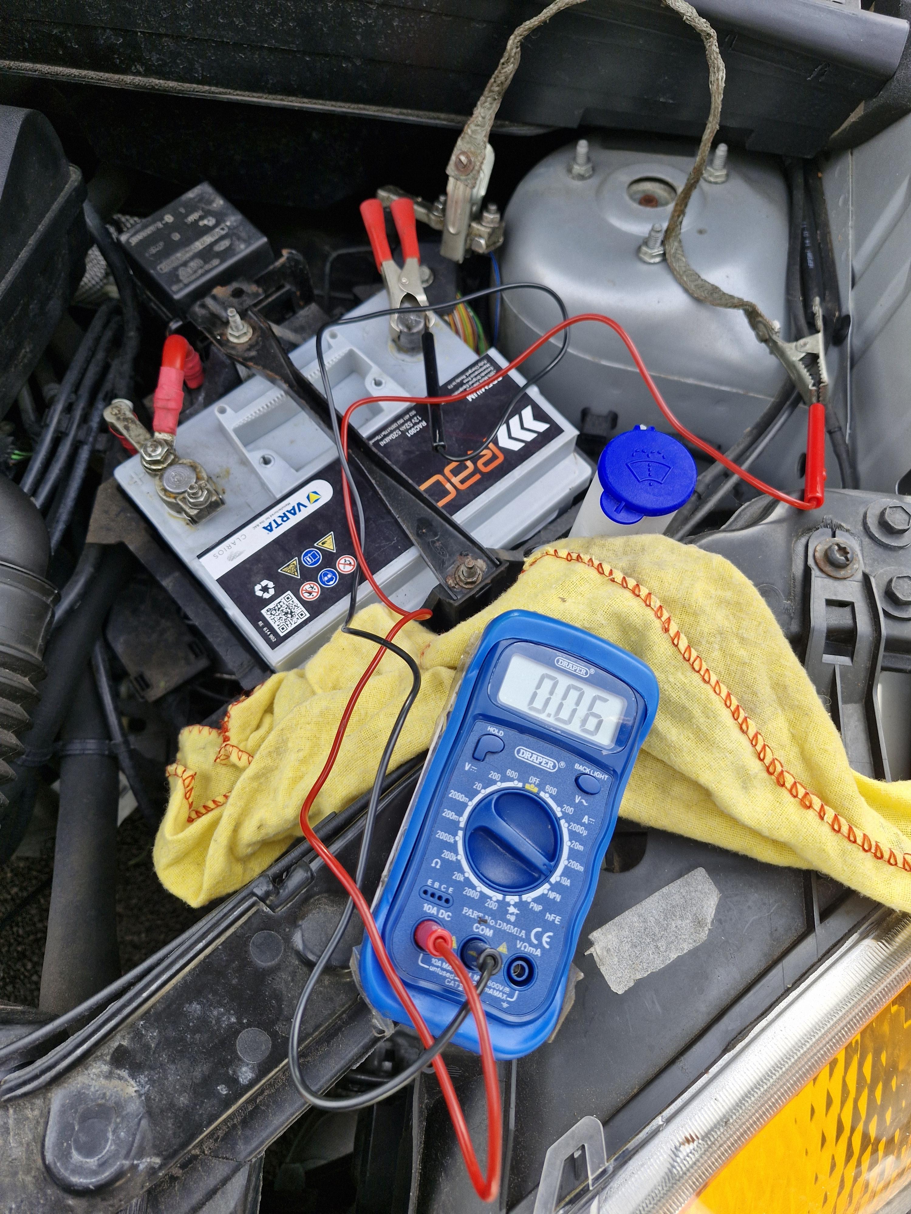

I did what I should have done at the start and rigged my multi-meter up to look for fine margins (please see pictures). I noticed straight away that there was nearly an amp draining with nothing on (0.78a). I am no auto electrician, but around 0.10 to 0.20a I would expect? Took fuses out one by one and the amp big drop was the radio (after factoring in the memory, so did it a few times). With that fuse out, reading went down to a more normal 0.06a. Since this discovery I have now read loads of articles online about the 6000CD (and similar) Ford radios draining batteries through a progressive internal fault (linked to the muting system apparently).
So my advice, to avoid the delays I had is identify the precise source first.  If anyone is interested in how I rigged my multi meter up, as long as you have a fairly decent one (mine's a Draper one, about £40-50) and some crocodile clips 2 of which have a 12v wire in between, take the Red lead out of its normal socket on the multi-meter and pop it into the 10a DC socket. Turn the multi meter dial to  the 10a setting. Undo you negative terminal clamp and take it off the battery. Attach one of the croc clips to the battery clamp (disconnected from the battery) with the other croc clip (with the wire in between) attach to the Red MM lead exposed end. Put the exposed part of the black lead of the MM to the negative battery terminal (use a spare croc clip) and this will then run through your MM what is going into your car from your Battery. You can play around then removing fuses and relays one by one until you get a drop in the readings on the MM. That's likely then to be your issue. It was with me.
