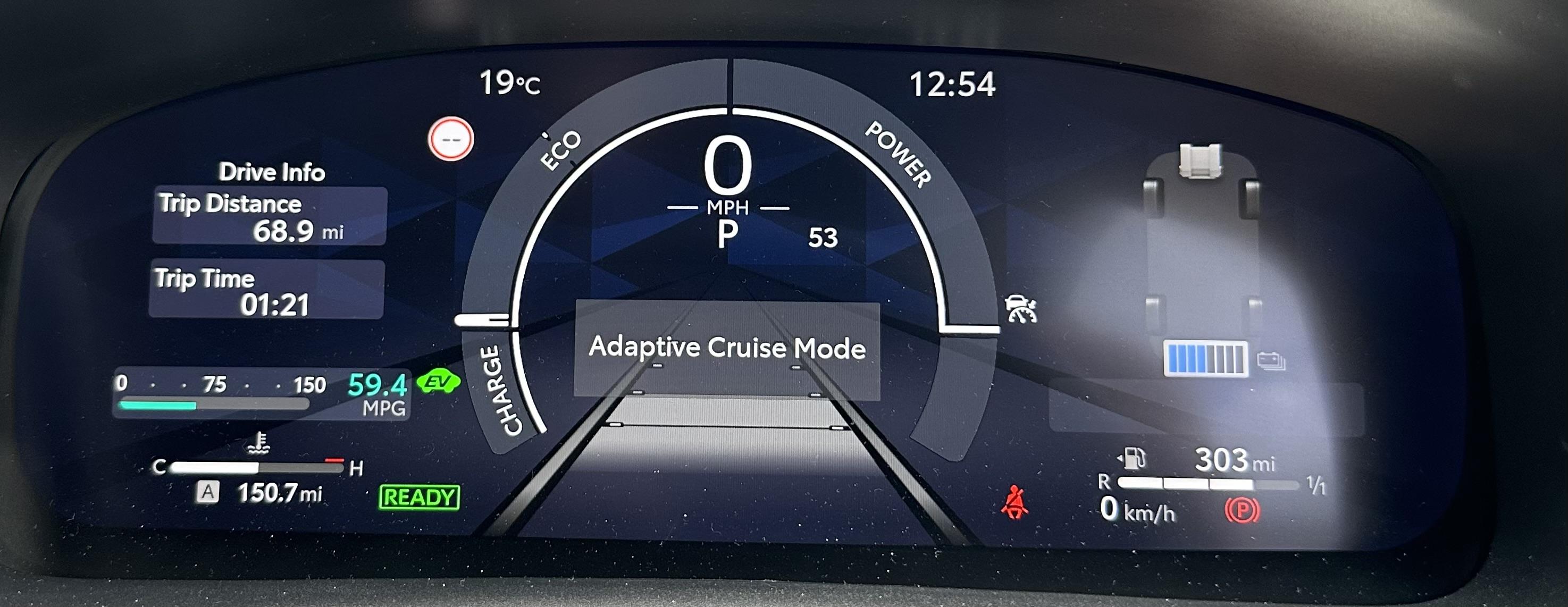

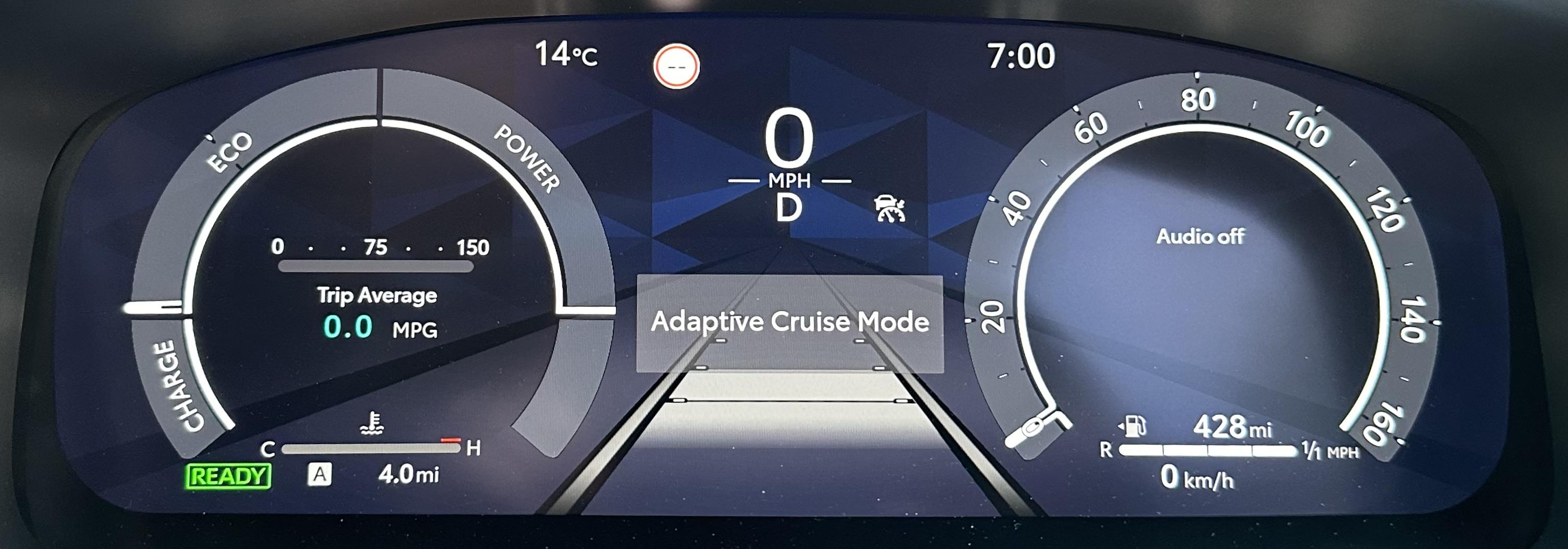

on my car I have the drcc display as the large one in the centre of the dash, so I can see what it has detected and what’s working.
I haven't worked out, yet, how far ahead the system detects a vehicle in front.  I don't think it is much more than about 100m.  Probably depends upon conditions and the size of the 'target' too.
I have opted for the single dial setup with the drcc display on the right where it is clear and uncluttered.

I switch between the one dial and two dial setup, but leave the drcc display in the middle as the map option is so small.
it would be nice if we could have a decent map in the centre of the screen like VW/etc.
I started with the two dial display, pretty much as it was delivered, but have settled with one dial, 'smart' appearance, with the dial showing the hybrid indicator as you have.    I don't think that I ever look at an analogue speedo on cars that have a digital version.   I would usually want the tacho displayed but I figured that there wasn't much point on a car that doesn't have any fixed gears.
I agree about the map.   Pressing 'OK' makes it slightly bigger but it still isn't much use.   So I leave 'Settings' in the centre display because it requires less button presses to get to the things that I like to switch off or modify before driving!   I have the adaptive cruise display on the right where you have the energy monitor.
I generally leave the map showing on the large central screen but I have it set up so that I can switch to the energy monitor with one button press.   I don't take much notice of it, because it doesn't actually change how I drive the car, but it amuses passengers!
