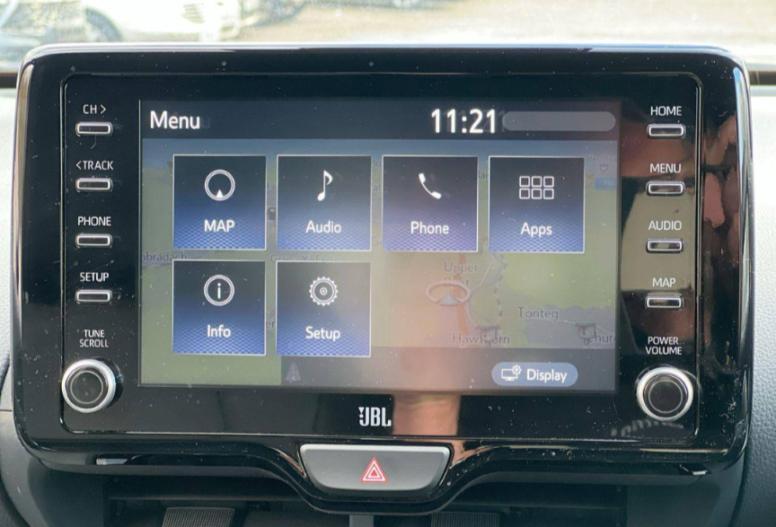

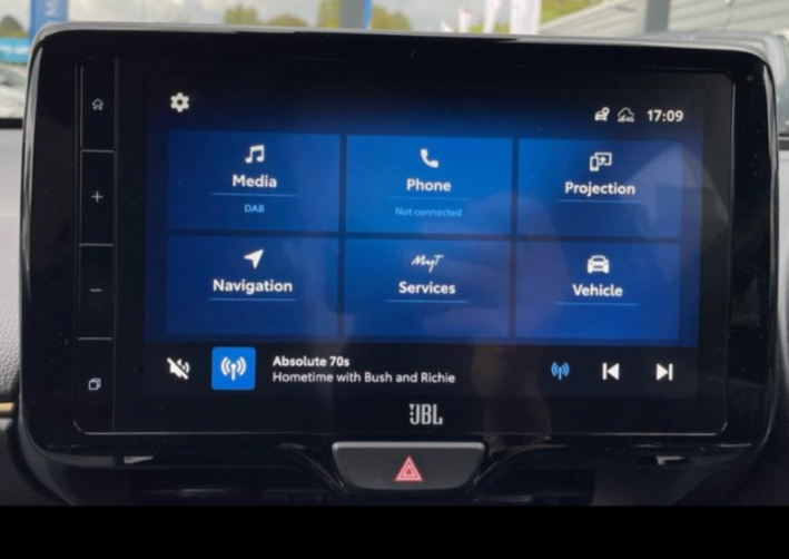

Show us the picture of your multimedia unit

The screen with physical buttons down either side or the one with the soft keys down the left side ?
These systems can be a bit flaky and throw a wobbly.  If you are saying you had wireless connection before, I'd suggest totally unpairing your phone and setting it up again.
Go to settings (cog icon, upper left corner) and from there find your paired phones. Each phone has a dropdown (arrow on the right) where you have music, Phone and Android Auto options enabled/disabled for the device. Usually the phone no longer connects if it reconnected just to use music and/or calls. Enabling AA from there should reconnect it properly. Sorry if I missed some settings or names, I don't have my Yaris nearby.
