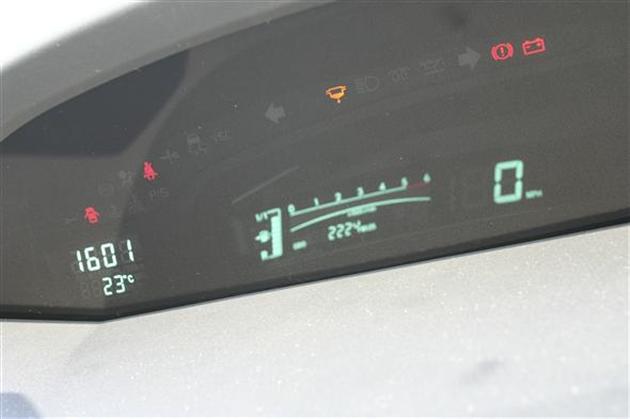

As far as I can find out the switch from miles to km is done at the dealer with a 'box of tricks' that plugs into the under dash connector, I will have a play with mine later to see if I can change it and report back.
The colour is the green/blue of a GFD (Gas flourescent display) like the older type of digital clock (showing my age now!)
Also the display is 'handed' with a different layout for RHD and LHD (it is angled toward the driver){from what I can see of the unit the display is generated below and reflected by a mirror to be viewed, it looks further away than it isdue to the reflection}
So in a UK one (RHD) if viewed from the left seat you don't see the fuel gague or most of the rev counter! (just ask my partner, I say fuel is low she tries to see and ends up on my lap{thats another story!!})

The switch from miles to Km is done by the driver pressing the button adjacent to the display.
It really is that easy.................read your handbook :thumbsup:

Ah yes, only the speed changes, I had confused myself as I was thinking of the cruise info and odo which stay in miles..... silly me!

Something that I have mentioned on another forum (www.yarisworld.com/forums/) where I also posted detailed photos, you should be looking at a mainland Europe country to source the instrument cluster and not the UK or Republic of Ireland.
You need to get an instrument cluster that is designed to be viewed from the left seat and not the right as the viewing angle and position of displays & warning indicators are different.
I suggest trying to find someone in The Netherlands, as that country has a high number of English Speakers.
post-14667-1163163308_thumb.jpghere is a photo of a U.K New Yaris speedo
