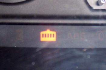

I have a strange warning light that looks a bit like some of the monuments in athens. Its just below the fuel gauge but isnt the low fuel warning light as this is situated right beside the fuel gauge itself. All help and advice appreciated.

Just grabbed my owners manual and it says:
Radiator level warning (Diesel vehicles only)
This light will show if the coolant level of the secondary radiator tank is less than the specified level. Check the coolant level immediately.
Hope this helps
