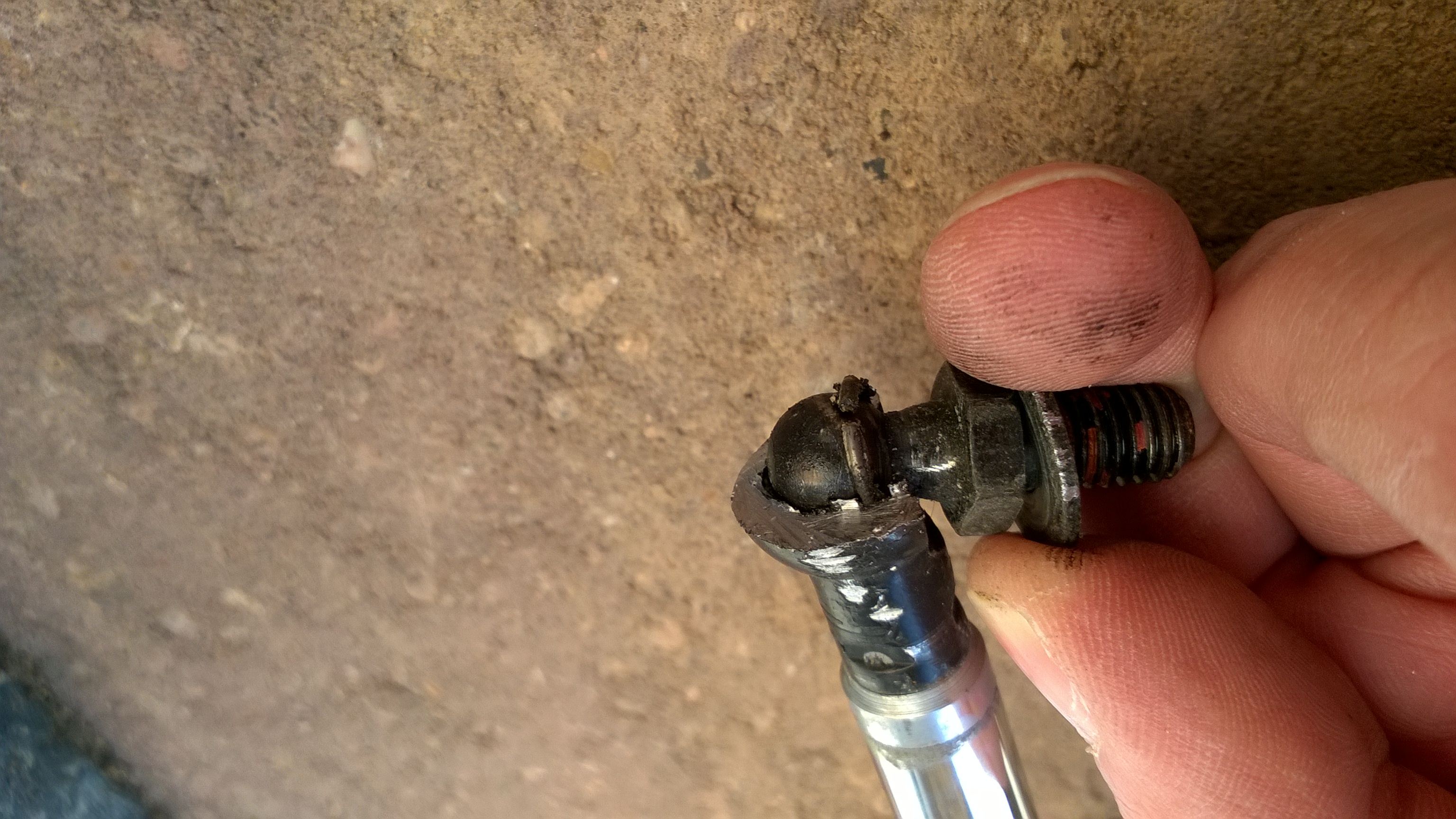

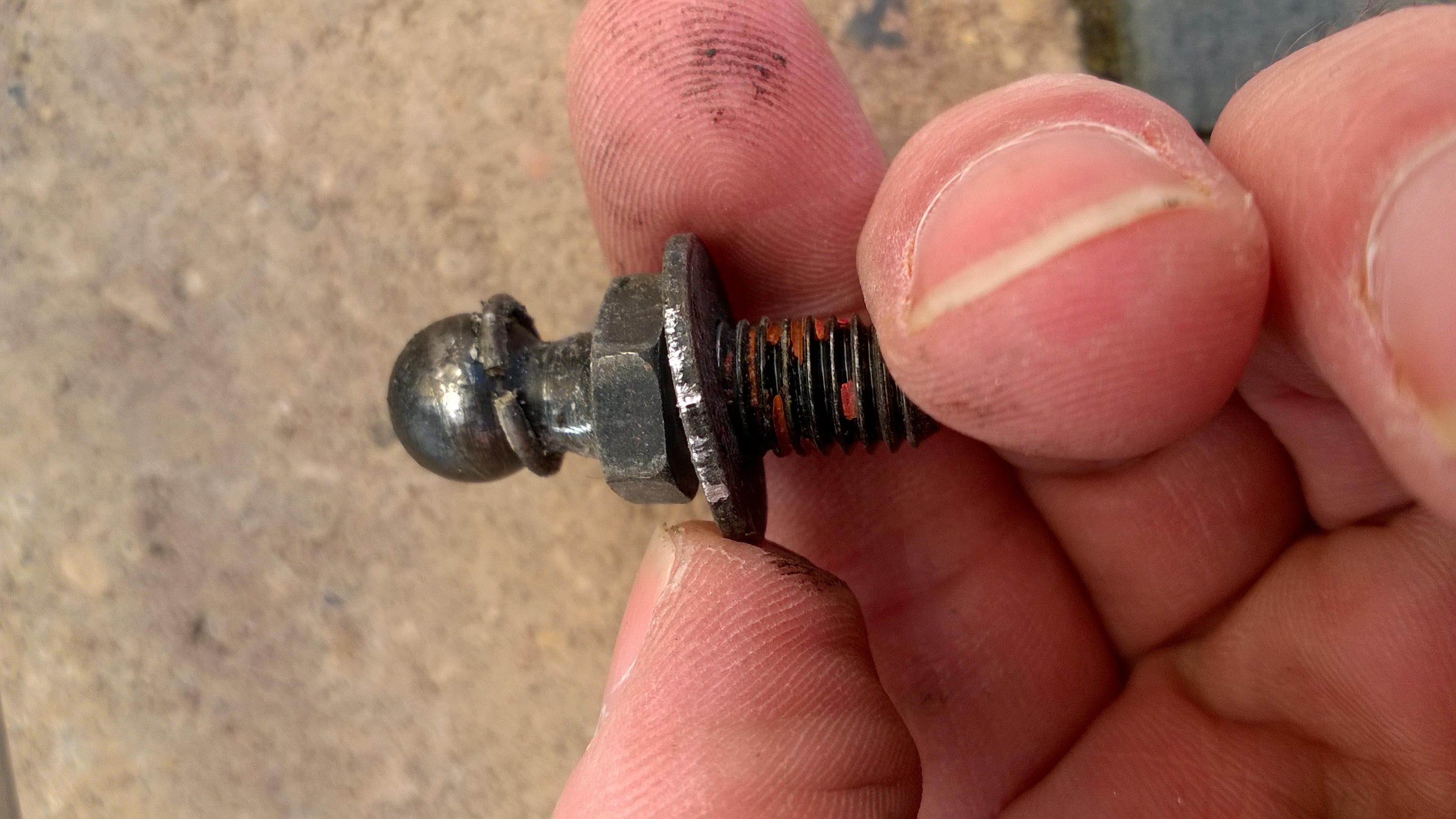

Anyway, I got new struts from sgs, but they don't come with ball joints. I hacksawed the cups in half to get the ball out. It turns out they have a circlip in which holds the ball in - see attached images. I don't think there is any non-destructive way to get them out. I certainly don't imagine a hammer being able to do it.

I'm just trying to change my wife's Celica and can't remove the top bolts! I tried the 'hammer method' to separate the bolt from the joint, but it didn't budge - at least I now know why, thanks to you pictures!

Just looking at that ball joint with the circlip and wondering whether it could be separated by using one of those ball joint separator tools that look like a tapered tuning fork. Trouble is they're usually made for separating steering joints which are much bigger but surely someone makes a smaller version. Maybe you could use two sharply tapered steel wedges, one from either end,  closing them together with a G clamp failing that see if you can get an oversized carpet tack lifter to force it off!
