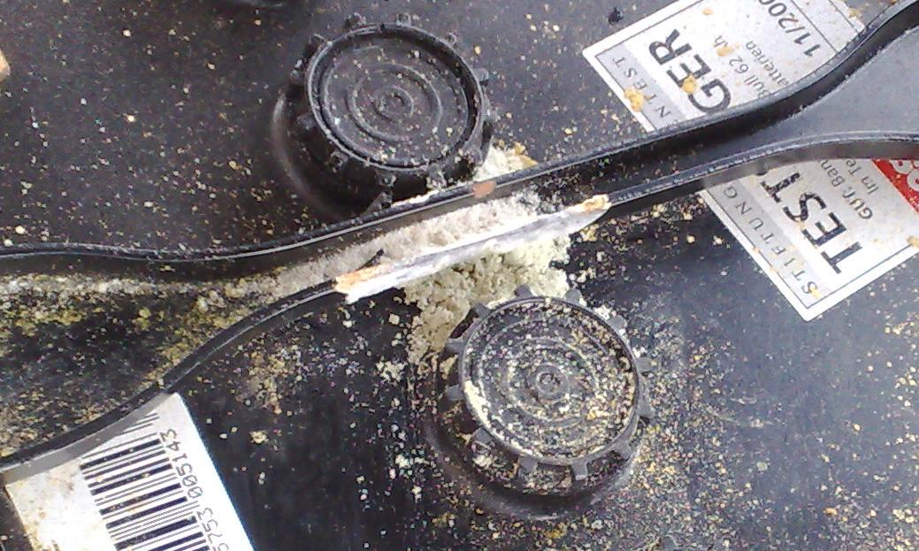

This is a shot of the top of my Battery, with something powdery accumilating on the top, and my Battery isn't lasting over a day now lol, can ~I fix the Battery or shud I just take the easier route of replacing it, i've also been told that Toyota may well be cheaper than Halfrauds anyway...?
If the Battery is older than 3 years and not holding its charge then it is probably time to get a new one. Even if you can top up the water level you will be diluting the acid in there even more than is has been over its 3 year life. A Battery that does not hold its charge will make the alternator work harder to try and keep the charge level up. So what you end up with is a dead Battery and the need for a new alternator.
If you have a garage you could put an external charger on the battery overnight, so you have a full charge when you start up in the morning, but you are just putting off the inevitable need to get a new battery.
This is a shot of the top of my battery, with something powdery accumilating on the top, and my battery isn't lasting over a day now lol, can ~I fix the battery or shud I just take the easier route of replacing it, i've also been told that Toyota may well be cheaper than Halfrauds anyway...?
You can clean of the gunk with boiling water and baking soda, wear safety glasses as it is acidic.
Clean all the contacts back to bright metal, tighten up and then coat all the contacts with Vaseline or grease but if this does not help then a new Battery is called for :( , short journeys kill the cell by causing local action (A continuation of current flow within a Battery cell when there is no external load) which in turn prevents charging.

My local costco I think is also your local Costco, have no card tho, lol, I got one from toyota for £58.38 inc VAT yesterday, means I can't take my girly out 2moro nite now tho :(
