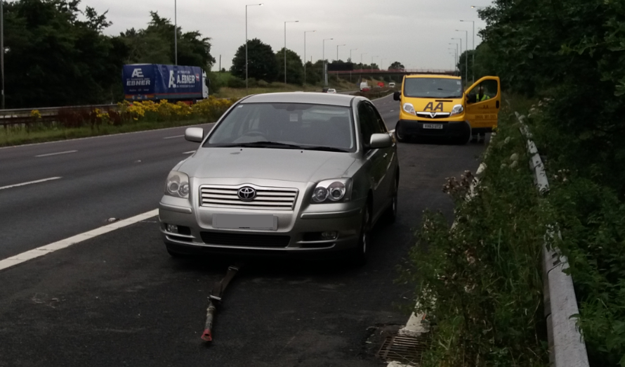

The inevitable happened last week when the engine completely and utterly shat itself on the M6. Not a good day. No testament for the perceived Toyota reliability.
How long is an engine change going to take me and how complicated is it? Extent of my mechanics include changing shockers, replacing brake pads and an alternator, and ultimately, is it worth it?
