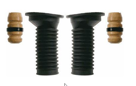

You might also want to get some new rubber covers and bump stops to protect them.
