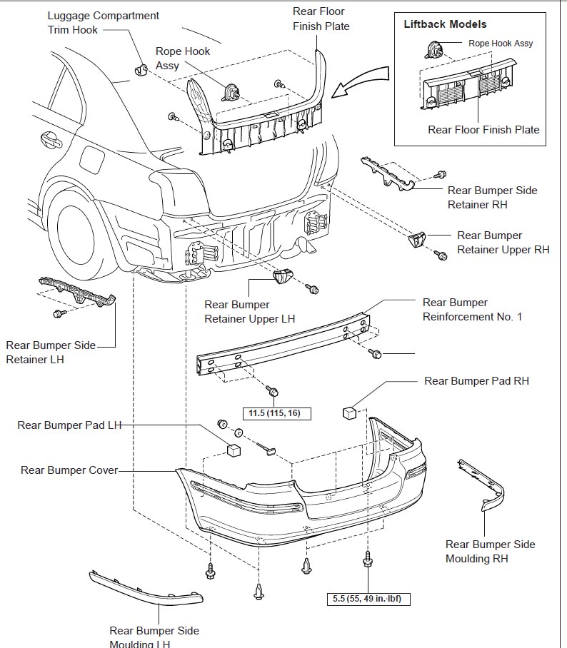

Hi mate this exploded picture of the complete bumper and fixings should help post-74463-1251742492_thumb.jpg ;)
