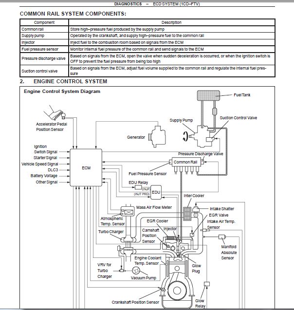

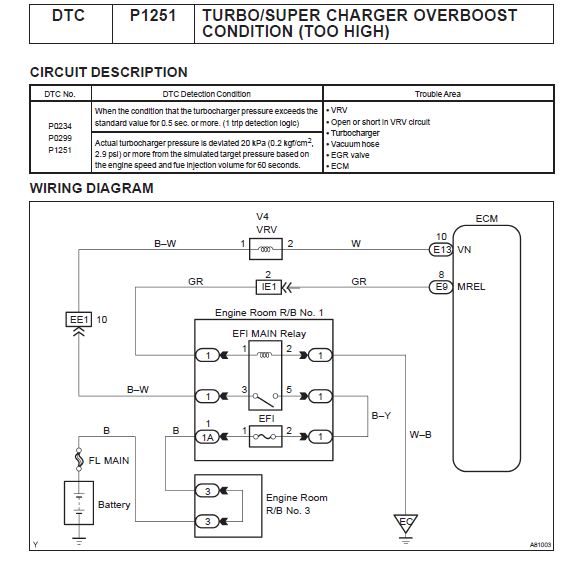

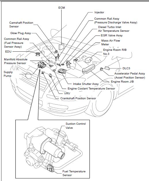

Hi mate, some info on you problems hope you are getting closer to sorting it.
Pete.
