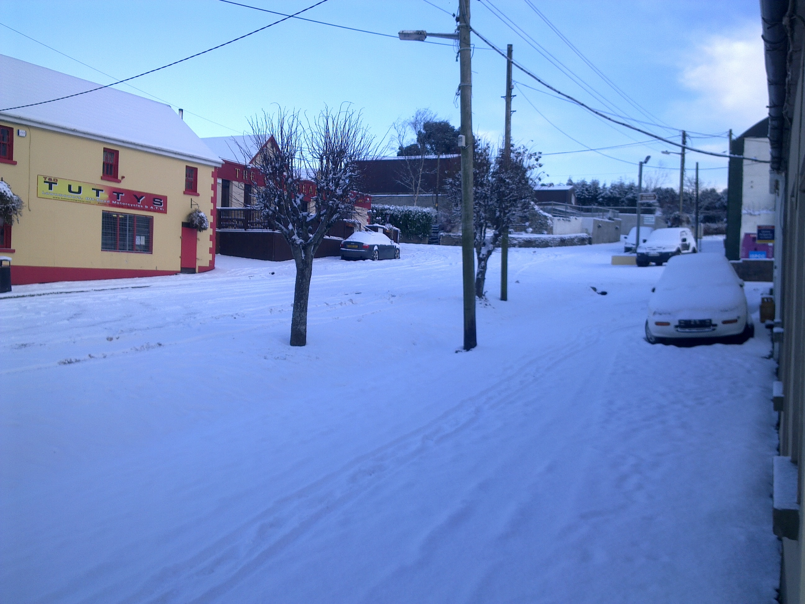

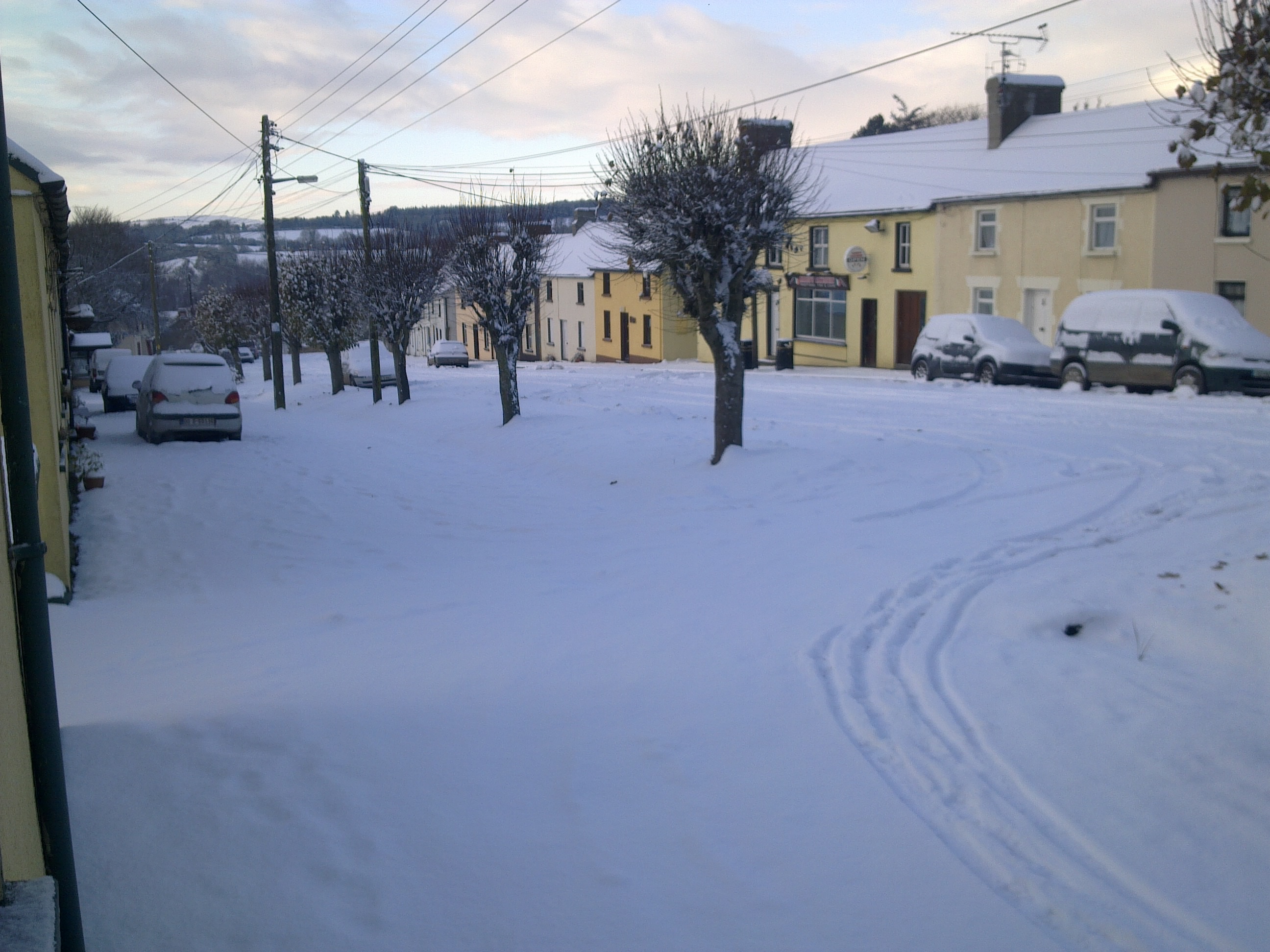

In the village where I live, when I leave my drive, if I turn right I am going up a fairly steep hill.
If I turn left, I go down this steep hill to a bridge over a river, only to ascend up a slightly steeper hill the far side.
Basically, I am stuck between a slippy and a slidey place. The road has about 2" of ice topped off with the compacted snow of last night's 4" of snowfall.
I am only 4 miles from a treated main road, but I cannot leave my house as I cannot get up the hill to my right. I tried yesterday and only managed to creep about 50 yards before the traction control stopped all power to the drive wheels. It's no use turning left, 'cos then I'll be stuck on the bridge going nowhere.

I'll try and attach a couple of pics to show what I am up against.
Thanks.
post-95299-009389000 1291040943_thumb.jp
Pic no 2...
post-95299-068932300 1291041191_thumb.jp

So basically you're stuck until after the weekend? What are you complaining about?! Get yourself into that pub across the road - it looks magnificent!
And in the second picture there's a chip shop! I really don't see what all the fuss is about.
Yep, you're right. Pub and a chip shop.
