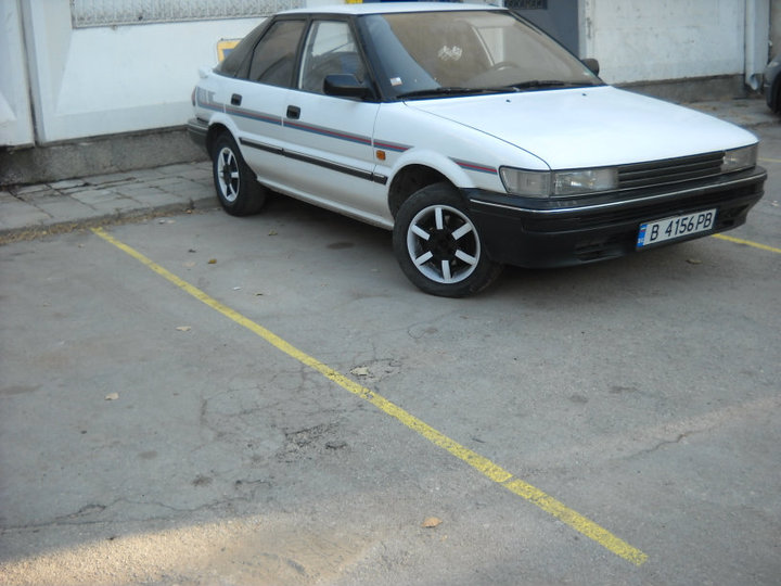

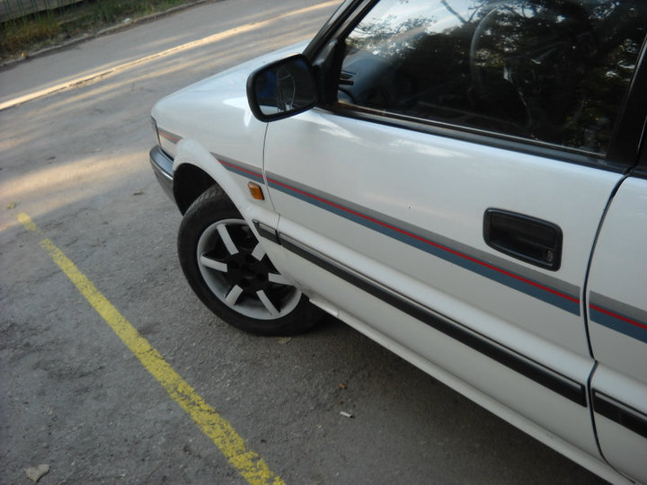

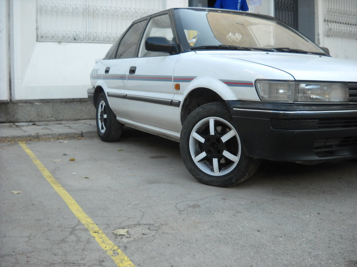

So here are some pictures of my CoYota, I don't really have a lot of pictures but I'm planning to do some bodywork and stuff when I save some money and I'll make more pictures.
post-113416-0-25211400-1327417132_thumb.post-113416-0-43773200-1327417120_thumb.post-113416-0-77726900-1327417126_thumb.

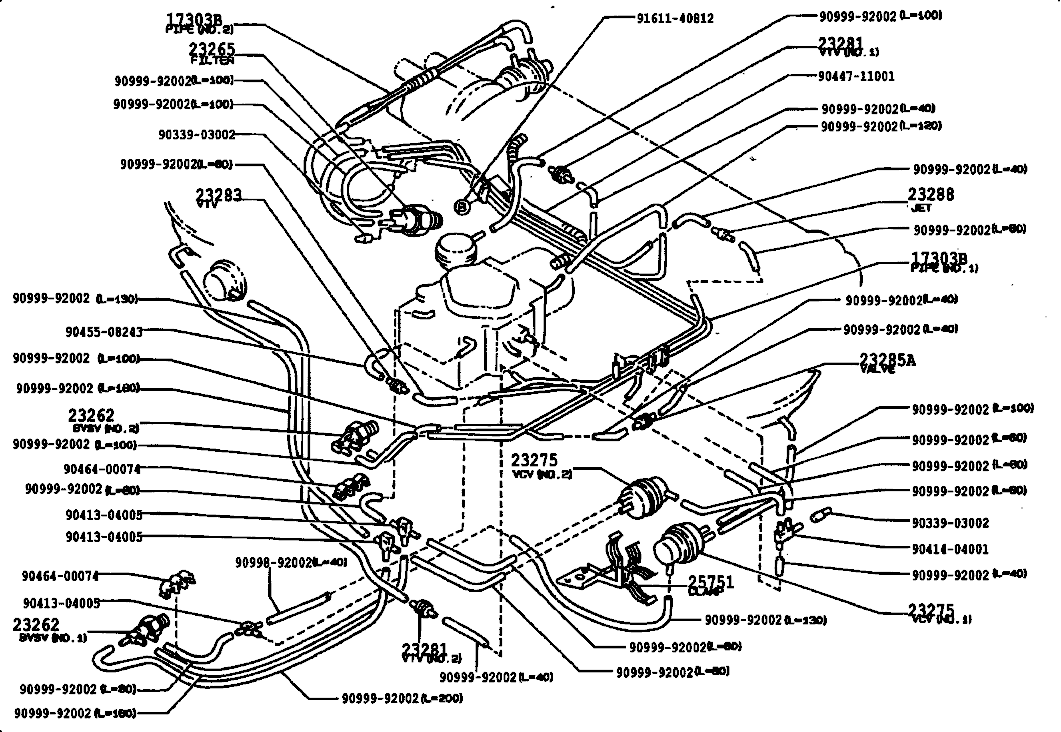

Hey guys :) Today I've started checking the vacuum hoses (GREAT WEATHER) but there are two diagrams that I have for the 2E engine and ofc the complicated one was for mine piping.. The problem now is that there is a cluster of pipes which I can't follow on the diagram and I'm 100% sure that some hoses are mixed up and others are not connected.. So I'll attach the diagram here and it'll be great if you can help me resolve it somehow.. If you have a simple diagram where the cluster is shown closely I'll be very grateful.. And again the engine is 2E carb from 1987.. Thanks in advance!
post-113416-0-83191900-1332275850_thumb.

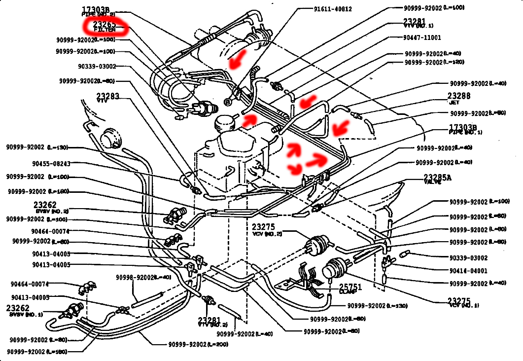

Okey.. So I've followed the lines and everything goes well until I get to the FILTER which I have highlighted on the attached image.. There are some pipes that are bypassed.. And I can't see which pipe goes where on the diagram.. Right now I'm drawing myself a diagram which I can use but this pipe cluster is a life mystery :D I'll continue my work when I have time because I'm on twelve hours shifts and I can't be with my car :(
post-113416-0-89615600-1332592211_thumb.
