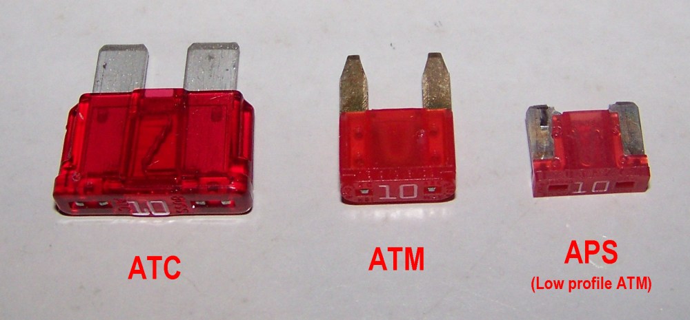

After using compressor in lighter socket, i blew the 15 amp micro fuse. Does anyone know where to buy other than dealer? local motor factor and Halford's (there's a surprise!) do not stock this type. They look unique to Toyota
Dont want to trail over to nearest dealer to get if at all possible

Attached is a picture showing the 3 most common automotive fuses. Toyota is using the smallest low profile type, which can be hard to find. You can use the ATM in its place, the only problem is it sticks up higher which may prevent the fuse box cover from fitting properly.
Look in the fuse box or boxes under the bonnet. Toyota often provides at least 3 spare fuses, usually off to the side of the box, as well as a small white fuse puller. Look under the fuse box cover for a legend showing where the spares are located. Also, you can sometimes pull a spare from an unused circuit. For example, my RAV4 has fuses in the sunroof, RSE (rear seat entertainment), and de-icer slots, even though my vehicle didn't come with those options.

Thanks for response, our local Halfords did not have in but are stocked at Rugby
I had long leg ones in garage but wont fit under cover, the puller is in engine compartment fuse box , with spares(all but 15 amp im afraid)

Thanks all picked up today ( she can have her satnav working again so alls well :D )

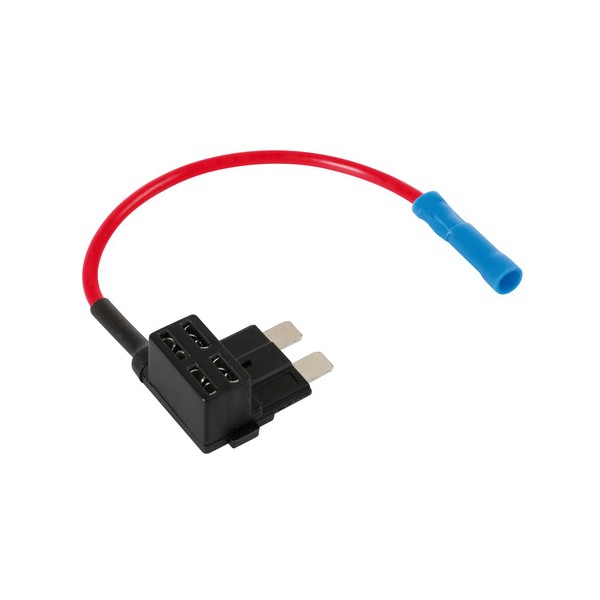

Hi guys,
if i want use this "ruba-corrente" for the bluetooth kit i can use the APS type?
Or it's too small in depth?
Is it better use the ATM type though i can't fit the cover?
Do you use it?
Thanks and bye, Luca.
