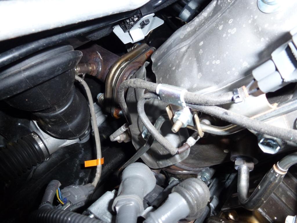

If you look down the back of the engine you can see the cat. If there is a DPF you will see several pipes that come up to a valve on a bracket on the engine near the steering column end. These pipes measure the pressure on each side of the DPF and will initiate a cleaning purge when the back pressure is too high. Look if you can see the pipes.
I'll have a look later and take my trusty camera as well.
Gus

Does this piccy help the DPF question?
