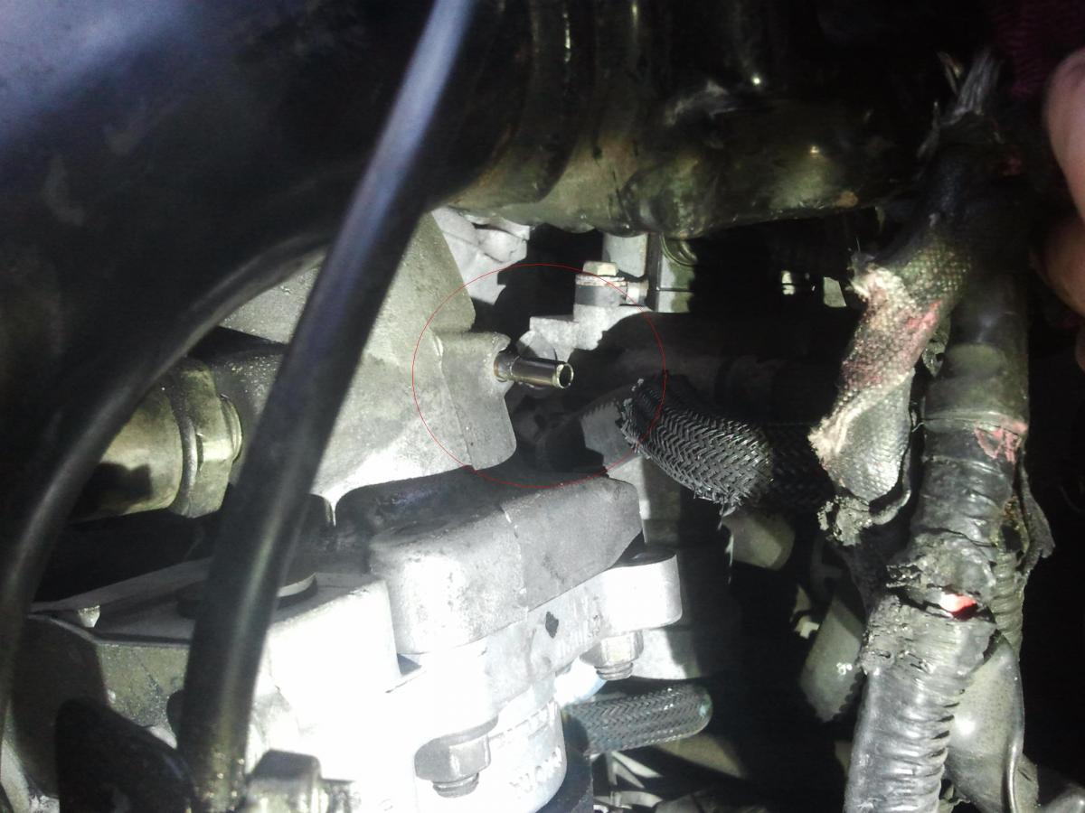

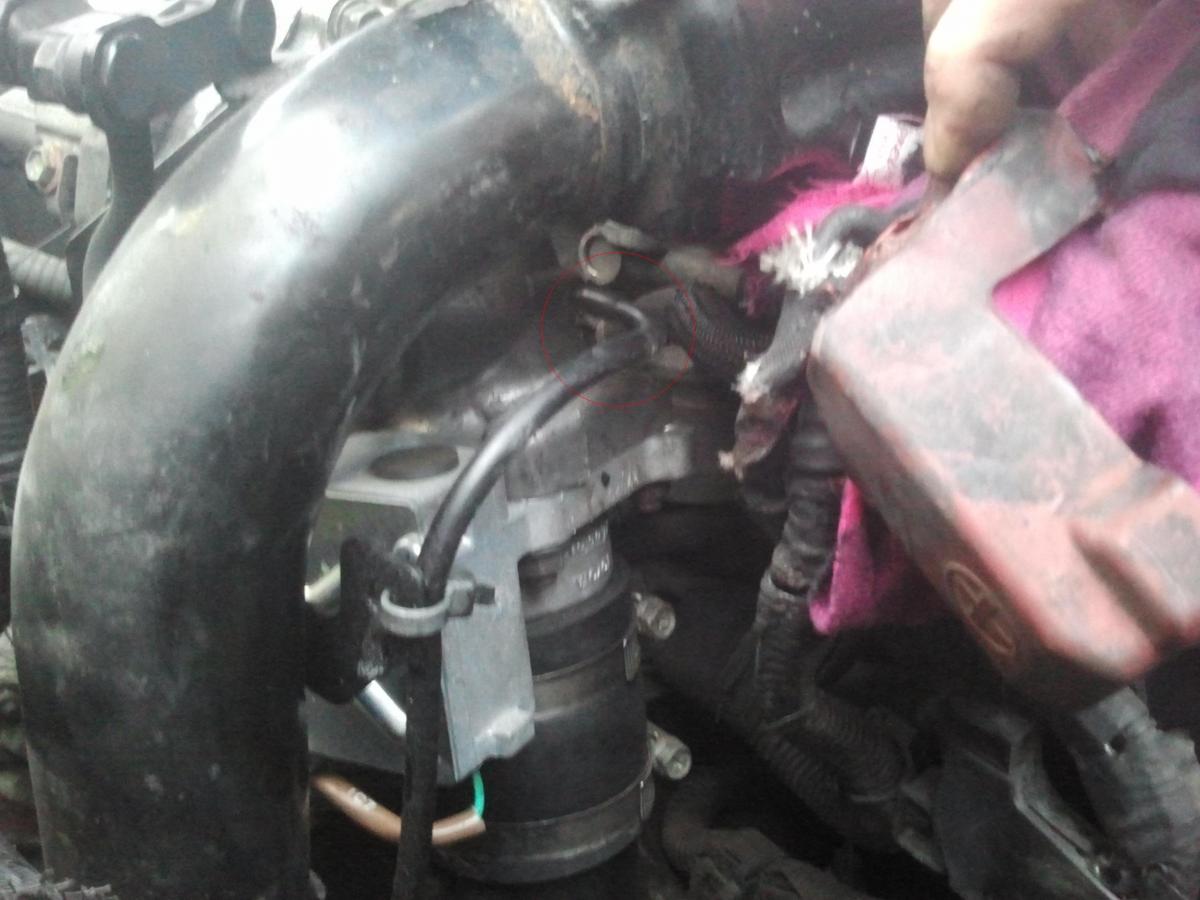

It's the small hose which is for air I think. That is disconnected and I don't know where to connect it back.
when I cleaned mine recently, the rubber pipes were full of coolant, the air channels are on the mating side of the inner face..... full of soot!
This is the hose i'm talking about, it's loose on both sides and I don't know where to connect it back.
post-136317-0-06167000-1387885410_thumb.
post-136317-0-09835300-1387885412_thumb.
Alright, i made a big mistake, that hose doesn't even connect to the EGR, so i have no idea what is that and where it comes from, the idea is that is loose. As you can see in the picture it's right near the EGR valve. Could someone identify that hose and tell me please where does it come from, cause it's an air hose.
