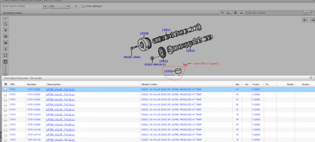

Your car has hydraulic tappets however the clearance between the tappet and camshaft can vary so there are various sized tappets to ensure the clearance is correct, this is what your Toyota dealer would have swapped/replaced to cure the tappety noise. Toyota state that valve clearance should be audibly checked every 40,000miles and adjusted as required.
Is your local repairer saying there is no such thing as a sized tappet or that the noise is/was not tappet related?
Also the 1.3 Yaris can suffer from a metallic chattering noise when the engine is under load espescially when cold, this is actually caused by the Aux belt and a modified belt part # 99366-K1770 is fitted with a new tension of 6.5-7.5mm at 98N.
There are 58 sized tappets sized from 5.12 to 5.66 .
