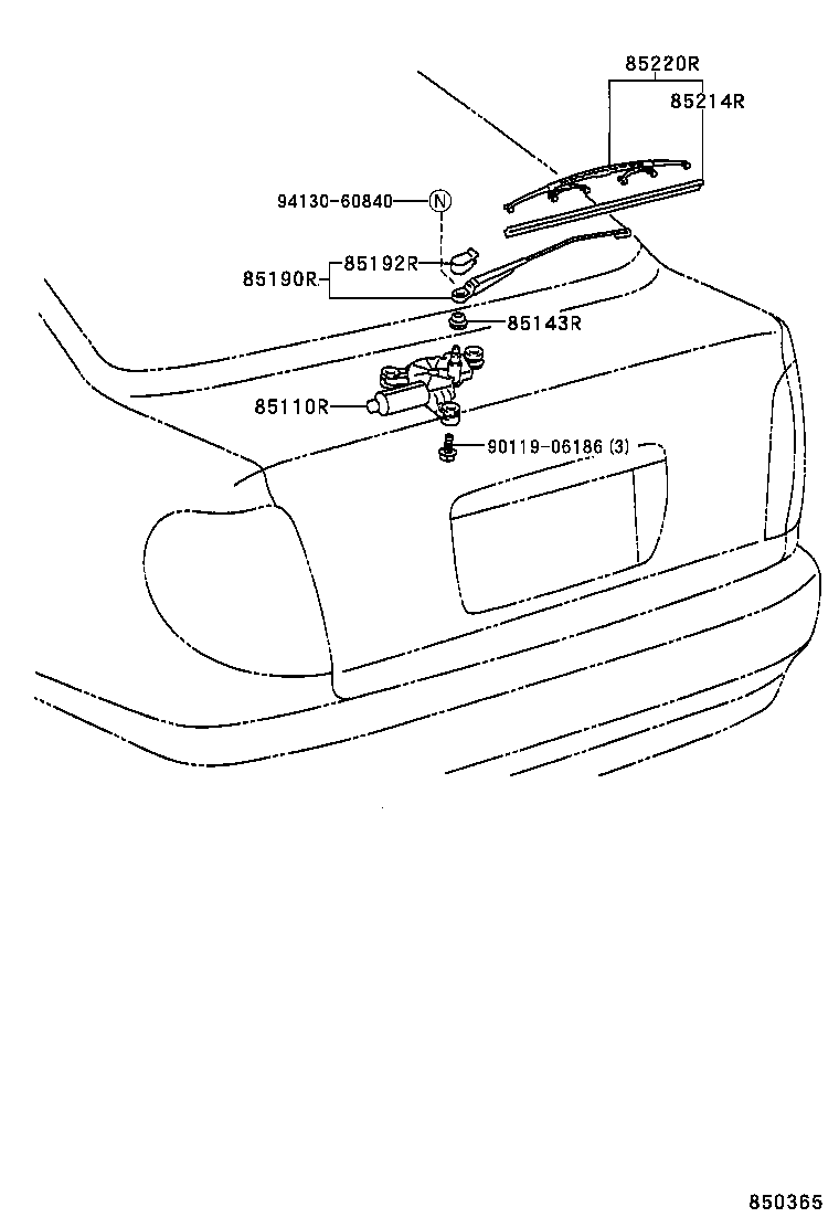

I have attached a picture showing which grommet I am referring to, Look at part number 85414R- full part number is 85143-05030
post-125194-0-37446300-1408132514_thumb.
