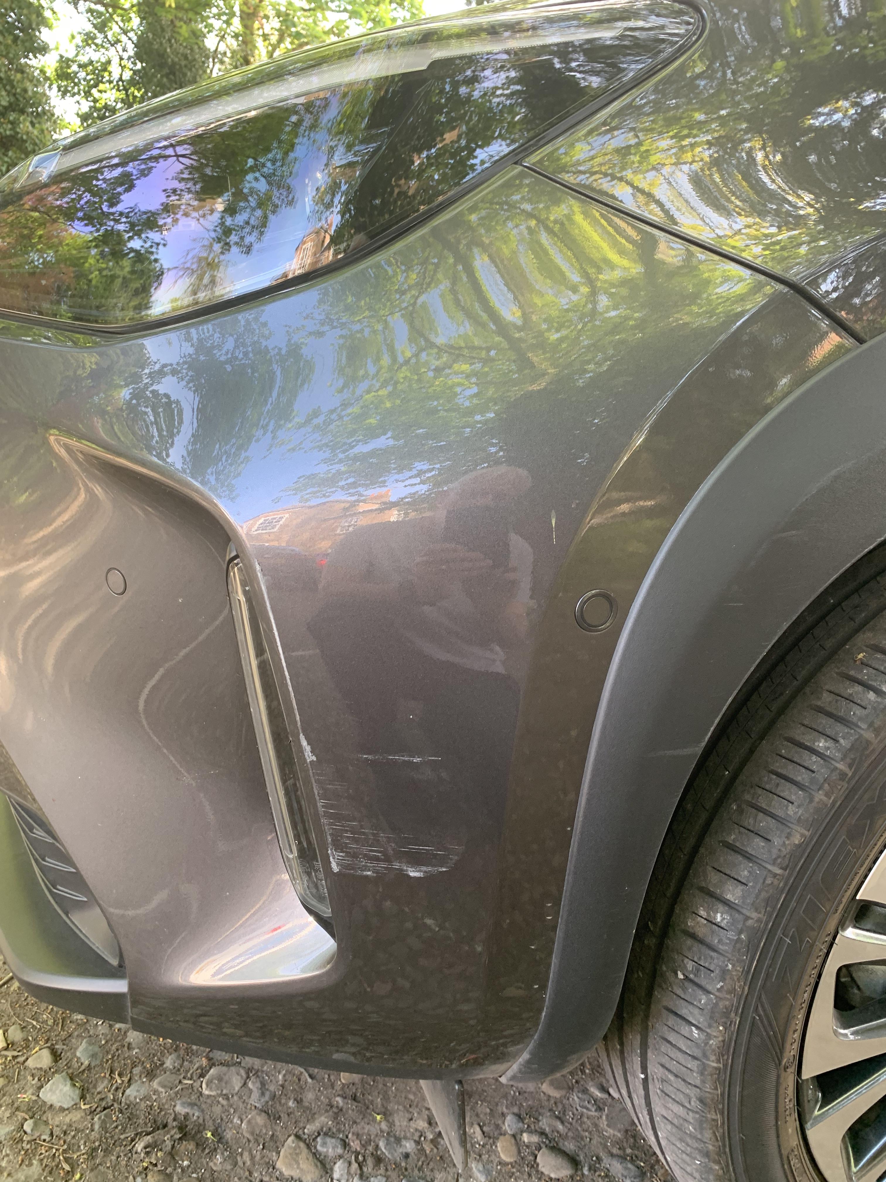

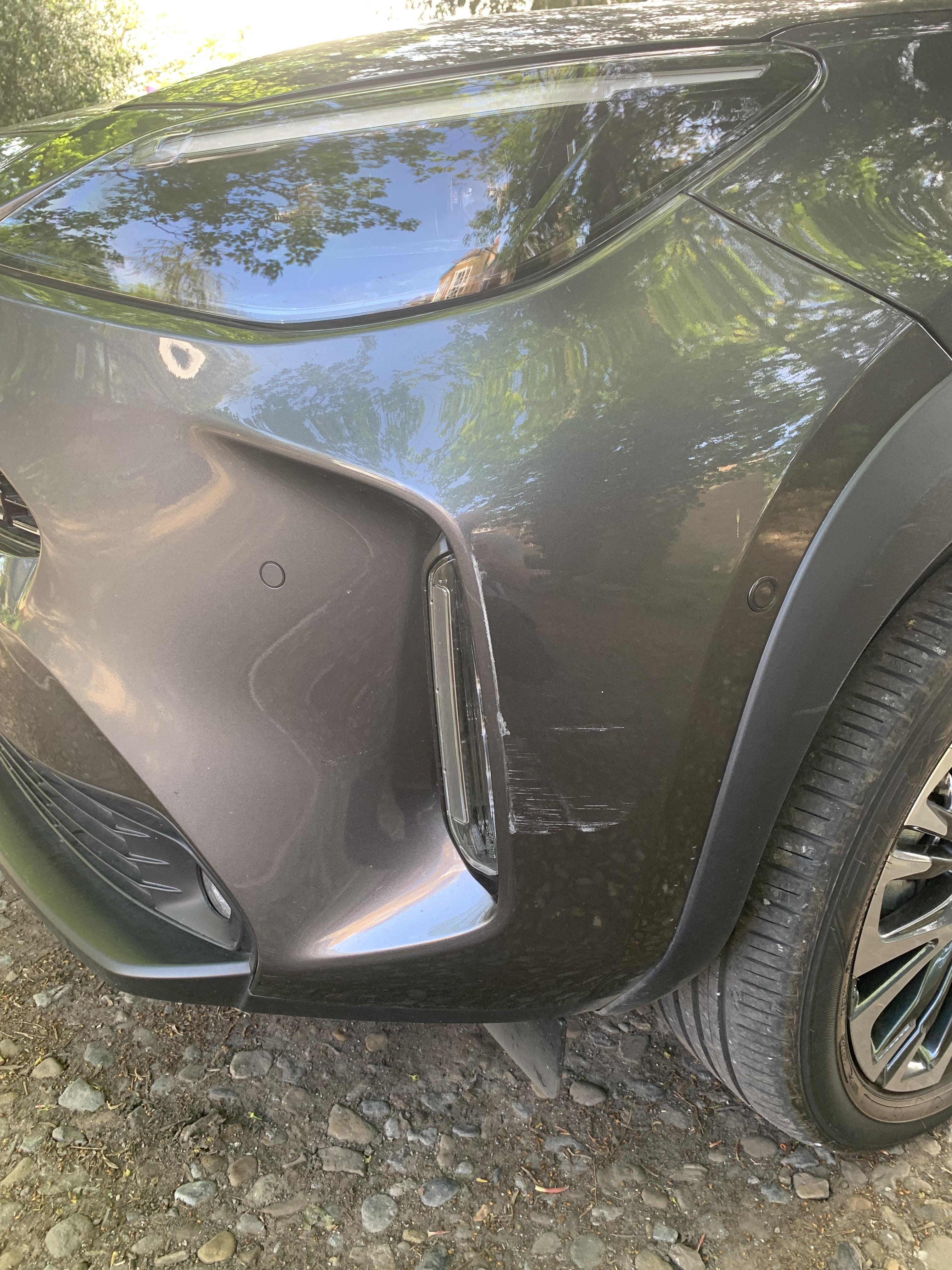

I think my car is jinxed, a puncture at ten days of ownership, then a near miss with a couple of deer, dropping my garage door on the front marking the paintwork and a crazy learner driver, and now this……..
at work today one of the district nurses who visit scraped the side of my car, parking is a bit tight but it’s been like it for years, not sure if he drove in or reversed out when he did it but it wasn’t a big car..an aygo, there wasn’t a mark on his that I could see ( typical) , anyway, I’m trying to avoid going through both our insurance and have sent him a couple of quotes for a smart repair, not heard back yet so I will call him tomorrow if I don’t..

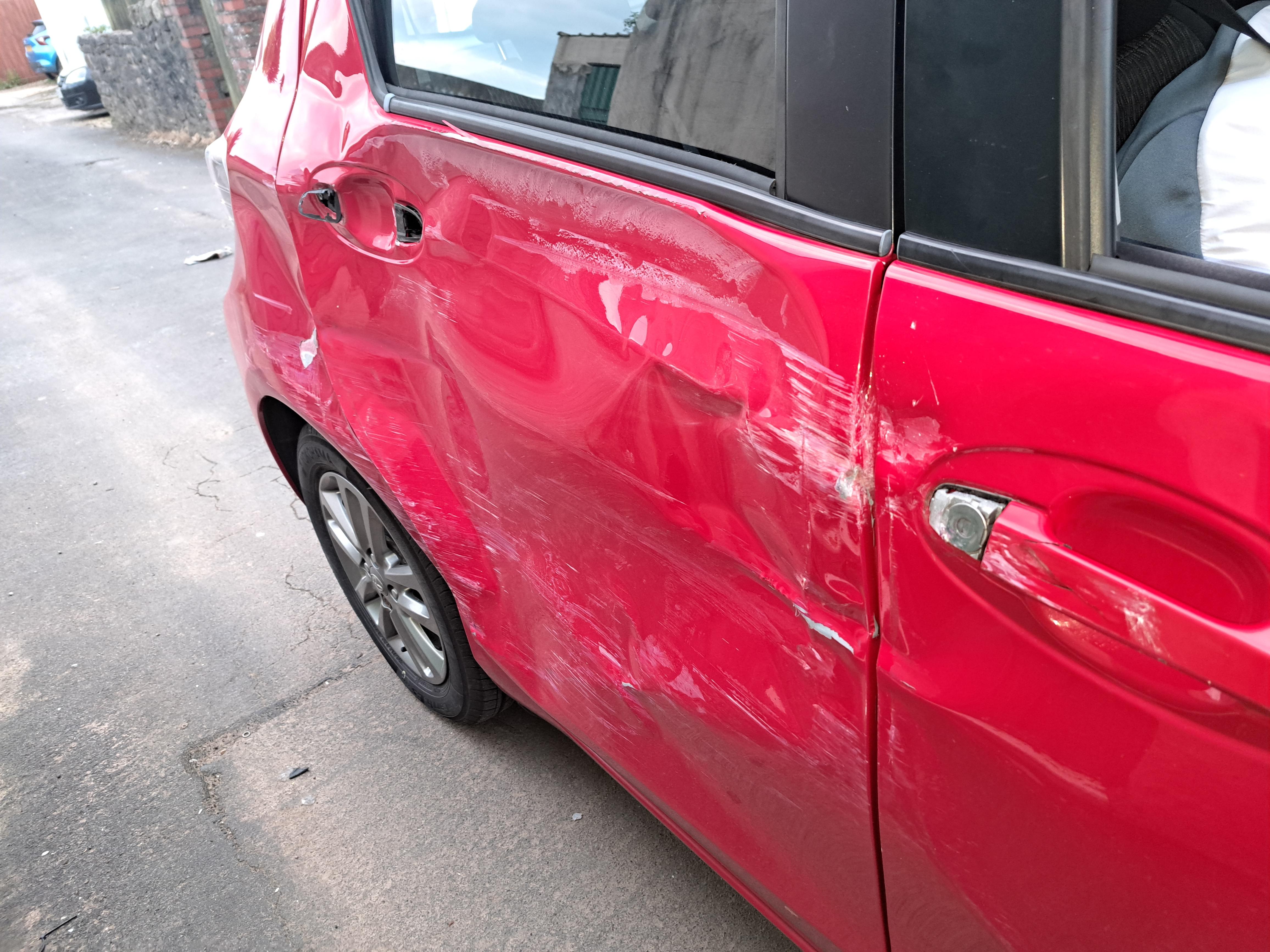

How about buying your 1st car and having it for 11days and then getting T boned by a bus .

Ouch, I feel your pain..

Hi Iain. That's nasty lets hope the insurance company agree to repair it.:sad:

The guy who scratched my car has given me the go ahead to get it repaired from chips away, there’s a disclaimer with the quote saying that I might have to get the ADAS safety systems recalibrated ( at my cost) , do you think this will require it, as it’s just a scuff on the front corner?, any ideas how much Toyota will charge for this if I have to get it done?
That’s the official method and it certainly would apply if the bump had misaligned the bumper.  The rest depends on the skills of the smart repairer.  If he works with the bumper on and doesn’t budge that black panel under the Badge, he won’t need to.  I’ve never seen a smart repair that doesn’t show after a year or two so I go to a decent body repair shop.

I'd have a go at T Cutting that, you'll be surprised at the results.  At least you'll have a better idea of the extent of the damage 👍

Almost all Toyota dealers outsource that sort of work so I'd be surprised if they could quote for it competitively.
The people that underwrite the smart repair insurance mine came with are Shine! and they did an amazing job repairing mine - I reckon even anchs would have trouble spotting the repair! :laugh:
The guy spent hours just for a 2cm scratch and had IR lamps and all sorts out to cure each layer before he did the next, and he even re-did the ceramic coating over the whole area so even the water ran off the same - Was very impressed as previous experiences with mobile scratch repairs were nowhere near that level of quality.
Alas the cover is ending at the end of this month, although surprisingly they haven't pestered me to renew which is a weird and unusual experience :laugh:
I think the ADAS thing is just because a lot of cars have proximity sensors in the bumper, and if they take it off to do the work, they may need recalibrating - The Toyota ones are self-calibrating to my knowledge, it's only the camera pod in the windshield that'd need calibrating.

ADAS is a wide term, in the front of the yaris that would be the camera on the screen, parking sensors in the bumper or milliwave radar just below the front Badge (nose, behind the bumper)
