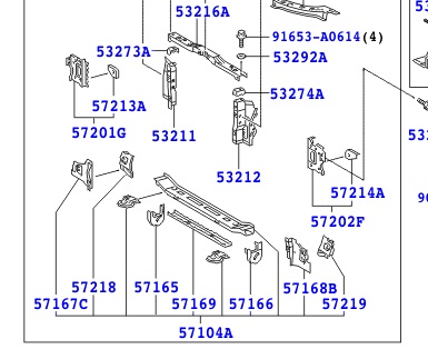

'54, 2.0 T3-S estate. The box-section of bodywork that holds the radiator up has some pretty major holes in it and needs replaced (not structural, but is holding the rad up and some of the underpanels behind the bumper appear to clip into it).
Local Mr T says it's a discontinued part - end of discussion (so helpful!).
Anybody know if there's a magic grotto where one would be lying on a shelf awaiting purchase?
If not it's going to be a very time consuming fabrication job! :(

I'd be really surprised if the part was discontinued, have a look at the picture attached, I believe you need part 57104A as 53216A is the upper radiator support. PM your chassis number and i will check tomorrow

Ok 57104A is the correct part the full part number is 57104-05041 retails at £180.89 + vat and comes as the complete lower assembly as pictured and is available on a next day order it is not discontinued.
