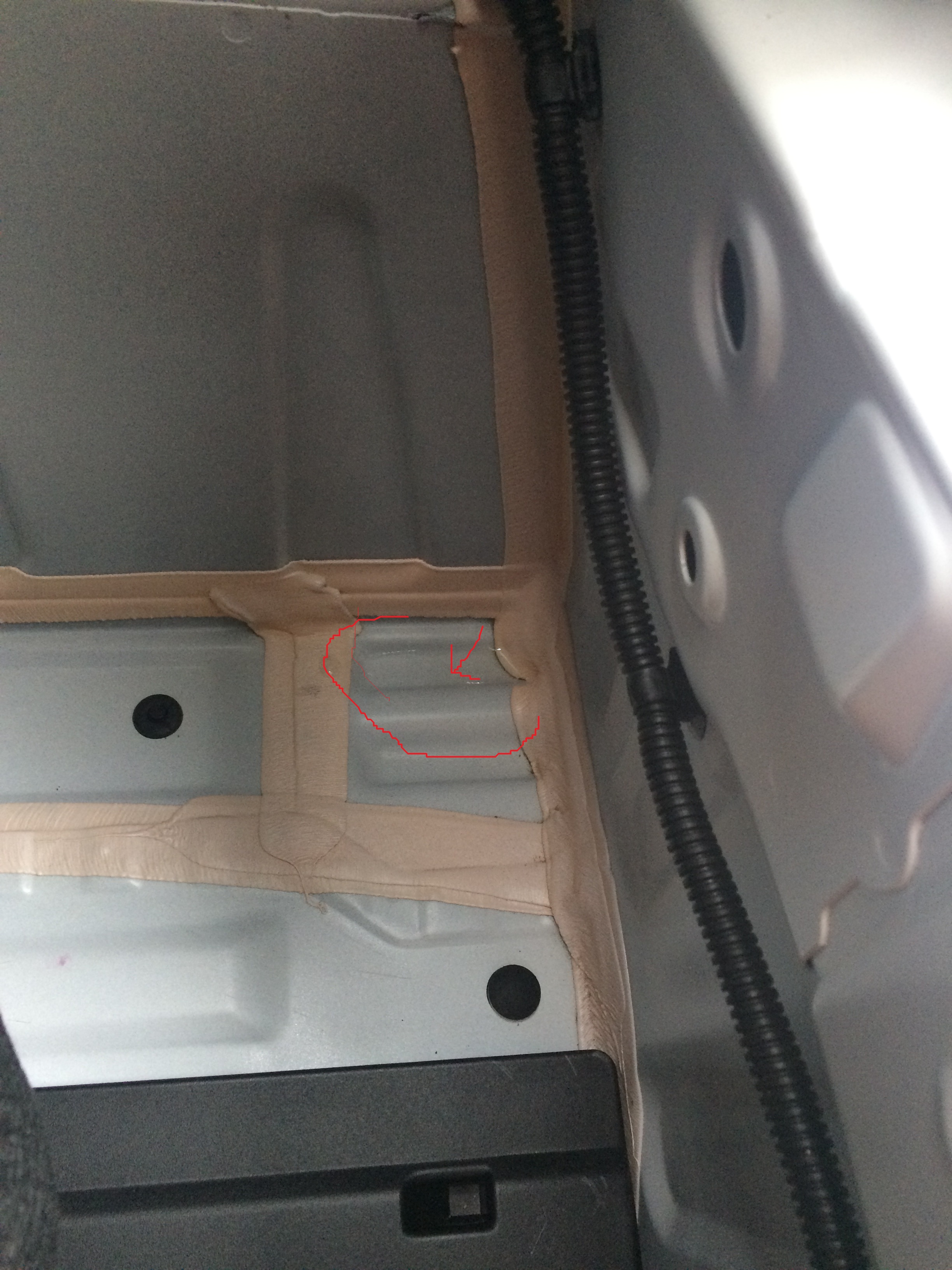

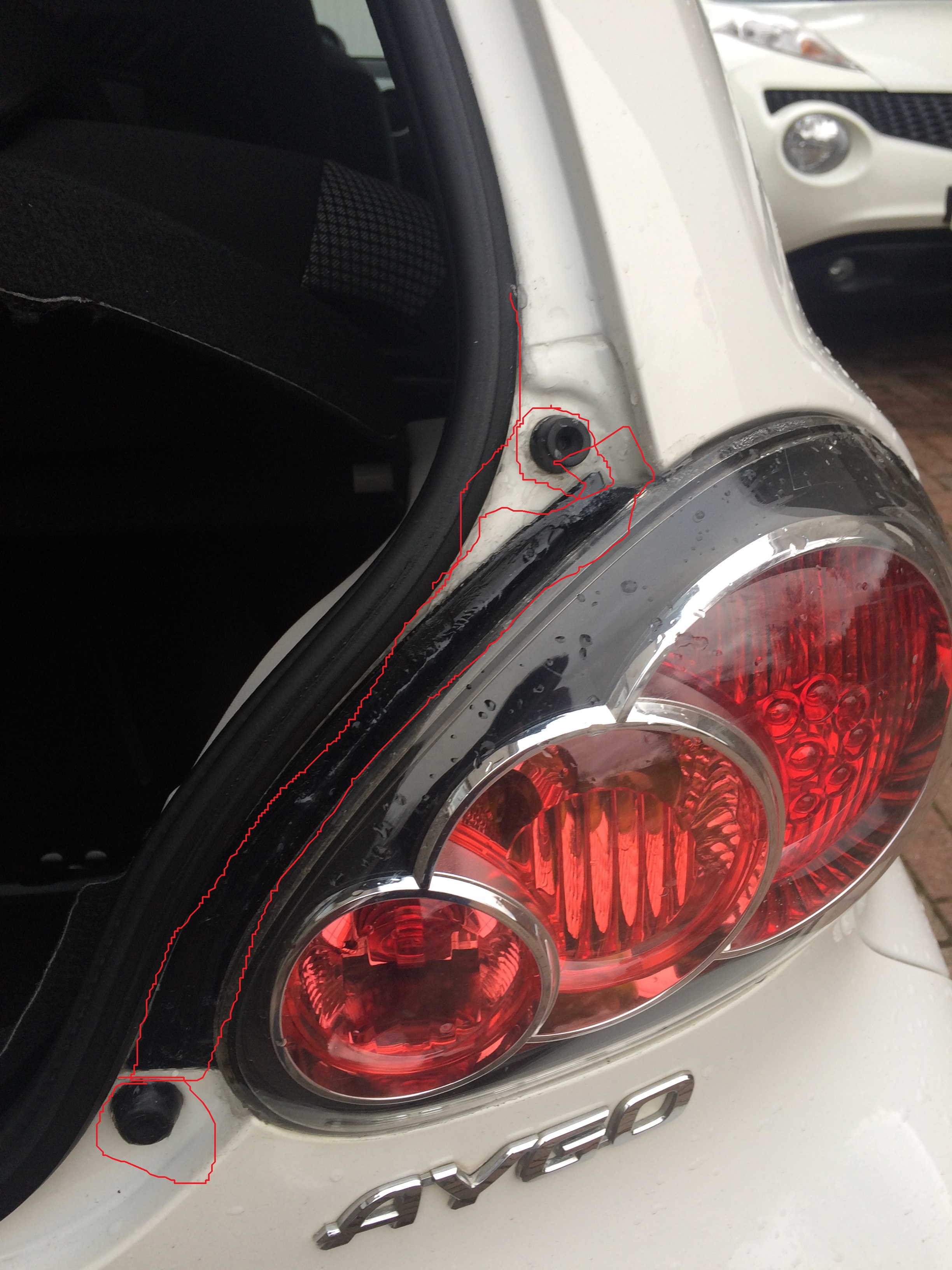

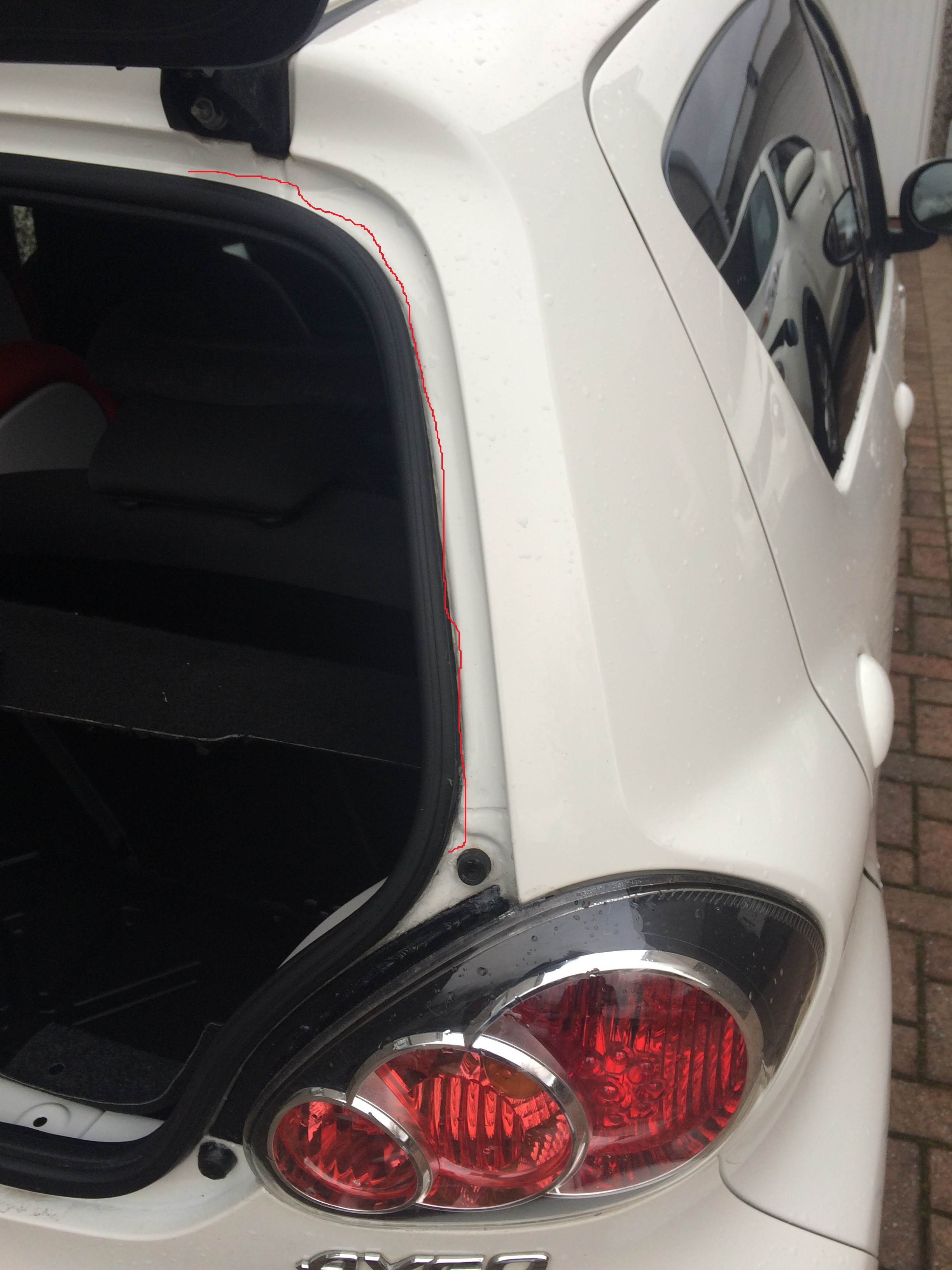

I have a 2012 Aygo Fire.  There is water coming in to the boot, bottom drivers side.  I have attached photos.
 I have so far applied silicone  round the light highlighted in red in the photo as I thought the water was getting in here, so I silconed, sprayed a hose over the light and no water.  Dried it all off and hosed the car again from the top of the car right side and water coming in, applied more silicone around the rubber trim as highlighted in the photos and hosed again, water still coming in.
Has anyone else had this problem or any suggestions where else it can be coming in from?

he said it needs a bit of work as water is coming in from a few places, mentioned hi level light and ducts behind the bumper.
not sure what he means by hi level light, guess the brake light at top but when I hose the car it's away from the light!
i can soke the car from the rear lights down and it's all dry it's only when I spray from the top right side water comes in the bottom right of the boot.

Thing I don't get is if I soak the car from the rear lights down it's dry, soak it from the top right about where boot hindge is but not on a the hi break light it's wet inside?
