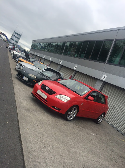

Hey Guys and Gals,
I recently got an e12 and decided to put my touch on it... anyway I bought 17'' alloys and 50mm APEX lowering springs, After having the springs in the car a couple of months they havent really settled very well on the back the car still looks fairly stock. Anyone have any suggestions what to do with the springs to get the car sitting a bit lower, Also if anyone has any ideas what to do with it next go for it I need some ideas, That's my e12 in the pic
Cheers
