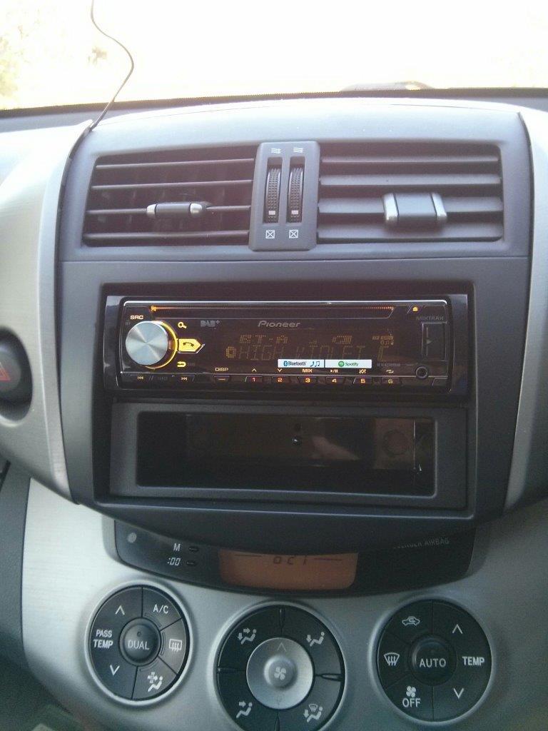

Catseye27, I'm guessing you had to purchase a frame to fit the single din in there, would a double din fit without any work do you think?
I usually did this with a cotton swab, clean with one, then finish it with a dry one, give it a good look to make sure there's no specs of dust or anything on it, reassemble, should work fine.
I went the single DIN way as suited me but yes, a double DIN is available and these units can have touch screen, satnav etc. The steering wheel functions all work with my Pioneer unit, just make sure you get the right adapters for your car and unit.  My only complaint is brightness of unit display, nearly impossible to see in sunlight, seems common to most if not all manufactures of replacement head units.
My frame insert is a double DIN, just has pocket inserted below radio and just pulls out.
