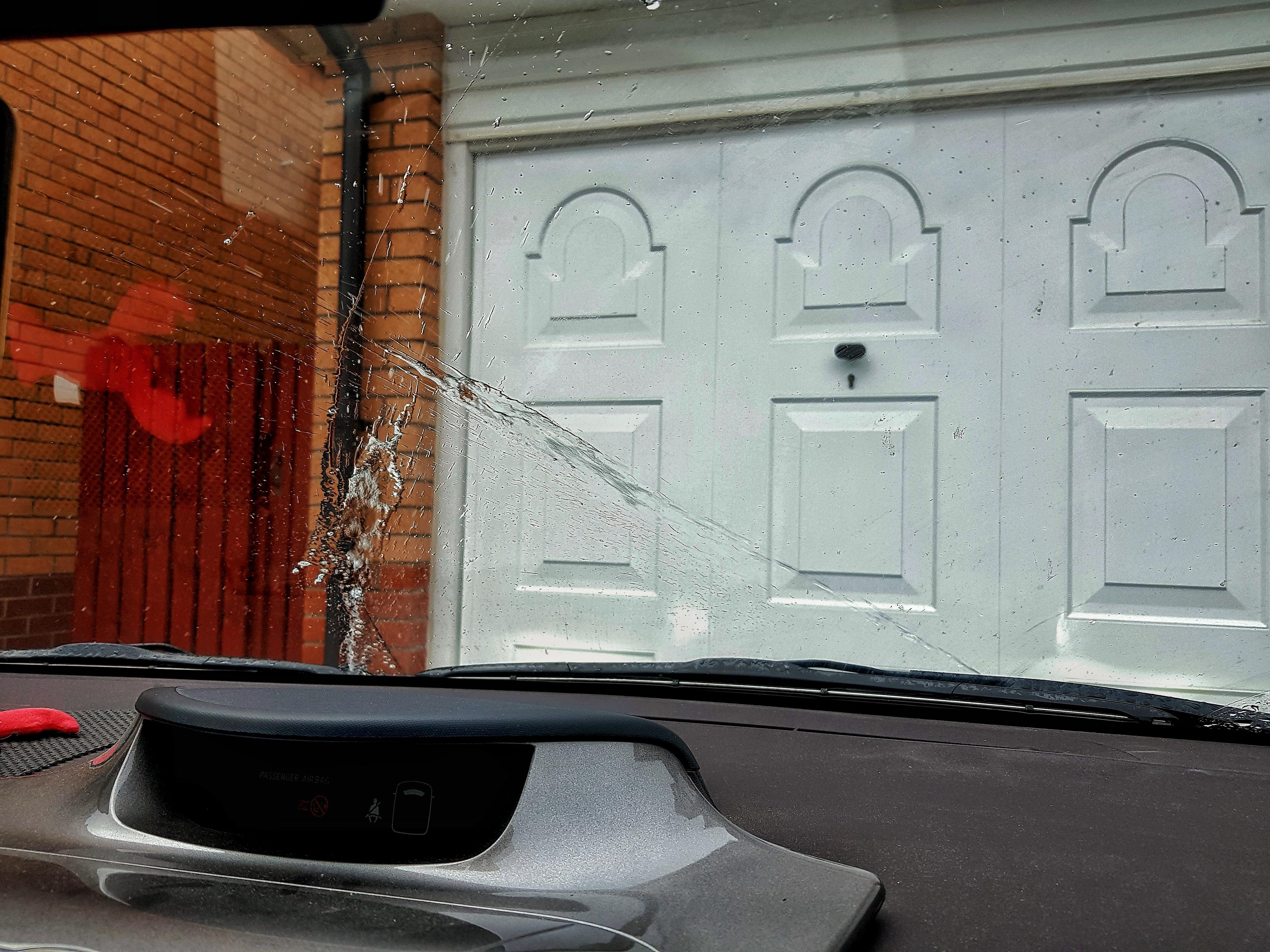

Hi guys,
I have a slight issue where my washers are only spraying inwards and not outwards aswell like they normally do.
I thought it might have been the T connector that splits the windscreen wash fluid between the two jets, so I replaced that but I still have this issue.
Could the jets themselves be damaged? or do I just need to clean them out somehow?
Any help appreciated.

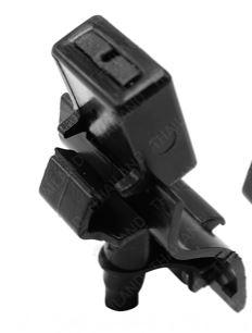

Those jets are ceramic, and very difficult to clear as they don't work like an old traditional washer jet. These new type jets fire considerably more water at the screen with a lot more power, probably best to replace them. Going forward always ensure you use a quality screen wash which helps to keep the jet clean, dont use the likes of washing up liquid which clog up (Yes plenty of people still do this)

Thanks Kingo. I've based all my comments on the Auris jets which look similar-ish to these. Whatever is fitted though, I would be extremely reluctant to part with £35 for a new set unless I was absolutely certain there was no hope of resurrecting the old ones. Fwiw, the picture in post #1 looks exactly like the weird kind of spray pattern the Auris jets degenerate into. Lots of water shooting a few inches up the screen.

Yes you can sometimes get away with the compressed air trick, but usually have to replace them in the end, like the Auris, you can get them in -1 degree, 0 degree and plus 1 degree aim
