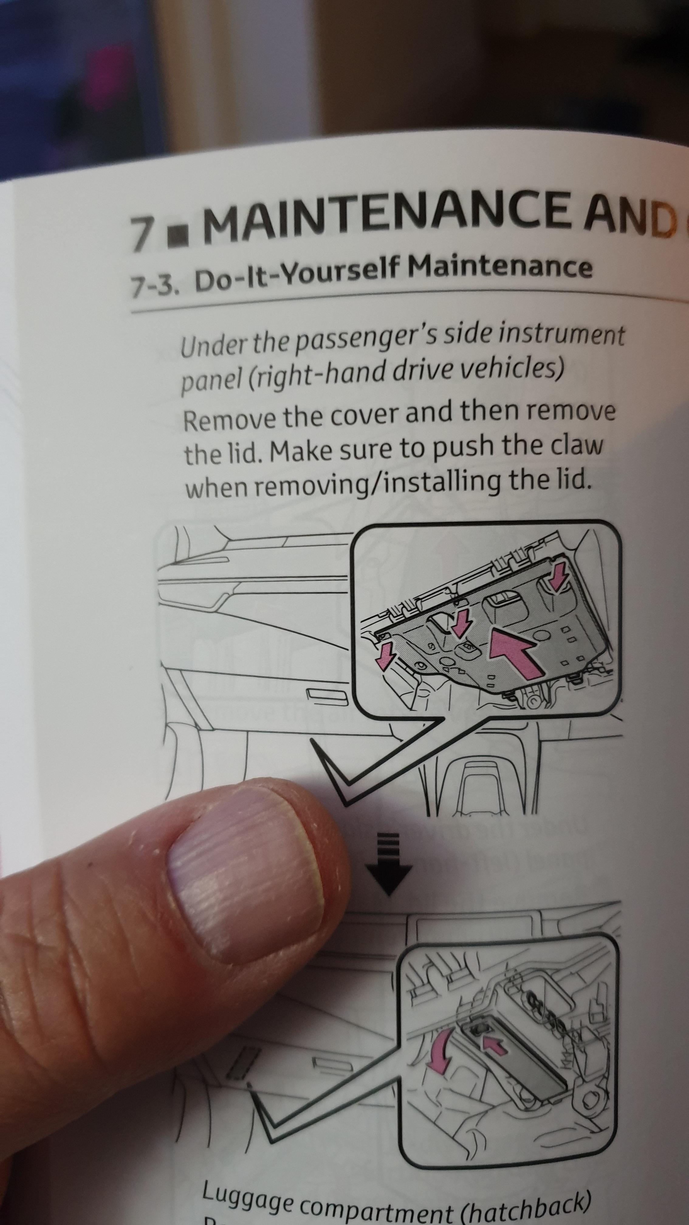

After some searching there seems to be a fuse box at the back area of the glove box on the right hand drive models
Will take a feed from there

Ok removed the cover at rear of glovebox and there is 2 rose of micro fuses. I have piggy backed from the rear wiper which is a switched power source and fed the lead around the inside weather strip, up th A post and along top of headlining
Dash cam works fine
