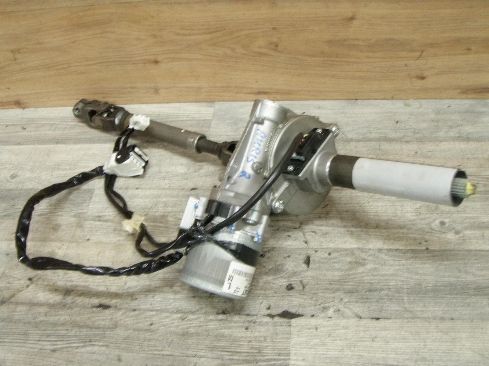

If it's of any use, this is an (eBay) picture is of an Auris electrically-assisted steering column, I doubt the Corolla is much different.
The left hand end of the assembly clamps directly to the, traditional-style rack, the r/h side attaches into the steering column height/length adjustment (not shown).  The motor, pointing diagonally upwards, is in the lowest part of the picture, it is geared to the shaft through a worm drive gear, it's at 90 degrees to the steering shaft.
HTH.
