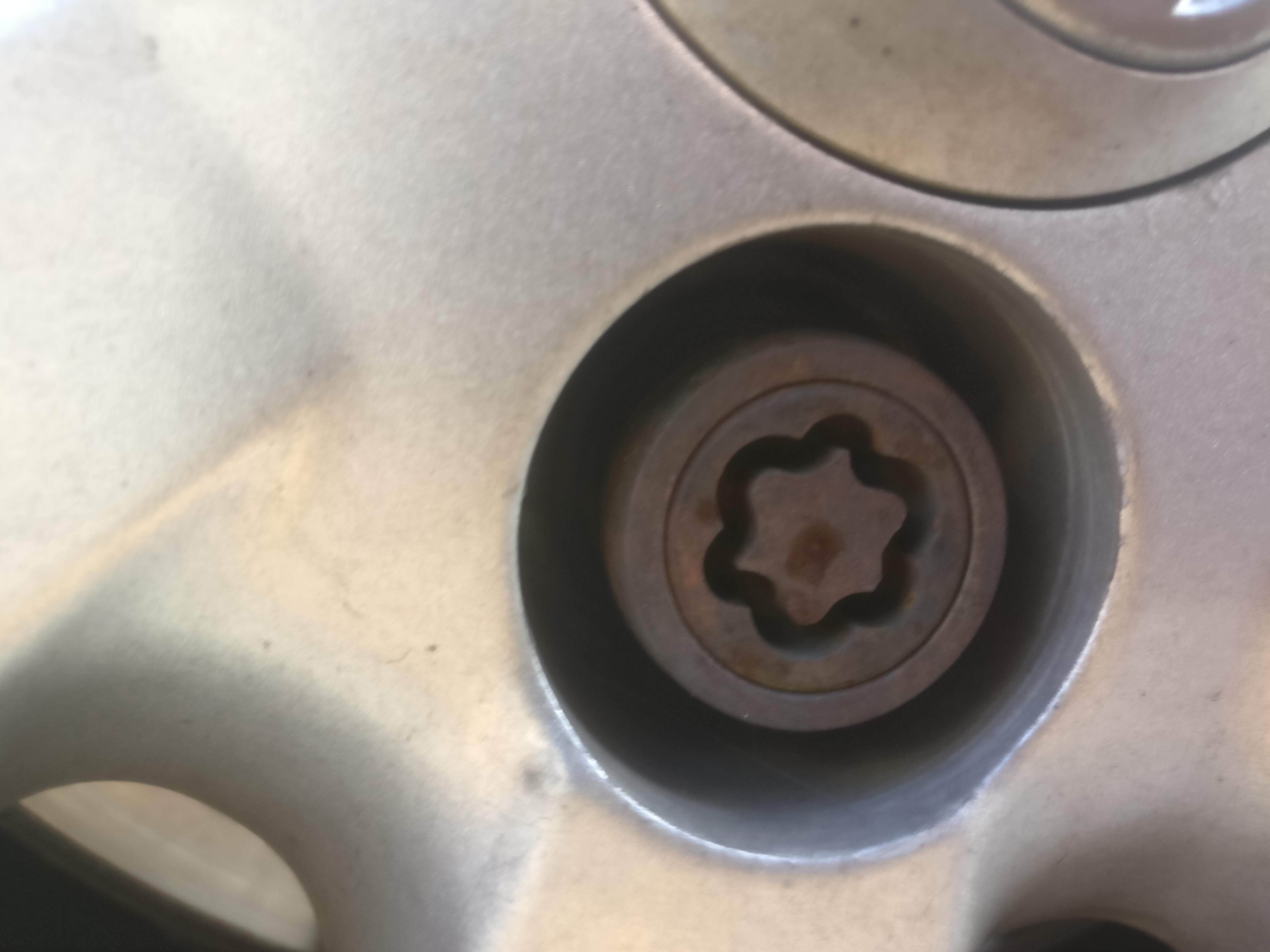

I just bought a Yaris MK2 but it didn't come with the locking nut key box, I'm not sure on which one to buy as a replacement, I've attached the nut picture and would appreciate any help.

Alternatively, think the locking wheel nuts are made by McGard, you could try contacting McGard re a replacement - https://www.mcgard.de/en/customer-services/replacement-key.html
That type of lock nut is made by Evo Automotive, you need the key number which are stamped on the nut. Can be ordered from your dealer if you get the number, otherwise you are stumped

Yes I looked everywhere there's no card or tool pouch, I had to add my own jack as it didn't come with one, Toyota said they can only help with the code. Guess I'm going to have to break them off. Thanks anyway.
A main stealer should have a master set and should be able to remove them for you for a few beer tokens
I may be stating what you already know, I couldn't find the jack on my car when I first got it until I was told to look under the front passenger seat, voila, a jack. Also under that seat is a drawer that slides forward between your legs when sitting on said seat, in there was the locknut for the wheels.
