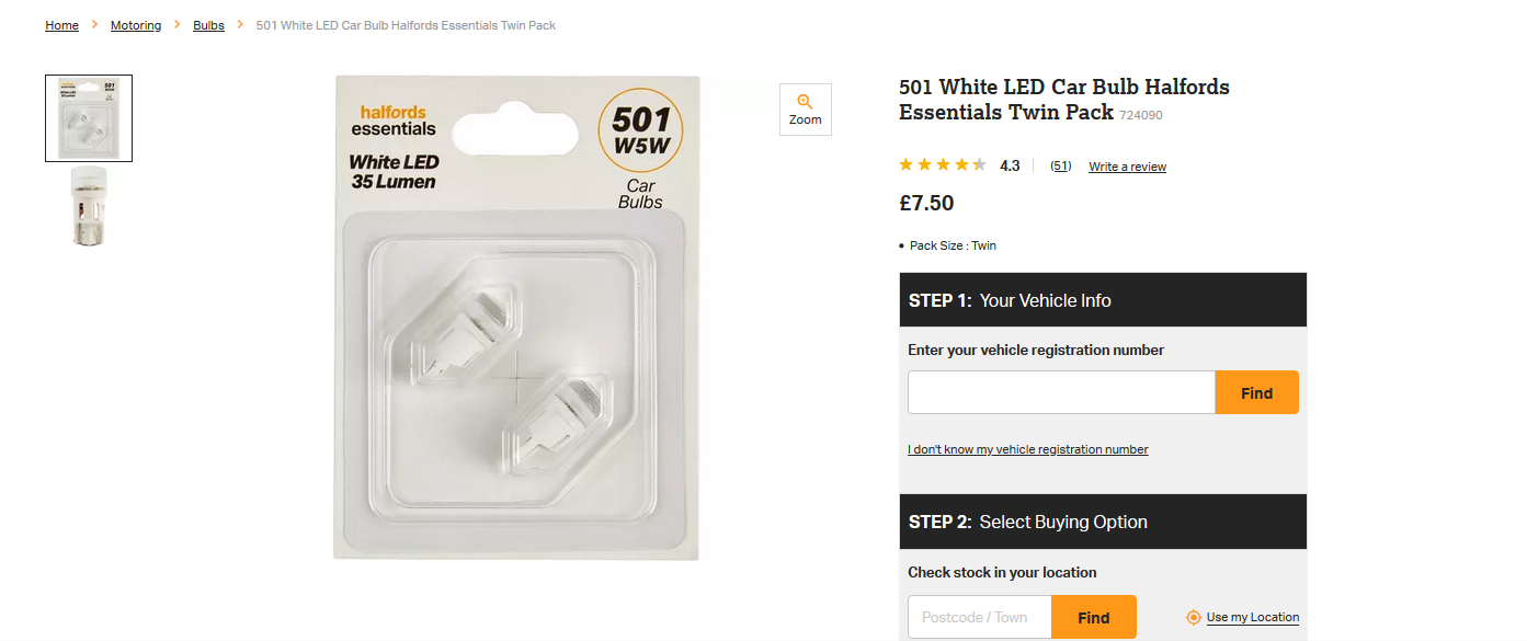

stevecrvn 27 Posted March 25, 2020 Share Posted March 25, 2020 I had the front ones from Halfords . Much better light . I have not changed the centre one 1 Quote Link to post Share on other sites

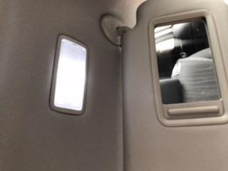

Lee_johnson1975 4 Posted March 25, 2020 Share Posted March 25, 2020 I bought a pack of the 10 pack plastic coated ones and did the interior ones X3 bootx1 ( standard boot light bulb is rubbish) and number plate light bulbs (pain to change) cost fiver result much better whiter light 1 Quote Link to post Share on other sites

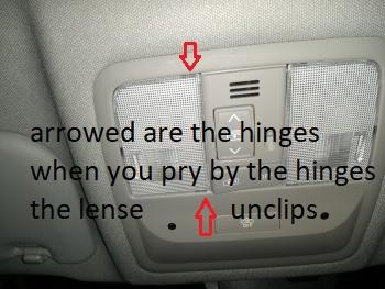

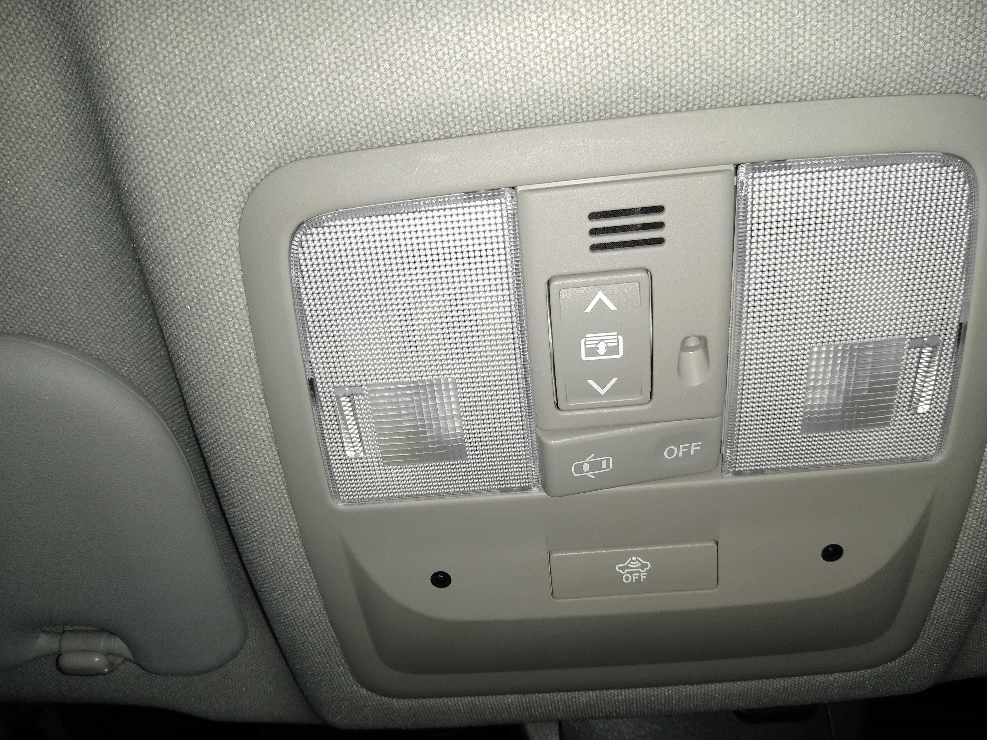

Auris Geezer 13 Posted April 2, 2020 Author Share Posted April 2, 2020 Thanks to all who have replied here, much appreciated. Here is a photo of the interior light unit, please could you tell me where to prise off the clear covers to access the bulbs? I've checked the manual, both hard copy, and the more detailed online manual, and I've found no mention of how to change the bulb(s). Cheers, Trev. Quote Link to post Share on other sites
eygo 242 Posted April 2, 2020 Share Posted April 2, 2020 just gently pry by the hinges the lens will unclip you can see a clear gap in the lens pry there 1 Quote Link to post Share on other sites
Auris Geezer 13 Posted April 2, 2020 Author Share Posted April 2, 2020 Many, many thanks Mark. Cheers, Trev. Quote Link to post Share on other sites
Packard 10 Posted April 2, 2020 Share Posted April 2, 2020 If your accident prone cover the flat bladed screwdriver with a small sloth so any slippage won’t cause damage 1 Quote Link to post Share on other sites
Auris Geezer 13 Posted April 2, 2020 Author Share Posted April 2, 2020 Fortunately, I'm not too far away from Chester zoo, so getting hold of a sloth won't be much of a problem 🙂 @eygo Just tried it, worked a treat, top man! Quote Link to post Share on other sites

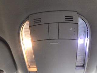

MrZardoz 29 Posted April 3, 2020 Share Posted April 3, 2020 Remembered I had a bag of assorted LED bulbs in the garage and just had enough of the right types to swap out my interior bulbs. Nice white light now instead of the yellow. 1 Quote Link to post Share on other sites
