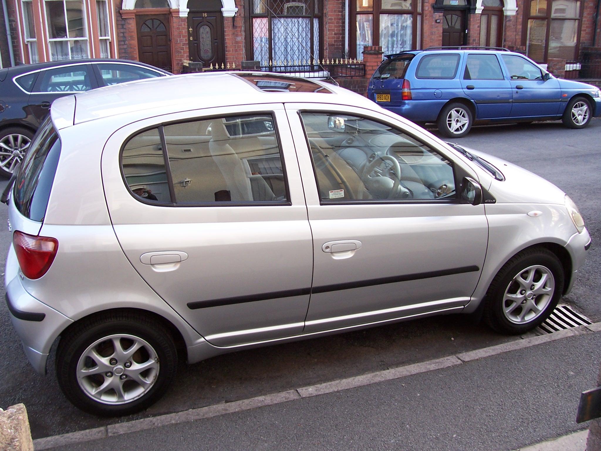

When I first got my 1999 1.0 CDX (in 2011 that was), I had issues with the tyres going down, and not just on one wheel either. The CDX and T spirit Mk1 Yaris used the same type of alloy wheels from the start, in 1999 up to late in the Mk1 run, and these tended to corrode and allow leaks round the rims. as the wheels on my CDX were quite corroded, I chose to replace the wheels entirely with new alloys, but it sounds like your wheels were the same type as the ones I had. In which case what you had done would likely sort the issue on the wheel that was losing pressure, but other wheels could well cause the same issues if they are also corroded. The picture was of my Yaris taken back in 2011, showing the type of wheel that I had problems with. Now I own a Mk2 and it has steel wheels - much less problem with them losing pressure - just not as nice to look at.
Thanks for the picture-yes those are like my wheels. I will have to keep a lookout for the other wheels.
