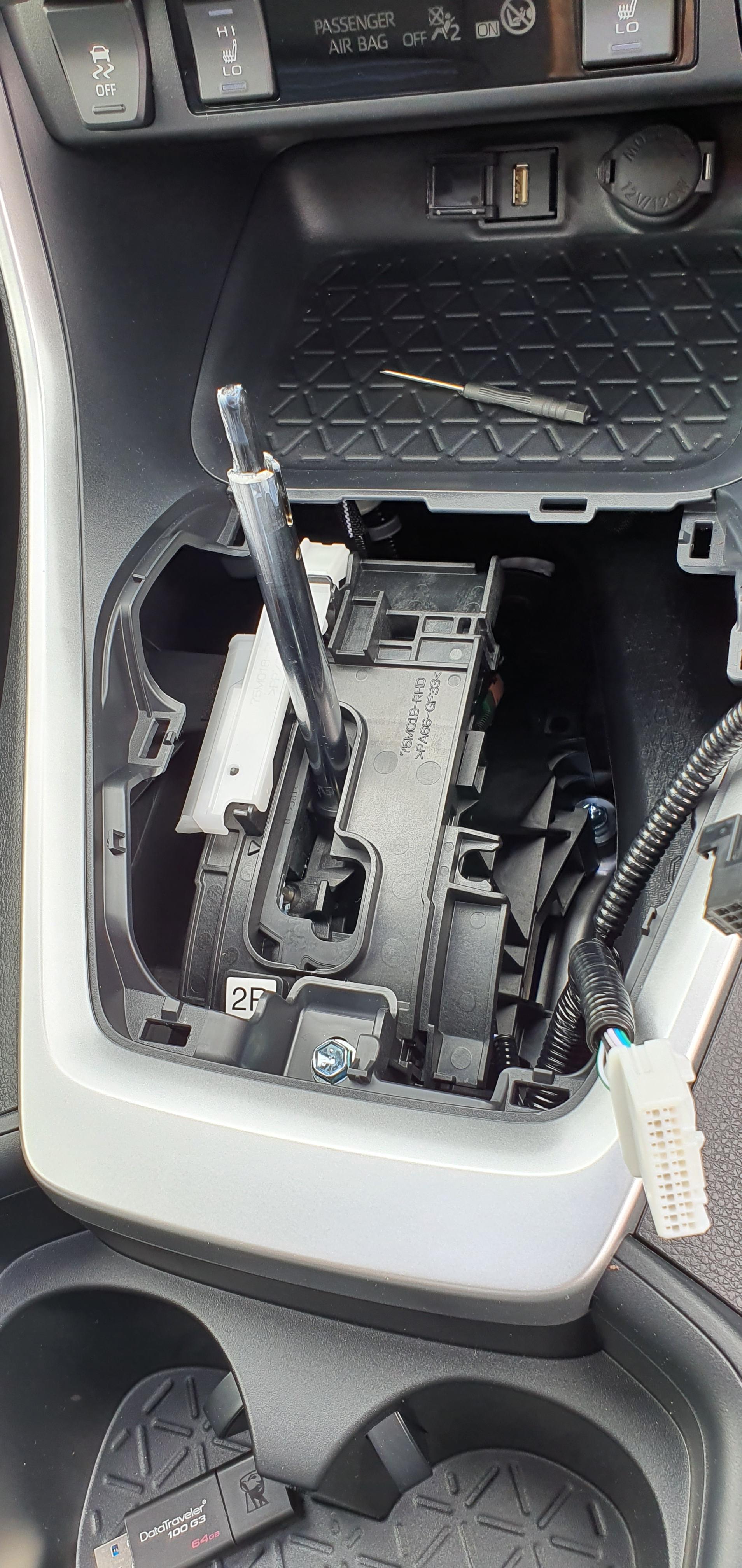

Easy to fit too. Unclick the gaitor and remove clip from gearknob.
Unclip the gear shift panel (tools provided).
Disconnect the cables.
Unclip the original phone bay and disconnect cables.

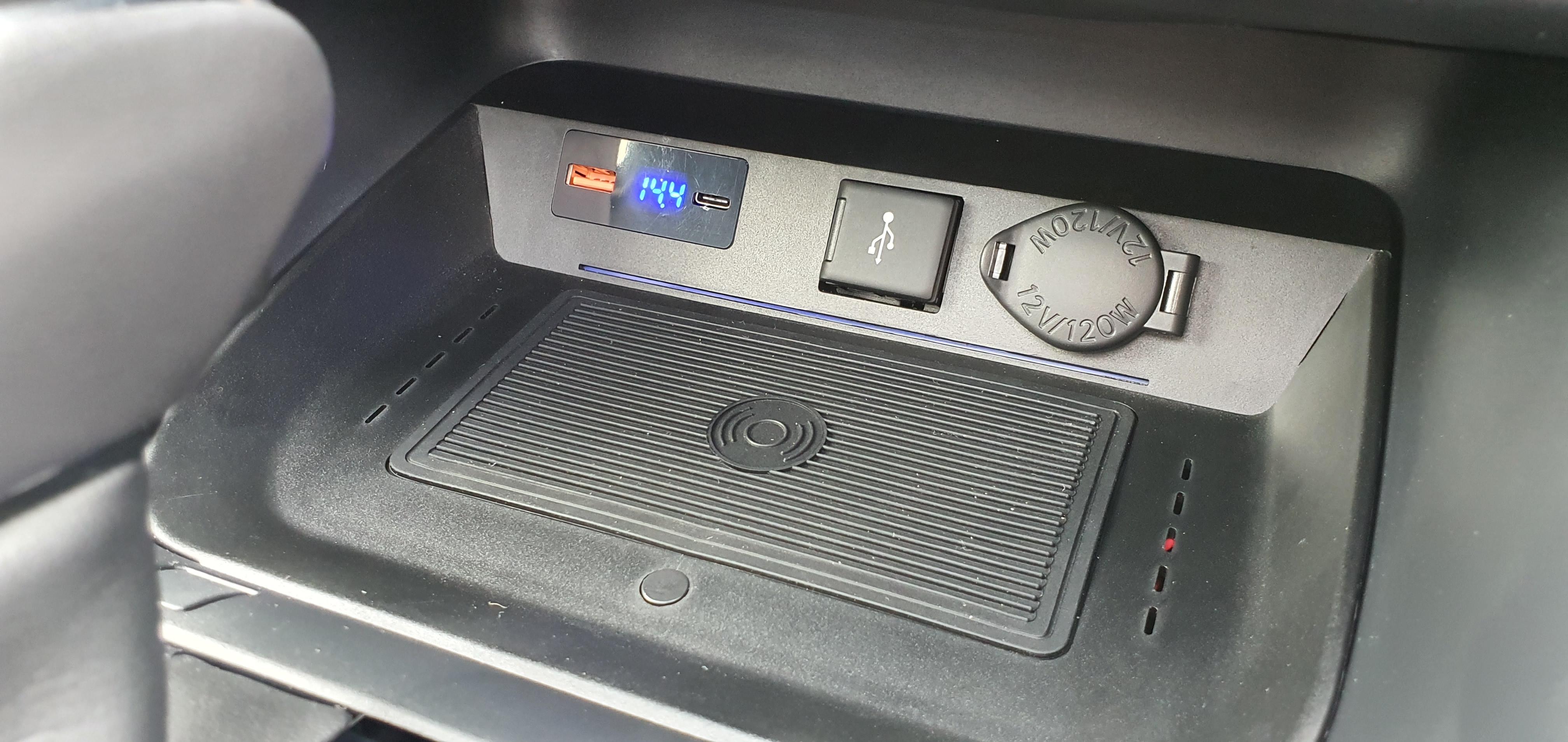

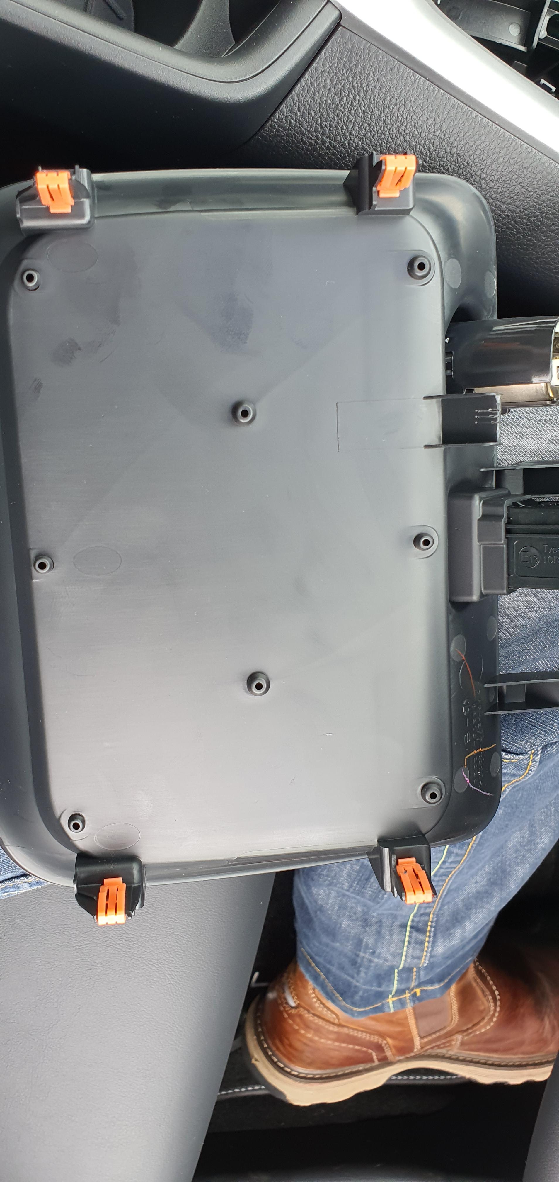

Remove, 12v socket, USB and clips from original and fit to new one.

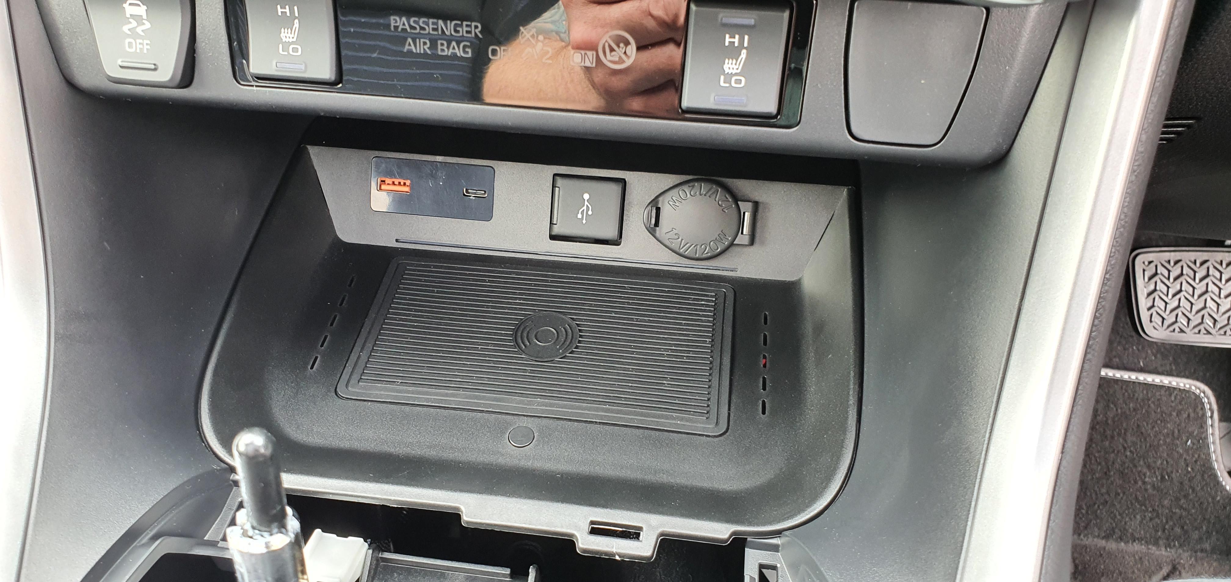

Plug in the the link and reassemble.
Job done 👍🏻

Great stuff. Looks pretty oem too which I like.
