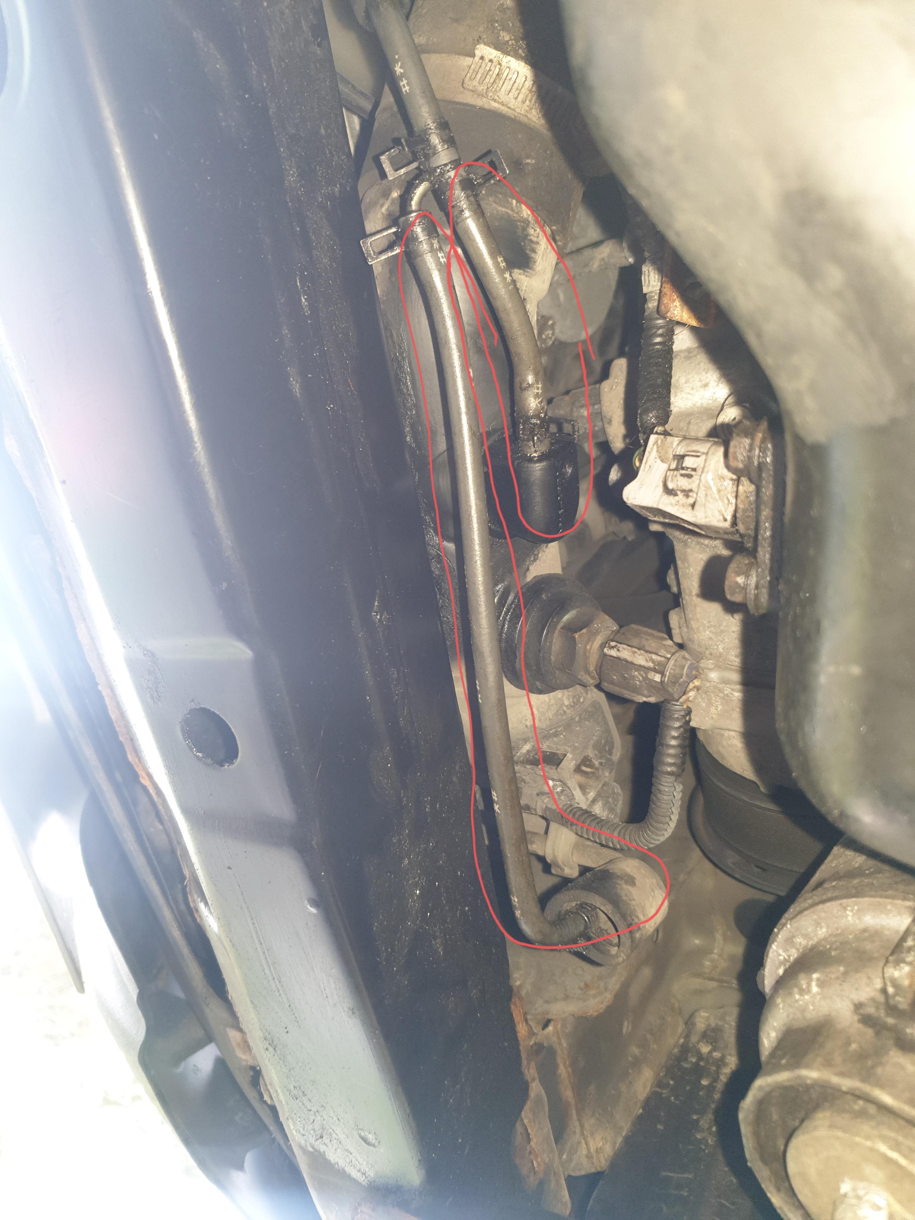

Hi I've searched everywhere but I cant find anything that identifies what this pipes are at the front of the car just behind the bottom of the front bumper. They are opaque and have a # * symbols on it. The were absolutely caked in oil and I noticed one has a split in it.
Any idea what these are and what they transport? Car is a uk 2006 T180 D-Cat.

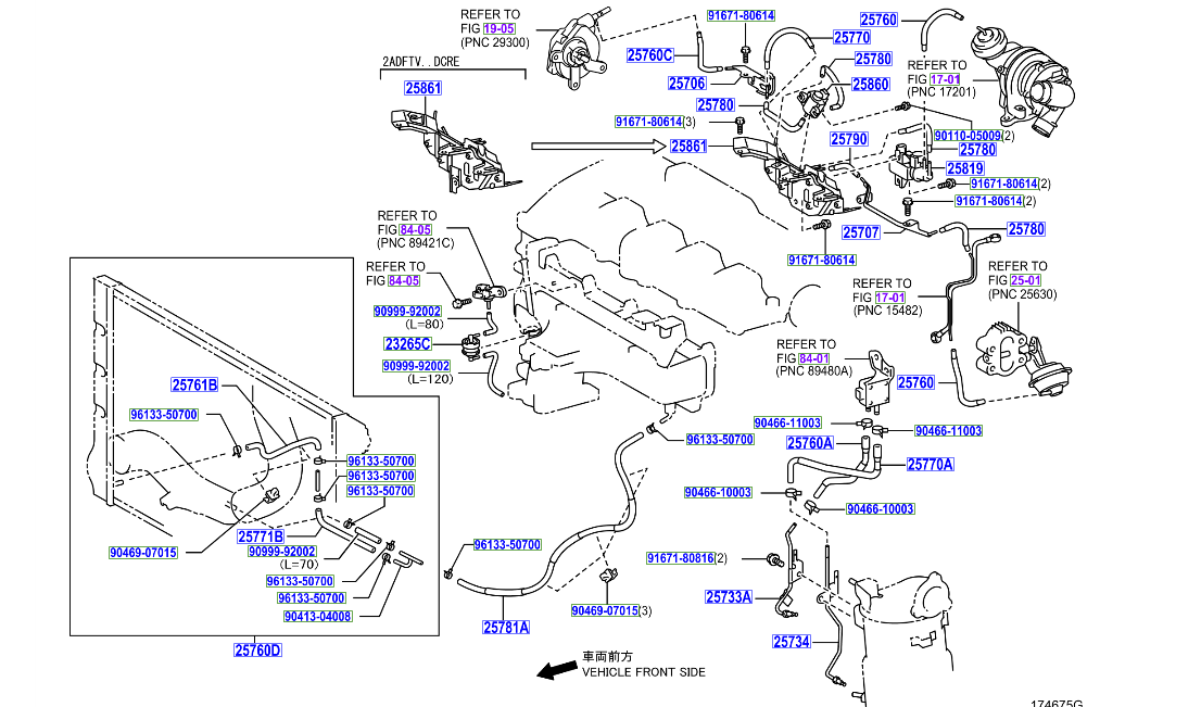

They are vacuum pipes connected to the Inter-cooler pipe and connect to the Inlet manifold at the other end.
