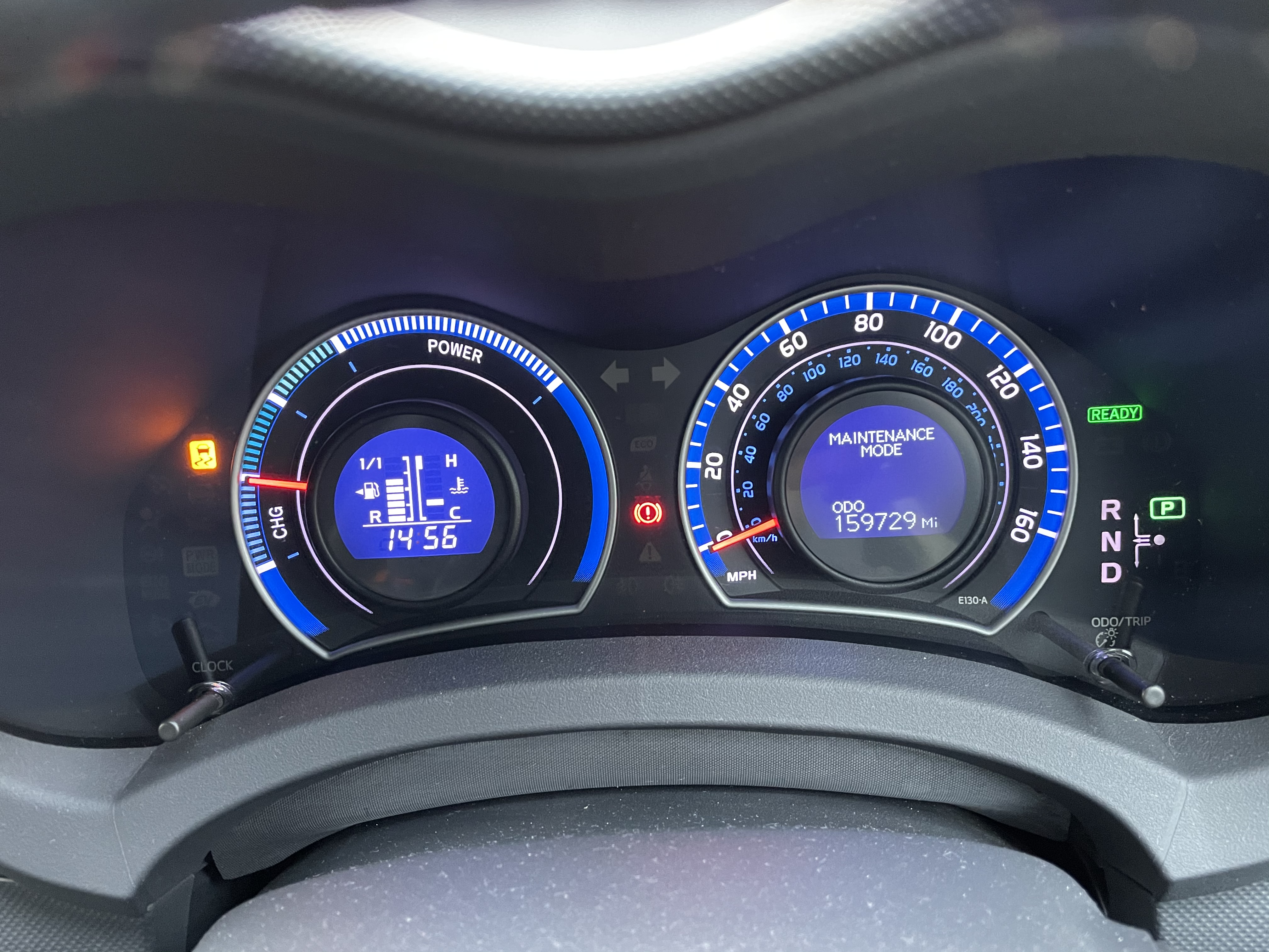

on the first gen Auris hybrid you can not turn off traction control with a button, however you can put the car in “maintenance mode” which switches off traction control and turns on petrol engine that can help you get out if you stuck in mud, snow or any similar situations., but do not drive the car like that for extended period of time, 5-10min max then turn ignition off , and on again if you require to drive the car more .
 To do so you need to follow these steps:
1. Apply hand brake (parking brake) then Double press start button to put the car in accessories mode and press accelerator twice fully and release
2. Press brake pedal and hold the gear lever into N position to put the car in Neutral
3. Release the brake pedal and double press accelerator fully and release
4. Press brake pedal and put the car in P parking then double press accelerator again
5. Press brake pedal and turn on the ignition, the car will start its petrol engine and there will be a text displayed on the screen “maintenance mode” and yellow light for traction control. , now you have your car ready for action. You can burn your rubber and get yourself out of trouble. Once you out all you need is to stop, turn off and on again and the car is again with traction control on and everything as normal. 👍 Btw traction control works really well and if one of the wheels has traction will help a lot, but if both front wheels loose traction it just turns off all the torque from the drive train and you are literally going nowhere. 👌
