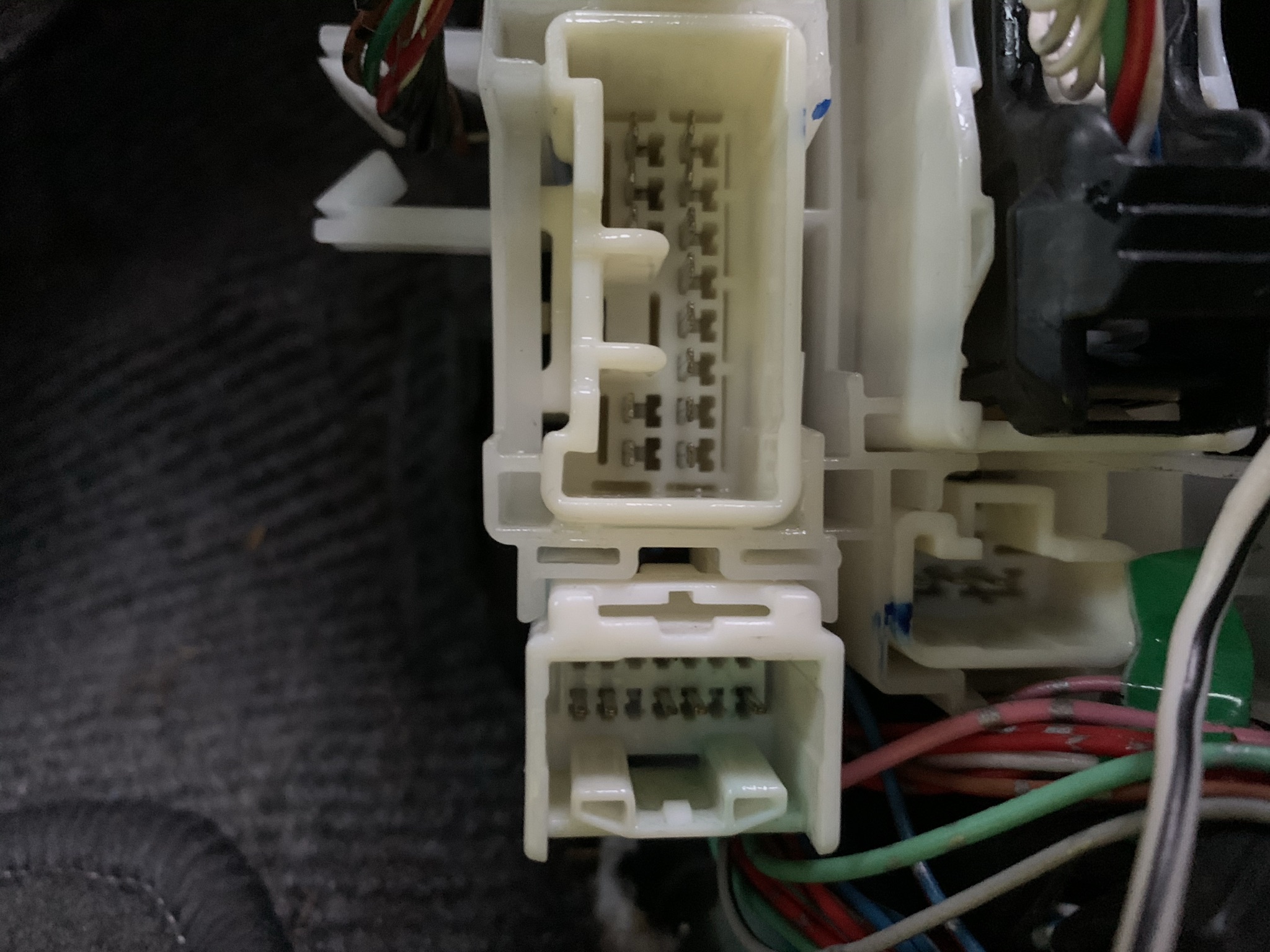

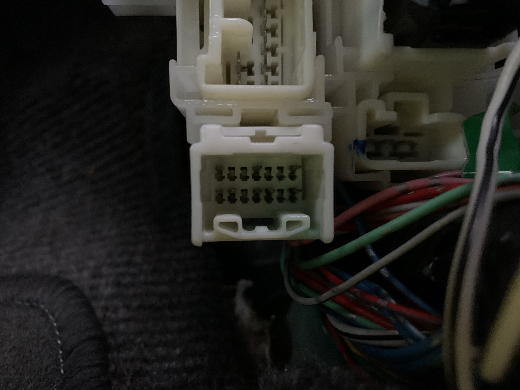

CrofterJr 0 Posted January 16 Author Share Posted January 16 the connector in question was wet - ive dried it all off and used some Wd40 contact cleaner (not the Oil stuff) (see pics) the speedo went up to 20mph for a second when starting engine but nothing afterwards - or again when switching on and off seems like its def not the speedo itself which is good 🙂 Quote Link to post Share on other sites

CrofterJr 0 Posted January 31 Author Share Posted January 31 ive fully cleaned the connector (it was wet and i dried it out with an can of air and got a toothbrush on it to clean all the blue stuff out the female connector) and test it once again and i cannot get the speedometer to work apart from this one issue - the car runs smoothly what can i try next? Thanks in advance Quote Link to post Share on other sites

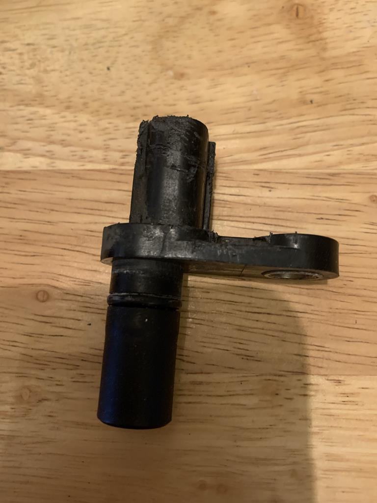

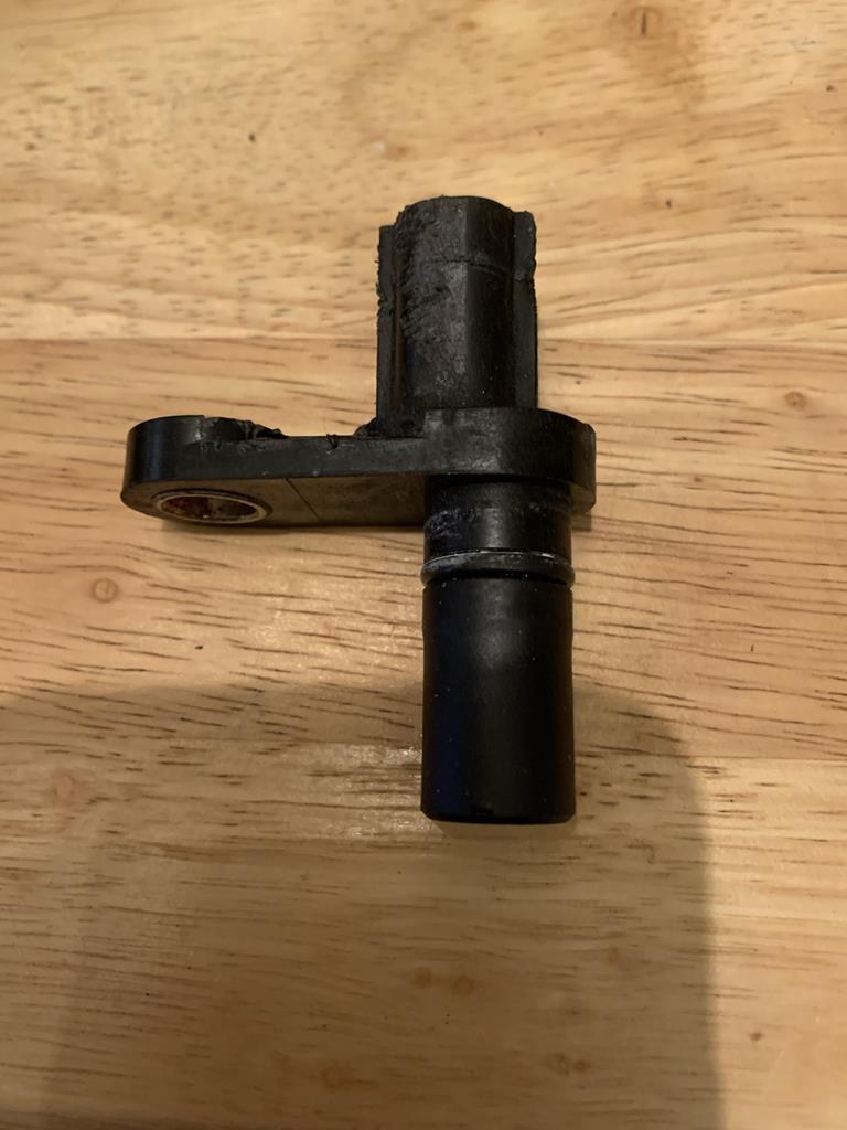

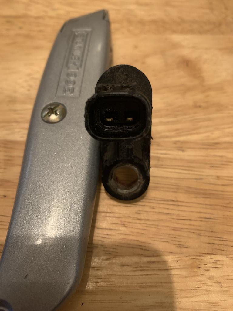

CrofterJr 0 Posted February 14 Author Share Posted February 14 Firstly thank you for all the help given so far but the saga continues..... would the attached images be the VSS? if so .... 1. how do i test its working or not? 2. does anyone have a part number for it? i cant find anything except "Toyota" written on it thank you in advance Quote Link to post Share on other sites
RAV4-D4D 5 Posted February 14 Share Posted February 14 One easy way to test if it's a sensor or the instrument cluster is to reset the average speed reading on the computer and see what value that gives when you drive. From what I can tell they both seem to go direct to the engine management system and are relatively independent of one another. If the average speed is fine then you know the issue is likely to be with the instrument cluster/connection to it. On that point, on the basis you saw it work momentarily when drying the plugs I'd focus effort there. Perhaps you need to look at the connections that were damp and see if there's any corrosion. Maybe a little rub with a small file/wet and dry will just take any surface oxidation off that could be causing an issue. Quote Link to post Share on other sites
IanML 75 Posted February 14 Share Posted February 14 2 hours ago, CrofterJr said: Firstly thank you for all the help given so far but the saga continues..... would the attached images be the VSS? if so .... 1. how do i test its working or not? 2. does anyone have a part number for it? i cant find anything except "Toyota" written on it thank you in advance I think it looks like the one shown for the 1ZZFE engine in the parts catalog Quote Link to post Share on other sites
CrofterJr 0 Posted February 20 Author Share Posted February 20 just a final update - IT WORKS AGAIN! hurrah! turns out mine was the connector that has a large bolt on it (in the same area as the picture) - took it out and noticed that there was like a blue gunk on the bottom of the connector. cleaned it all up using WD40 contact cleaner and working!! thank you for all your help and suggestions - saved me £££ going to the garage 🙂 Quote Link to post Share on other sites
