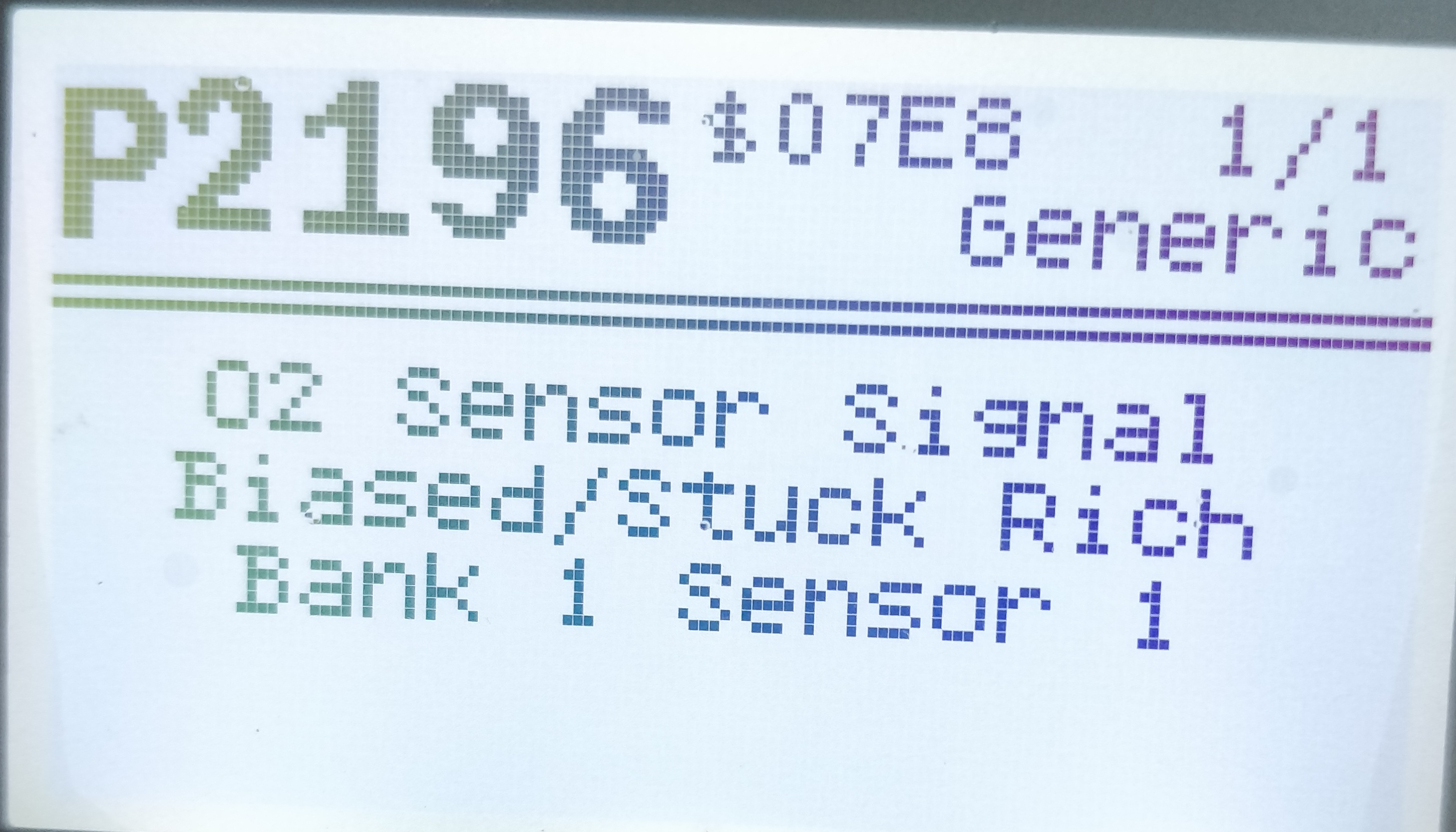

webjaved 5 Posted January 18 Author Share Posted January 18 I had the engine light on 2 days ago, it's appeared again so I've plugged in the diagnostic machine and it works! Hooray! The codes showed up, now I need to find out how to fix this problem on the car. Quote Link to post Share on other sites
oldcodger 343 Posted January 18 Share Posted January 18 Once logged an error code should stay in the ECUs memory, but if the Battery was disconnected it will be lost. Plenty of help on the web about that error code, but if buying a new sensor ,be wary of cheap ones. https://www.engine-codes.com/p2196_toyota.html Quote Link to post Share on other sites
