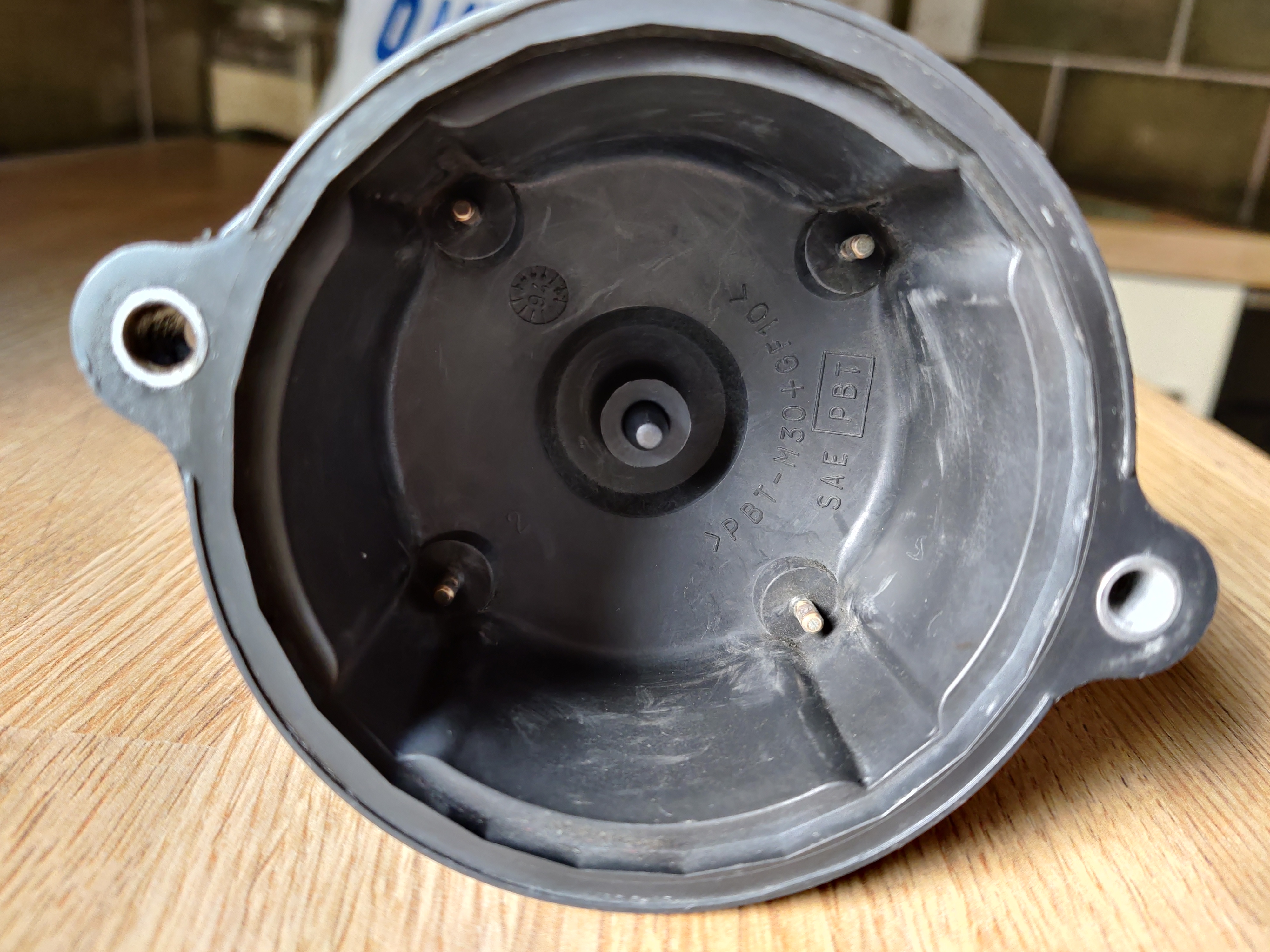

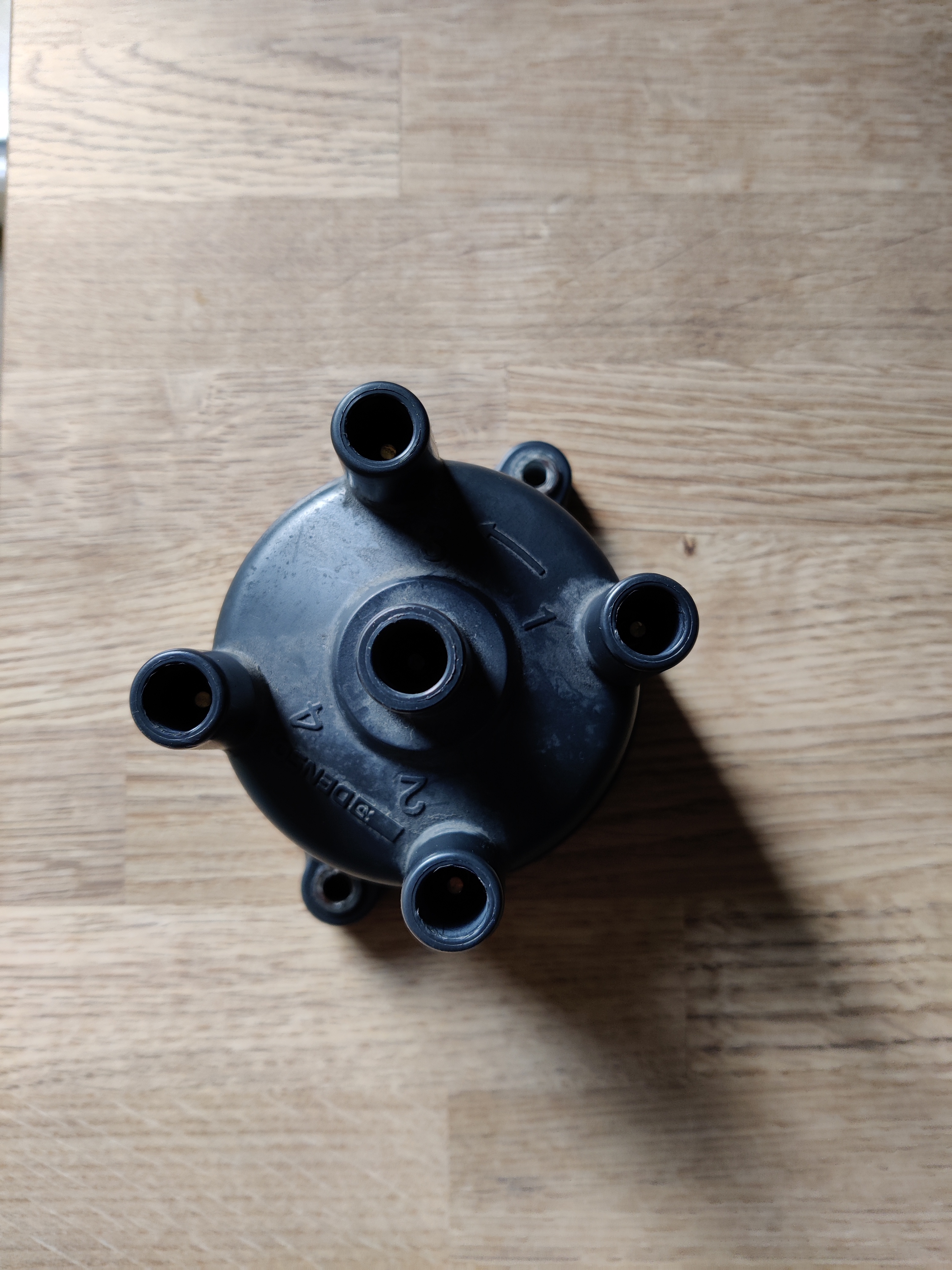

gbethell96 0 Posted February 8 Share Posted February 8 My Carina E isn't getting a spark so I'm replacing plugs, HT Leads, rotor arm and distributor cap, only problem is I cannot find a distributor cap anywhere. Replacement part is a Blue Print ADT314243 but is no longer manufactured or available anywhere. Don't suppose anybody has any ideas on a suitable replacement? It's a 1994 1.6 with the 4A-FE engine, I've attached a couple of photos of the old cap for reference. Thanks in advance Quote Link to post Share on other sites
flash22 656 Posted February 9 Share Posted February 9 Just looking at the cross-reference - Toyota Part No. 19101-02030 or 19101-02H00 It looks like a lean burn cap If you PM me your vin i can conform the correct one edit. i take you have checked the coil Quote Link to post Share on other sites
