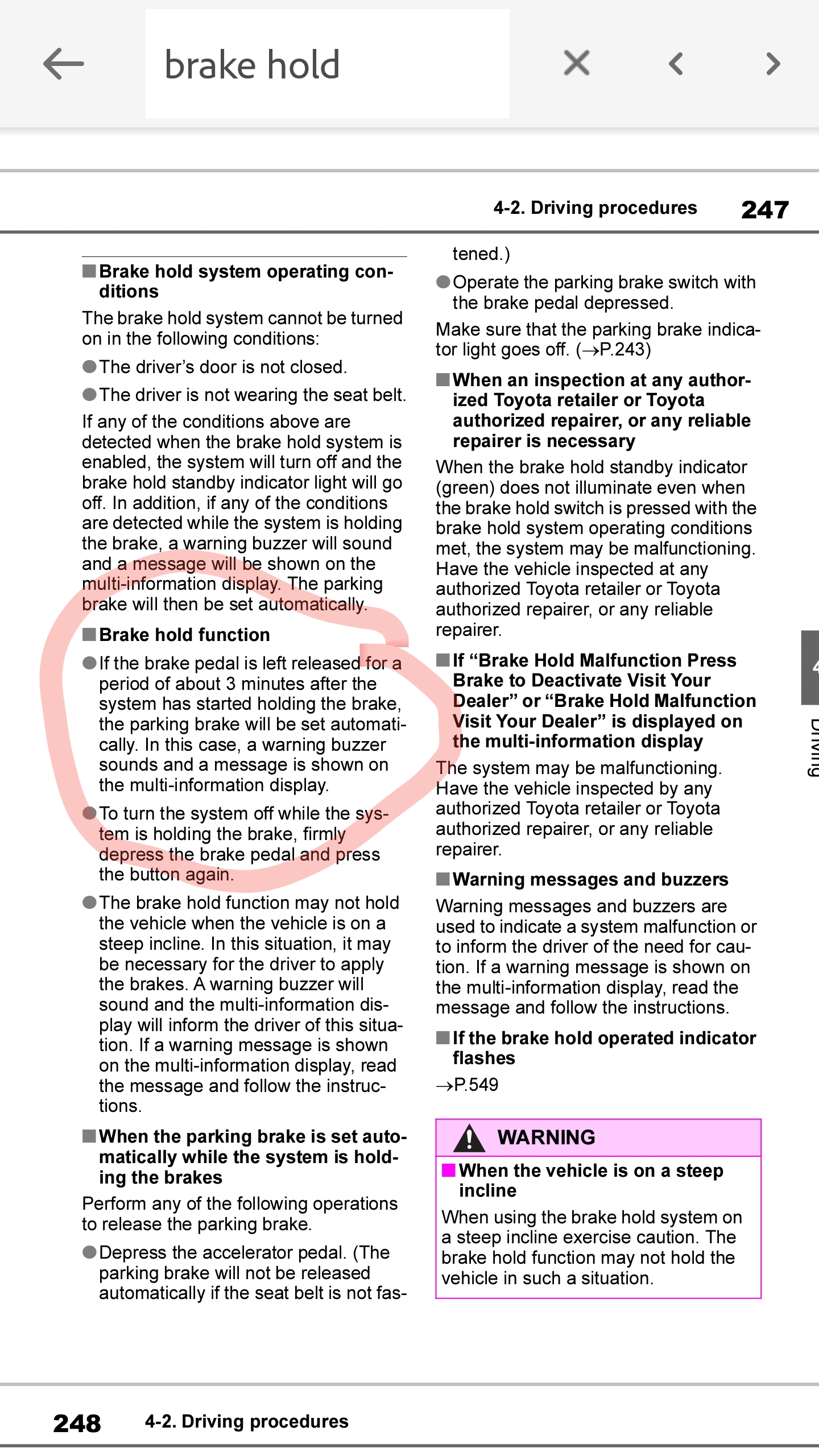

Jack Spratt 8 Posted February 14 Share Posted February 14 4 hours ago, RabButler said: Don't understand that. In my 69 reg 1.8 the electronic handbrake is automatically applied when the 'hold' times out. It should never run backwards if it is in drive anyway. Hold is deactivated if you undo your seatbelt and could drive off if you got out of the car, hence the son et Lumiere show. Absolutely correct - See extract from owners manual below. I've been using Brake Hokd for a year now and no issues. Quote Link to post Share on other sites
