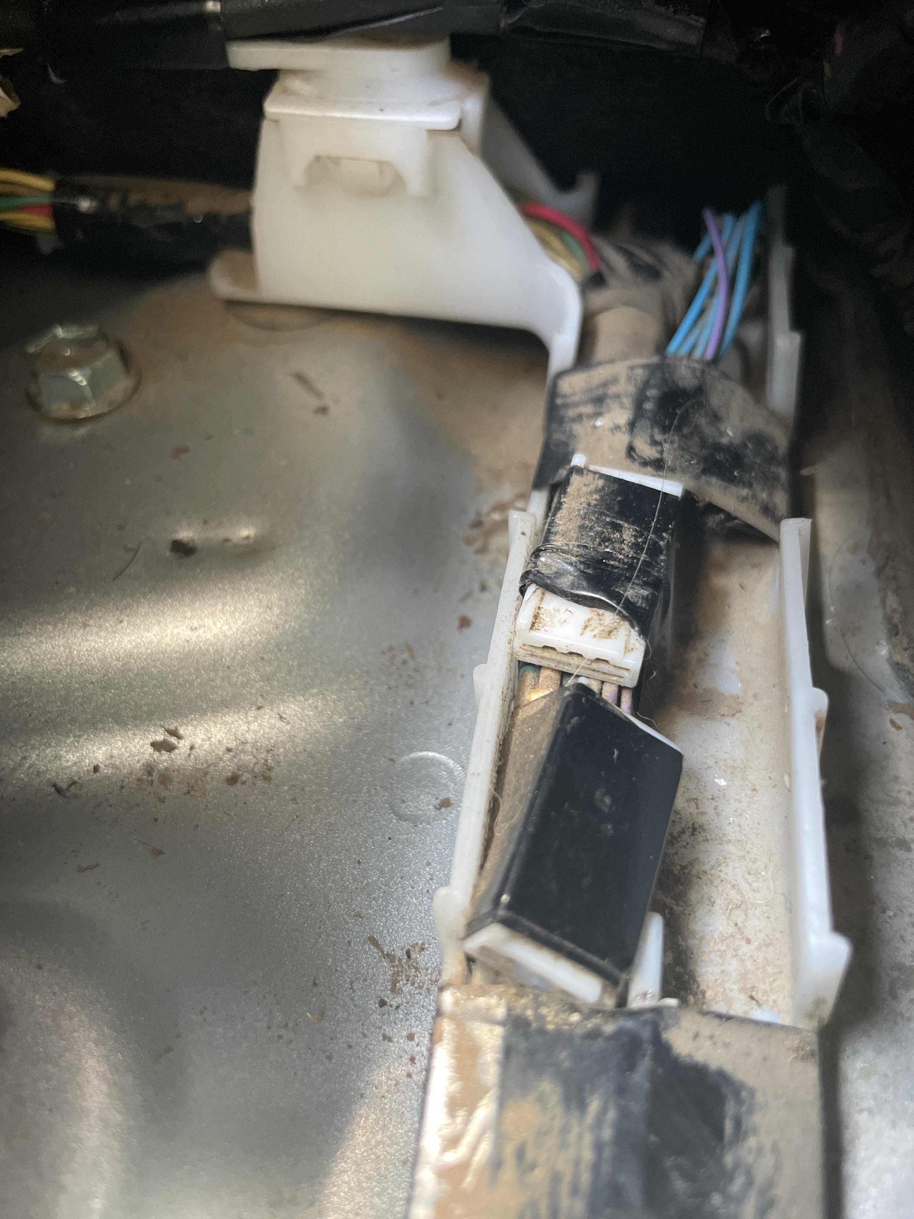

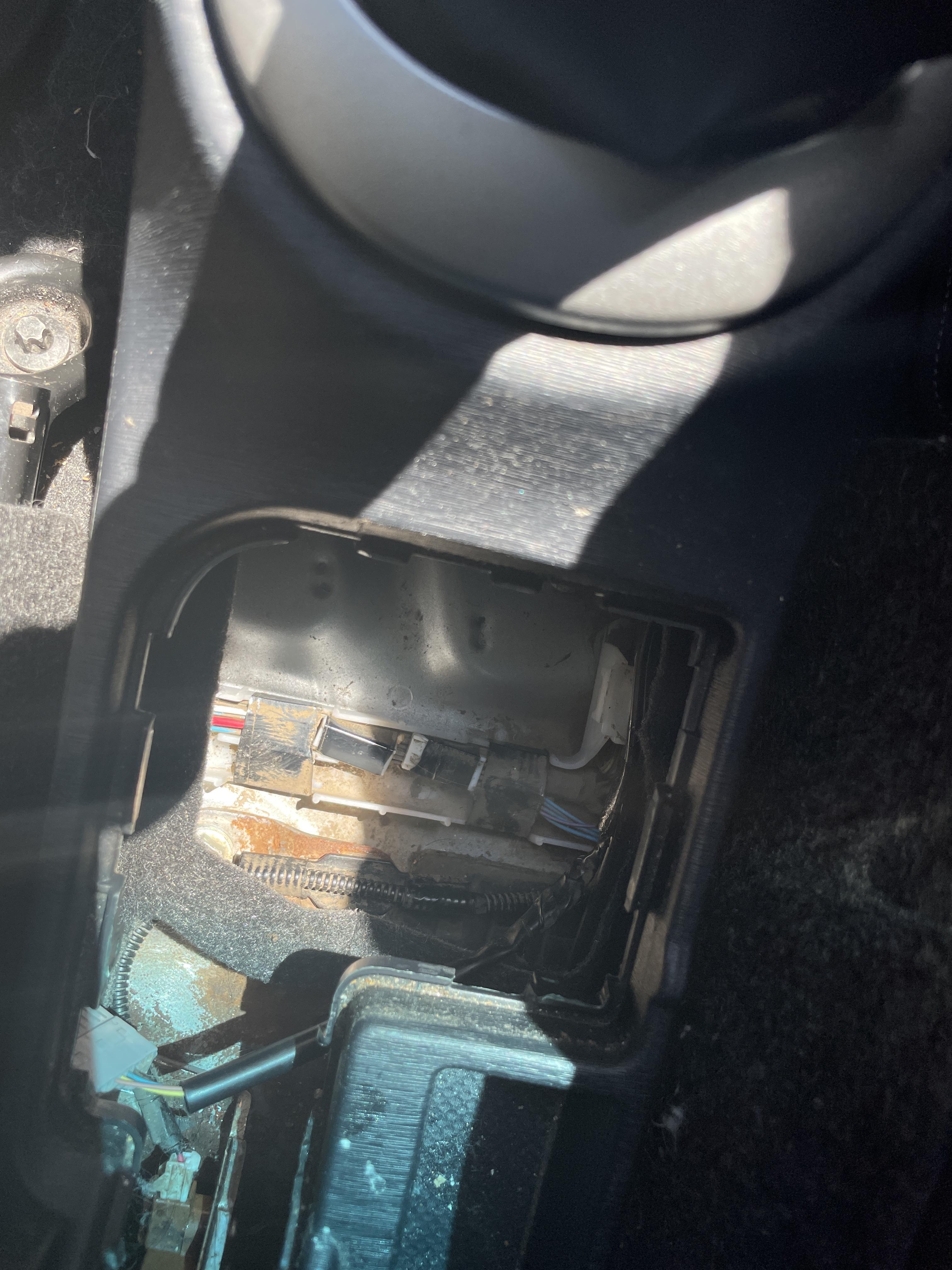

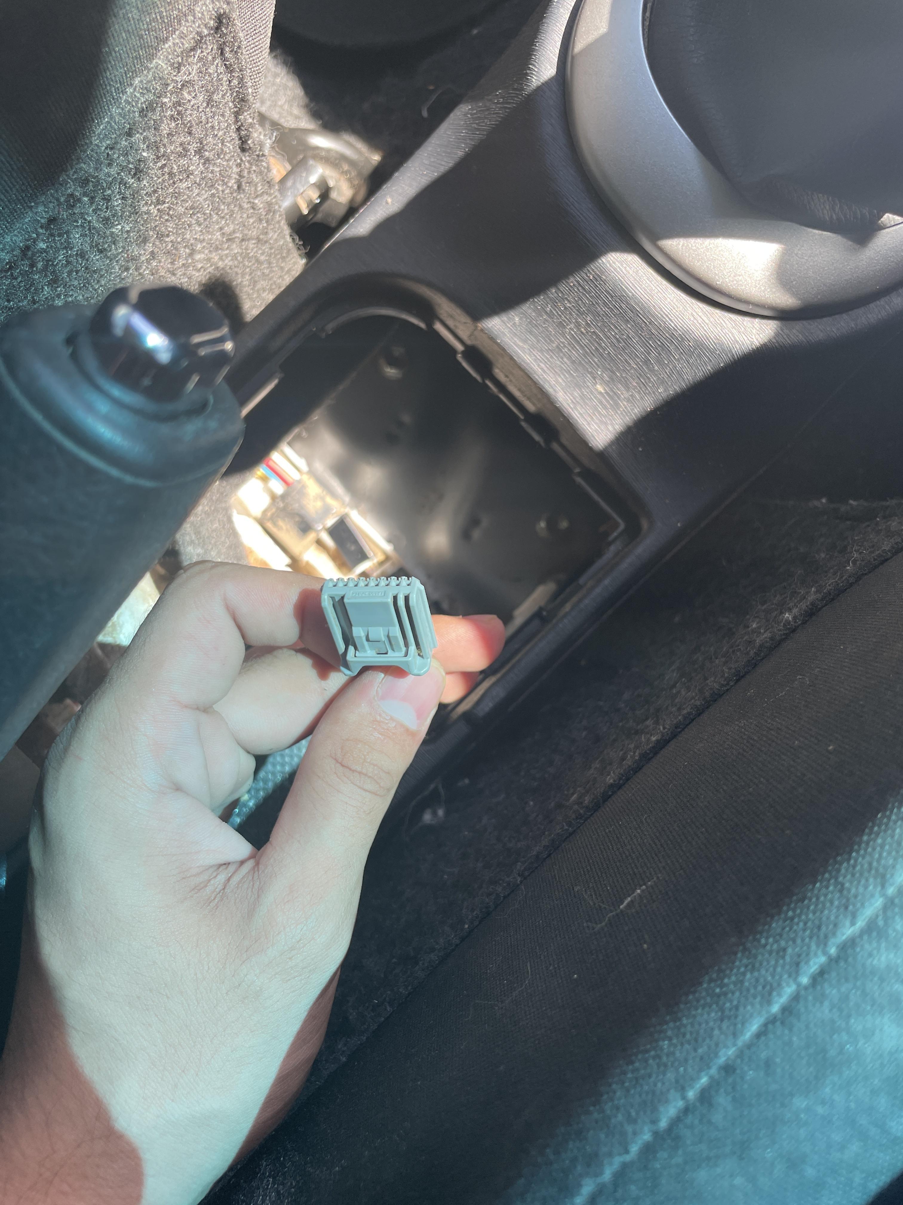

does anyone know what these plugs which are under the centre console are for? there’s two taped up to the wiring harness and one that’s just hanging in there, see the pics attached.

There are 4 switches depends on the spec of the car to what's fitted
Top left - Pattern switch Marked Es (MMT only) or Door lock switch
Bottom Left - Heated seat switch
Top Right - 3.5mm AUX port
Bottom Right - Eco run Switch (aka stop start) or Power Heat (secondary heater for cold countries)
It's common to see unused plugs under the dash, as Flash says, for heated seats, many models don't have heated seats. It saves making dozens of different looms for different specs
