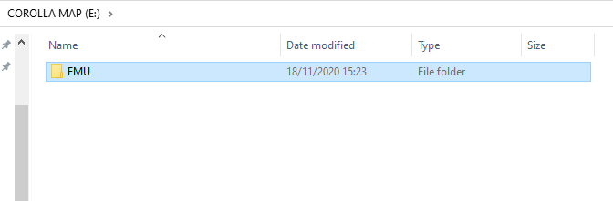

Timmon 308 Posted February 20 Share Posted February 20 This is how my memory stick looked when I updated, FMU folder with 4 files inside. If car is not recognising, try downloading again, reformat stick, and load this folder once more from your fresh download. Quote Link to post Share on other sites

Tonymac1 2 Posted February 20 Author Share Posted February 20 48 minutes ago, Timmon said: This is how my memory stick looked when I updated, FMU folder with 4 files inside. If car is not recognising, try downloading again, reformat stick, and load this folder once more from your fresh download. That’s exactly what mine looked like 1 Quote Link to post Share on other sites
