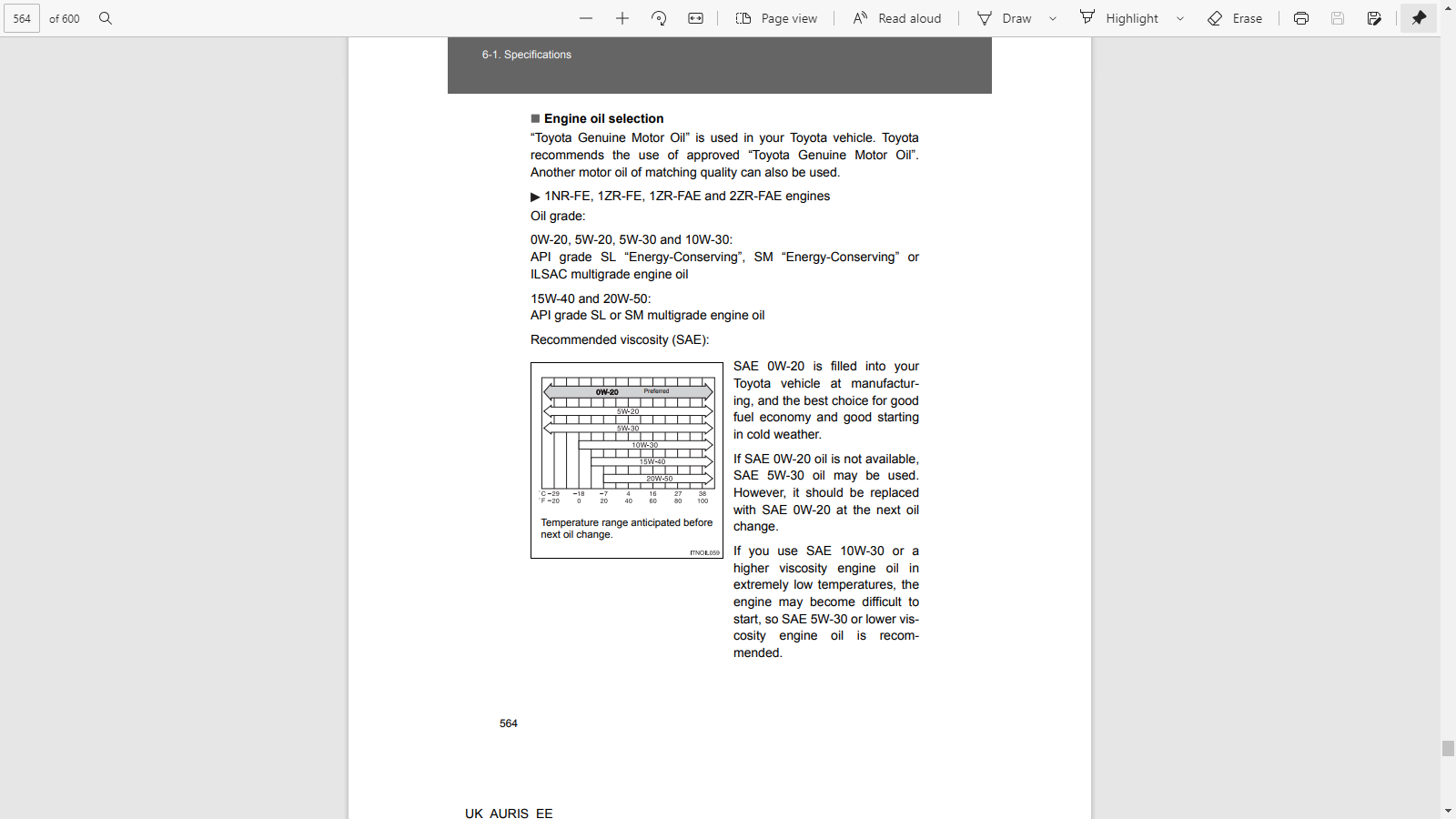

Konrad C 974 Posted March 6 Share Posted March 6 The 'preferred' Oil grade is 0w-20. I suspect that a lot of cars are using 5w-30 because it is readily available and cheaper. What a coincidence. I was only just looking at the owners manual for the Auris, so here is confirmation - I always my Avensis Valvematic Oil changes myself and always use 0w-20 Petronas 7000 fully synthetic. I have the Oil filter tool to change the cartridge type filter. 1 Quote Link to post Share on other sites
