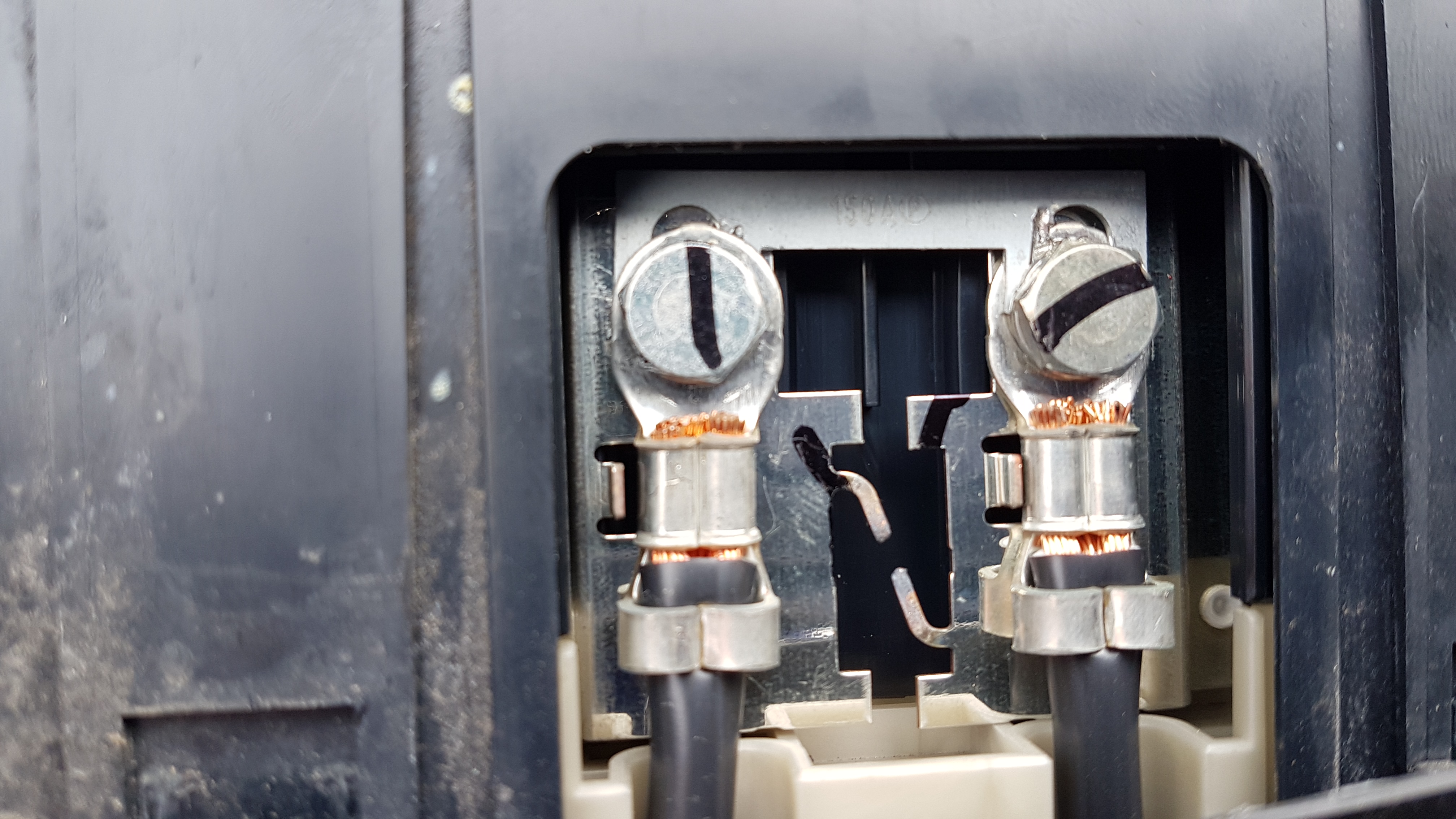

It sounds like you have blown the hi amperage fusible link on the fuse box Toyota say they are not replaceable, but there are other ways to replace it
the fusible link is located at the rear of the fuse box behind a small cover

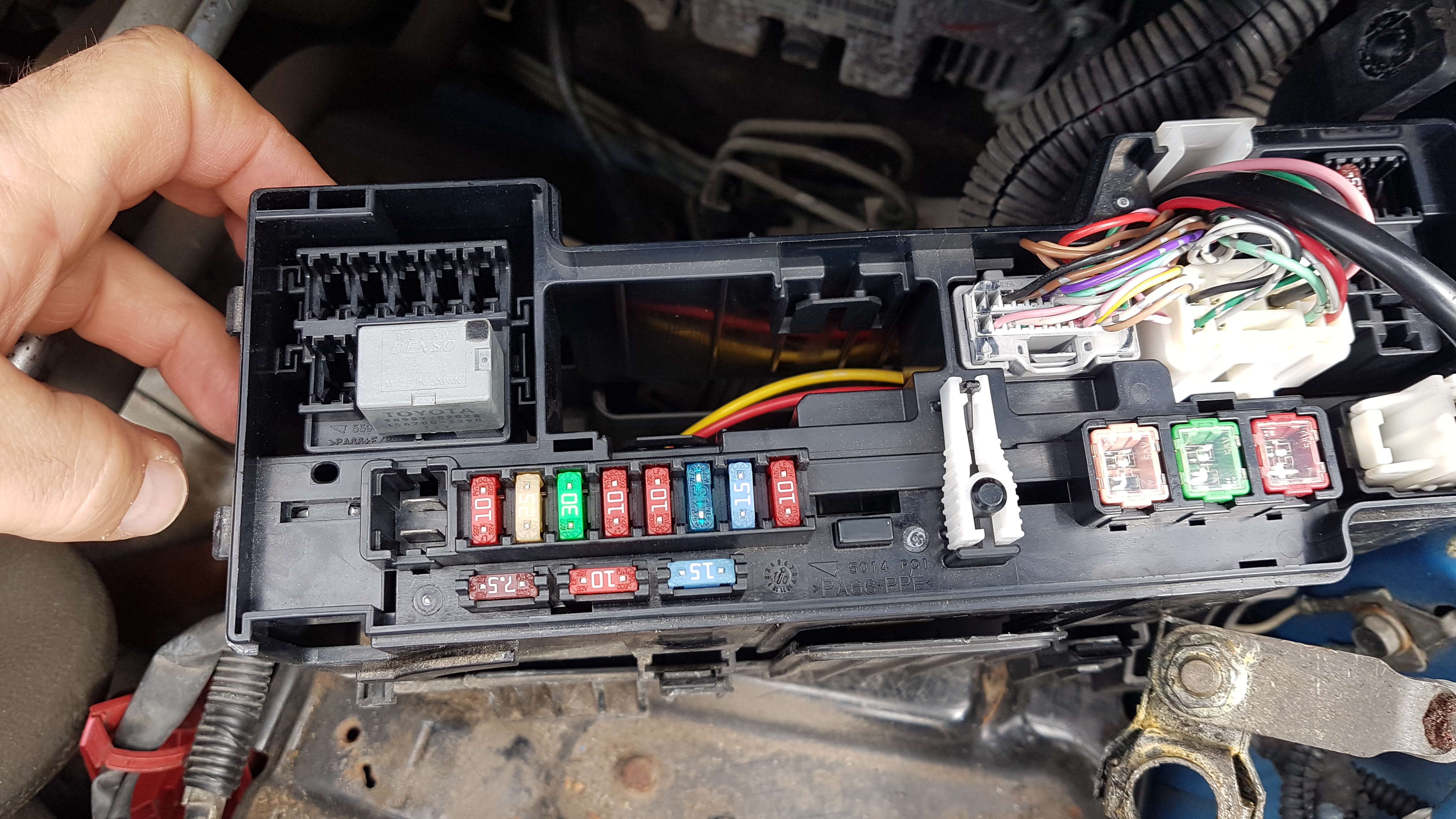

Thanks for the suggestions so far. I have checked the main fuse under the fuse box and this is where things are strange.
As you can see from the first photo, the fuse has blown previously and someone has repaired it, altgough with a 150A fuse. I have only had the car since October 2020 and so this was done before then but it has been running fine. Obviously it's something else.
I check the first stretch of the Battery cables and they are ok but I can't check the whole length without either undoing a lot of stuff to get access or by jacking it up to check the cable to the starter motor. However if it we only this cable, surely there would be power to some of the circuits as it is a new Battery that I know has a good charge.
As you can see from the second photo it looks like some of the fuses are missing.
Any ideas please?

It depends on the spec of the car as to what is in the fuse box

are you getting power to that large fuse ? Have you been supplied the correct Battery ?
It may be the picture but the right-hand side of that fuse look melted to me, where do the 2 cables go to ? Into the fuse box ?

Just had another look at the diagrams Toyota supplies a 125A fuse if that one blows
90982-08297

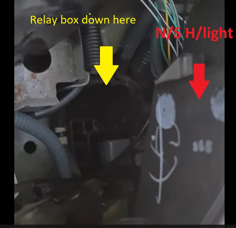

Also be aware there are other high Amp fuses that live in the relay box under the passenger headlight (if fitted)
